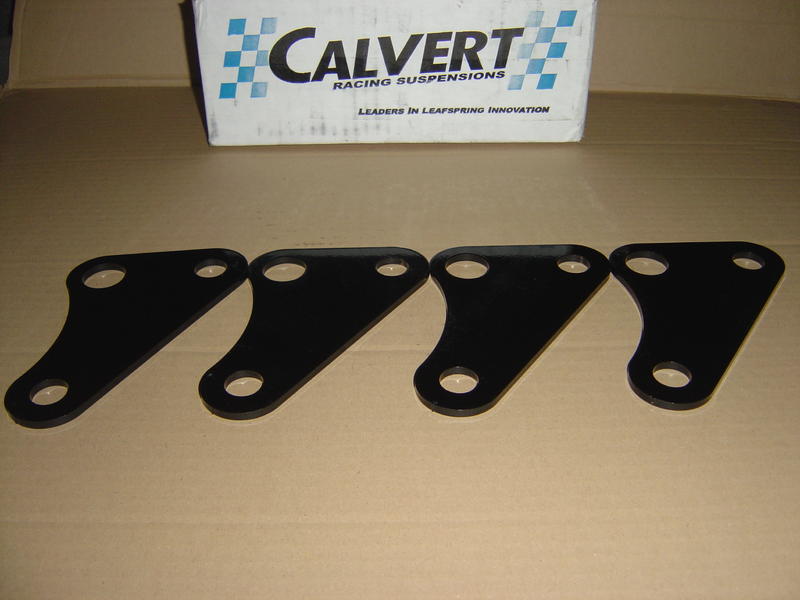

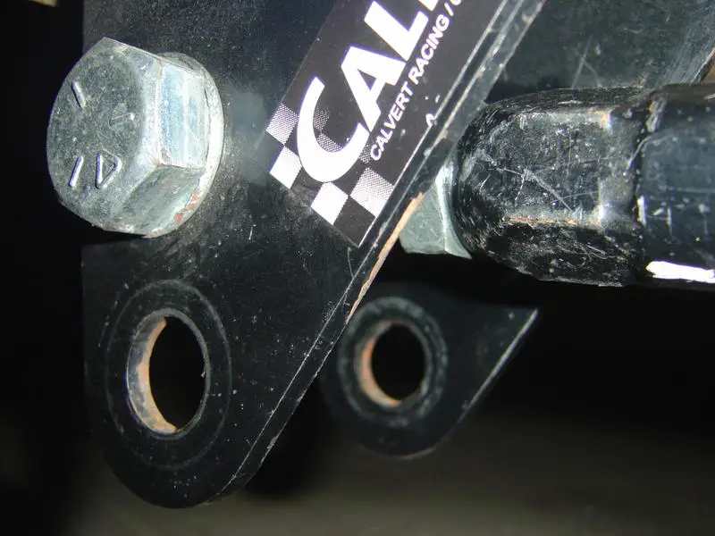

Then I reread Ahodges thread when I find out what Cal Tracs were, very helpful. I sent Calvert Racing some lower leaf spring mounts to have the brackets welded on and ordered the kit. I also installed rancho adjustable shocks. I run the shocks at the hardest position, I run the cal tracs at 1 1/2 turns of preload at the track. Instead of the rear going up into the wheelwell and the front lifting, now I have the rear actually lifting, pushing the tires down towards the track at the same time. To acheive this I had to move the bars towards the top holes in the levers. see first picture. This makes it hard to see what you are doing when adjusting the Cal Tracs. You don't want to drive on the street with 1 1/2 preload, it rides very harsh, so you have to adjust them at the track. Calvert racing has come up with different levers with only one hole, making things easier to see when adjusting. They are supposed to be for low profile veihicles, but will make it easier for me to adjust so I got a set.

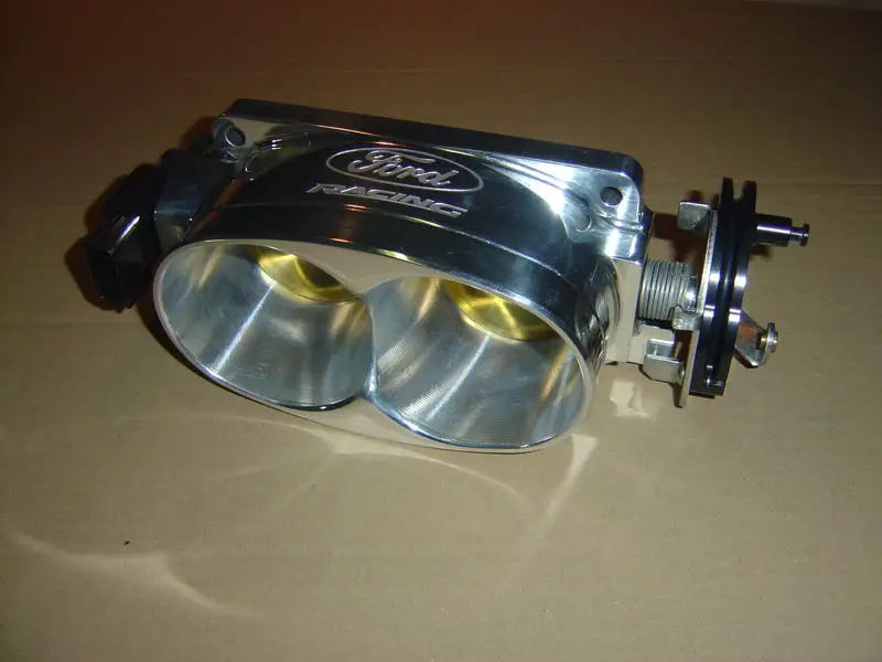

New Throttle body
I got a new thottle body, I plan to use a Nitrous plate made for the GT500. It is made by Nitrous express. The throttle body is rather large, I had to get a 5.5 to 4.5 inch reducer from HPS to attach it to the 4 inch inside diameter sewer pipe I am using for an intake pipe. Dont know when I am going to install it. Think I am doing the Cal Trac Levers first.

The throttle body is a Ford Racing Cobrajet Mechanical Throtle body. It is only the dual 63mm one. I bought it because it was cheap. I paid about 179.00 for it. Up till now they were listing for 500-600 dollars but must have went clearance. I mean who really wants dual 63mm bores when you can have dual 67's or a single blade oval plate one rated at over 1800 cfm's. lol.
I currently have a single blade throttle body for a Ford Lightning made by LFP. I think it was rated at 1800 cfm. Probably overkill. If this dual 63mm one slows me down in may not make a difference since I am adding Nitrous. I will be running the smallest shot possible to see what happens and go from there. Using this throttle body allows mwe to use the Nitrous Express GT500 plate. I still have to bolt it up and make a bracket for the cable. A lot of my students work for American Muscle, they even bring some of their cars over when we have events. Cool guys over there.

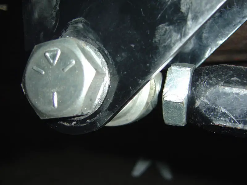

Cal Trac Levers
Here is what the new levers look like, first shot is new lever on top of old lever. The second picture is what it looks like installed now, you can see and get to the lock nut much better.

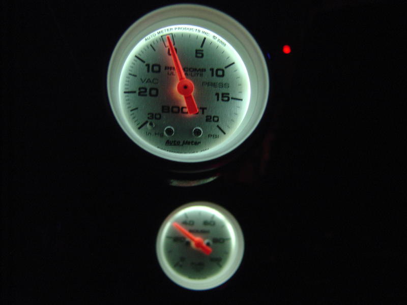

Years ago I found replacement LED's for 194 bulb sockets at PepBoys and even installed a few in my Autometer gauges. They were expensive and not that much noticeably different. Now that so much time has passed LED's got better in quality and cheaper in price. So I had a bulb burn out in my 4 door Explorer's instrument cluster so I ordered a 20 pack of 9 LED 194 replacements. I played around with them in a spare cluster I had in the garage when it was snowing out and to cold to do anything else. Long story short I put them in my 4 door and My supercharged Explorer. I like how the needles look whiter, it's a cleaner look. They are plenty bright, they dim, and we will see how long they last.
The Battery Gauge needle is being blocked by the shifter handle in the picture, it really is there.

to some they may think its kinda "ricer" looking, but doing all the LED's in evil if you ask me was one of the more better mods that i have done. its funny because i did this years ago and to me it doesnt seem bright now, but when i have to get into someone elses car that are using regular bulbs everything seems so dark and not well lit. it is a big improvement over regular 194 style bulbs
Looks great! I switched the 194 bulbs to LED a couple years ago too. Now I'm taking Tim's lead and doing the rest of them.

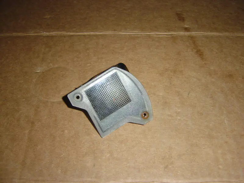

Puddle Lights

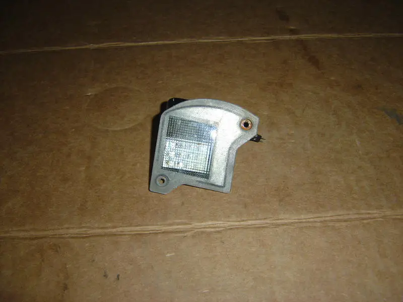

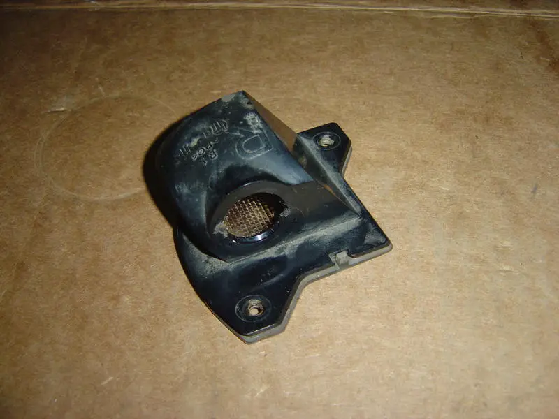

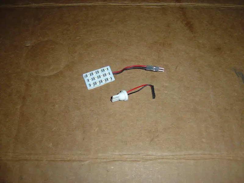

I wanted to do something with my puddle lights. I found small LED boards that were about 1.5 x .75 inches. I found that if I grinded a small notch in the hole in the lens that I could slip the board right in. Two boards seemed to fit just right. I was able to piggy back the connectors, cool no more wiring needed. The boards came with adaptors too. Now the cheesy part, I used foam to hold them in place. lol. I will change that at a latter date if needed.
The normal connector seals up the hole so no water intrusion.
