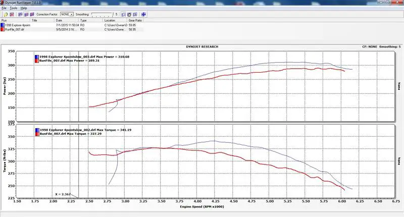

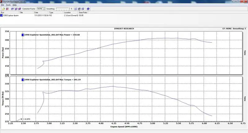

New Dyno Sheet
Working doubles, but did get time to run my truck.
Here is the new dyno sheet and the bottom one is a comparison between the last dyno sheet and this new one.
Keep in mind the last dyno sheet was when I did not have water methanol injection or the exhaust.
Thats awesome
Nice increase in torque under the curve. You are still making very good power at the end of the pull (6200 rpm?). I would be looking at increasing my shift rpm if HP doesn't fall off much faster beyond 6200 rpm. Assuming the internals will take higher RPM limits. I didn't really expect that out of such mild cams and stock heads.
nternals
Stock internals probably wont hold up. I cant believe they lasted this long.
I may try spraying the W/M sooner or closer to 3,000 rpm and increase the timing there, that would bring the torque up higher from 3,000 to 4,000 and get me better 60 ft times if nothing breaks.
Yes, it looks great.
Try to keep it reasonable at the shift points, avoiding excess shock there(higher power at the shift). The trans is still the weakest link.

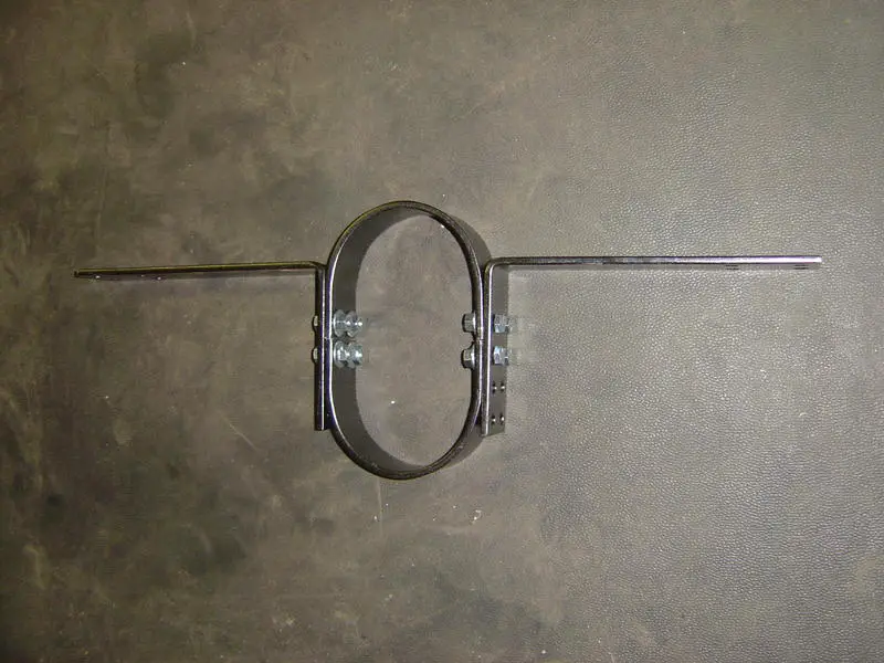

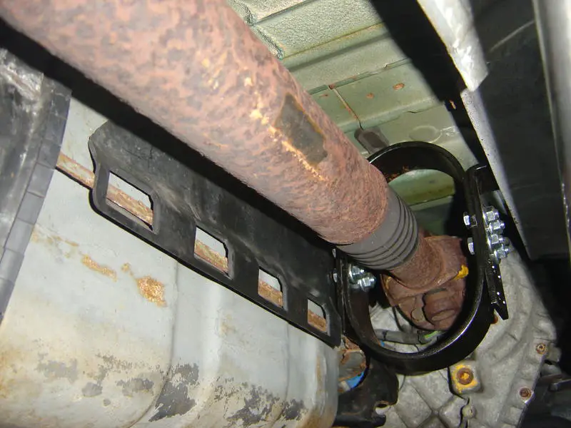

Driveshaft Loop on a second gen Explorer
I obtained a universal driveshaft loop from Summit Racing. It was not an easy install. Had to remove the fuel tank on the drivers side and had to drill some rivets out on the passenger side to remove a heat shield.
I used a hood prop to hold the bolts in place while I started the nuts from the top. After reinstalling the fuel tank I was very pleased with the clearance between the bolt heads and the fuel tank.

Very nice
nice. im going to have to figure out a way to do this still. there isnt much room there using a 4406 however :(
I guess your pretty much to the point where its a huge safety factor to do that.
Extremely nice install.
As always, you do amazing work.

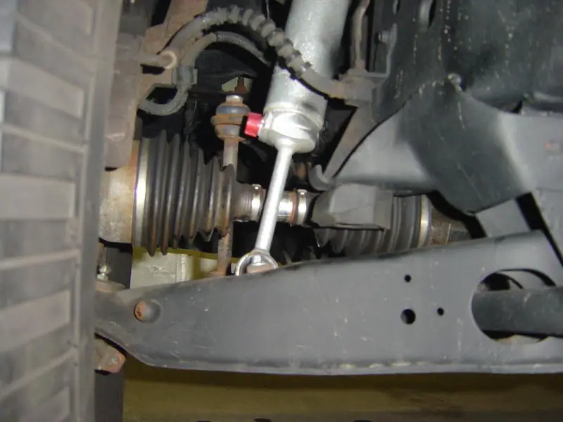

Lowered front end
I lowered the front end last night about 1.5 inches. The front always seemed higher than the back to me, except when I had 1 1/2 turns of preload on the traction bars.
It still looks to high, I want to lower it more and eventually lower the rear a little too. I am concerned about blocks and the way I launch the truck at the track, I don't know if they are safe.
I cut the bump stops with a sawzall in a vice and reinstalled them. They have a metal backing that protrudes down one side or I may have cut it more.
After backing the torsion bar adjustment bolt out about 6 turns the suspension was 1.5 inches lower. The camber moved about a quarter of a degree. It had been at 0 and went to -.25
EDIT: after driving it the drop turned out to be 2 inches and camber is sitting at almost -1.25(time for camber bolts)
All you lowered Explorer guys, how far out do you have the adjustment screw and is there anything else that can get the truck lower? I thought I saw something about flipped torsion keys but thought that was for raising the trucks.
Also, besides removing the bump stops is there any other way to have thinner ones? Maybe off another year or model vehicle?
For the front you need camber kits, basically a $30 kit of oblong special washers to provide more camber adjustment. Without them they really cannot get a decent alignment given any real height change.
The back can't go down much or the body hits the bump stops a whole lot. Explorer Express made the best bump stops, but everything they had was super high. Buying the whole kit for about $700 ten years ago was the best deal for the money. Those rear blocks EE made were 1.375", and very well shaped(not just square cut chunks like all other blocks). But those are very high too to buy separately.
BTW, I suggest measuring your height at the front based on the suspension, and not the body. The suspension works differently at differing LCA angles, so if your LCA mounting bolts are not at the same height, then the vehicle doesn't act quite symmetric, left turns may be different than rights etc. I set my front heights by measuring from the ground to the lower mounting bolts, the big ones near the end of the torsion bars.
I think I got my Mountaineer in the 8.5" range, while my Explorer is much higher, maybe 10" or more. The alignment shop could do as much with my Explorer, one spindle is not made as well(as if it was bent and the camber was affected). So I let them raise it enough to get a good alignment on it, and that was with the camber washers. I figured I'd later on replace the one spindle and try to bring it down a little more.
Those are 01+ 4WD spindles I bought for the bigger rotors, these came from a 2003 Sport Trac. Any 01+ Sport or Sport Trac will get you the 1" bigger rotor, using your old caliper/pads/hoses. It has to be a matching 2WD or 4WD spindle though.
Lower
I do have spindles from a newer explorer allowing me to use the 12 inch rotors also.
I will be getting the camber kits, after road testing it the camber showed to be almost -1.25.
The drop turned out to be about 2 inches on both sides after driving it. It is so more forgiving in the front when going over bumps too.
