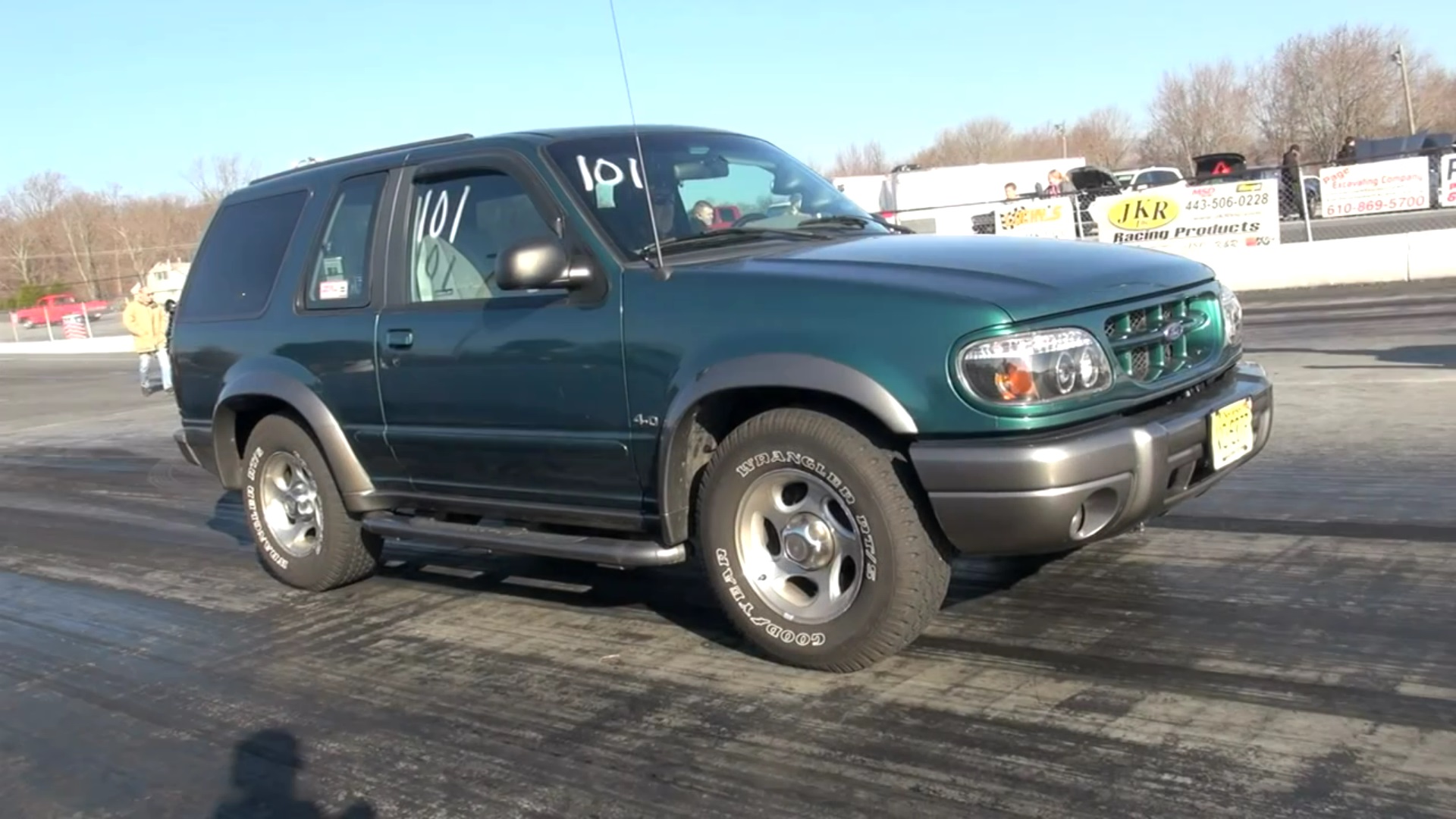

From last year.....
So last Friday I squeezed some time in at the track. I couldn't stay long but got three runs in.
It was around 80 degrees F outside and there had been some storm clouds threatening but never rained.
I ran the truck with a 3.3 inch pulley on it to slow the supercharger down and lower boost while increasing spark advance.
Went from 3.2 to 3.3 inch pulley and max boost was around 17.5 down from being pinned at 20 last year.
First run 13.78. Then added 2 degrees and ran 13.664, then added 2 degrees and ran 13.499.
This was all within 33 minutes.
I noticed during the last run that there was some detonation detected and when I looked at the datalog the PCM had pulled .5 of a degree of timing.
So with the 3.3 inch pulley I now have a tune with 2 degrees timing added an no detonation.
With the 3.2 inch there is 2 degrees less timing advance but more boost.
My next experiment is to run both pulleys with their specific tunes back to back and see how it responds.
I wish I had time to put the 3.2 back on and run it again but that will have to wait until next time I get there.
At least I have the tunes ready for quick back to back runs.

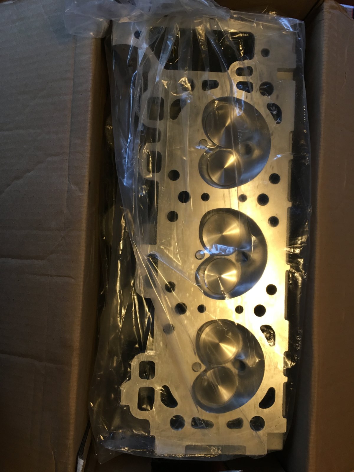

Stage 3 Supersix motorsports cylinder heads, and reground cams are coming soon!
I have the heads and am just waiting for the camshafts.
And of course the time to put them in.
I hope to have them done by Black Friday for Atco Raceways all day racing event.
Whats the details and specs on all that??
Excellent, I hope those are a big gain in airflow.
