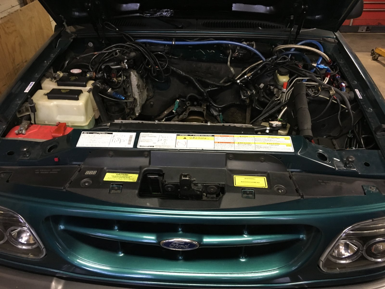

After spending many weeks cleaning out my garage, I finally got to pulling the motor out in preparation for the new heads and cams.
I have some time off staring next weekend so I hope to get a lot done then.
I cant wait to see the difference in boost levels and the increase in power..its gonna be crazy i bet!!
I'm sure you will do a better job of the motor work than I did. Every time I see a motor in the air like that I cringe now.
I'm looking forward to the motor going back in, making great power, and staying in.
Can't wait to see the results, i still wanna get you down here with that thing
I'm surprised you were able to pull the engine without removing the hood.
hey, wait....yea, how the hell did you do that??
hate to say it don, but every time i see a update on your thread with your name on it, and havent talked to you yet, i get the same thing!
i think "oh no, what did the poor guy do now, and how can i help him" lol
so should we all place bets on what his new et, and mph will be when he lays a beating on a LS pile of junk?
and for the love of god, PLEASE paint the block!!!!!!
haha I was looking at the block and saying, I should paint that. lol.
I don't know though, It took me three days just to get the engine out and I really want to have it done by Atco Raceways Black Friday event.
To be fair Thursday wasn't a full day, got home from work and started at it around 3:30pm and worked until 6-7:00pm. Most of that was getting it up on jack stands.
I was hoping you guys could recommend a brand of spray paint for the block and also some spray aluminum cleaner to clean the aluminum brackets.
Would aluminum wheel cleaner work?
Getting the engine out with the hood on is not easy, there is a lot of pushing, prying, praying, and grunting.
I already told myself I was going to take the hood off before installation.
The radiator is still in there too, I live dangerously. haha
