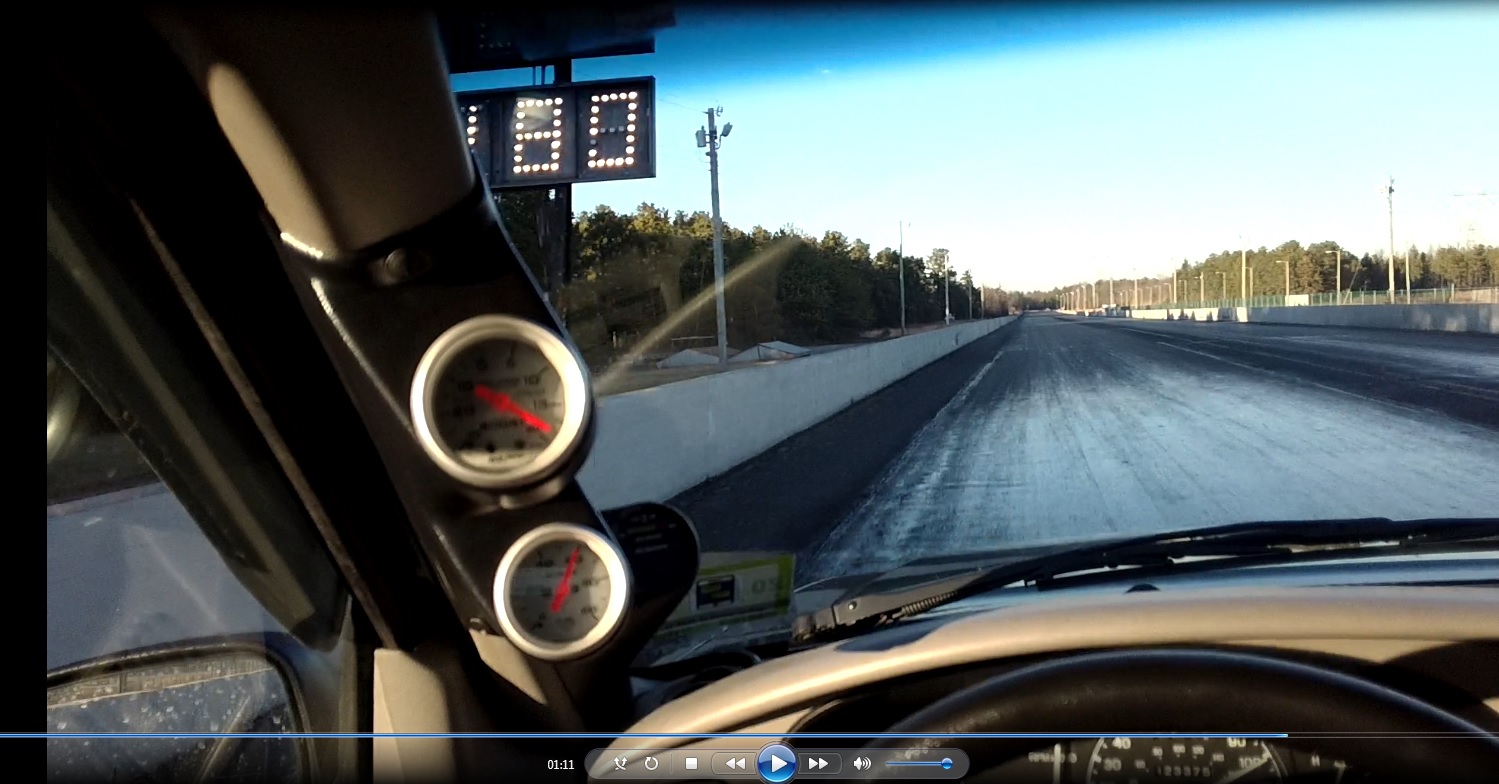

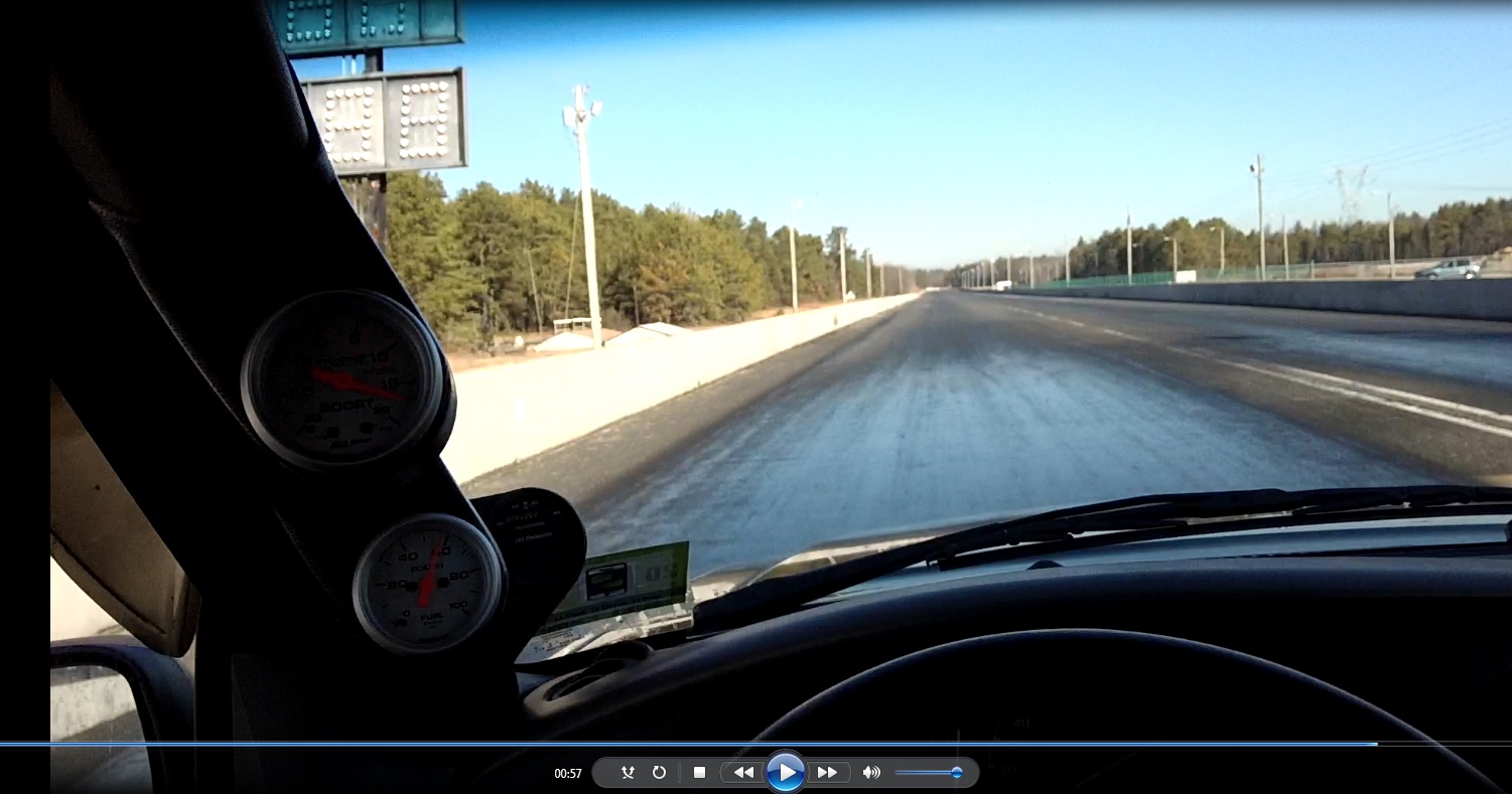

Here are screen shots from the videos, near the end of the 1/4 mile.
Keep in mind rpm effects this a little too.
Pics..
1 = 3.3 pulley
2 = 3.2 pulley
3 = 3.1 pulley
Looks like 17,18, and 19 psi

Since the 3.2 and 3.1 pulleys raised boost but did not give me quicker 1/4 mile times, I think I finally realized my sweet spot with boost.
Any more and it just heats up the air.
I could never find that point before.
The boost dropped from pinning a little past 20, to around 16-17 with the heads and cams. And my maf counts went a little higher.
So the heads and cams are doing something for flow through the engine. I now need to work on getting intake air temps as low as possible and move timing up.
