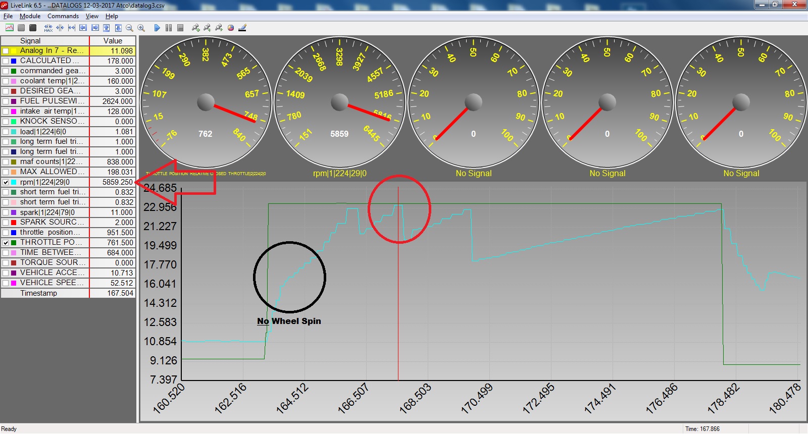

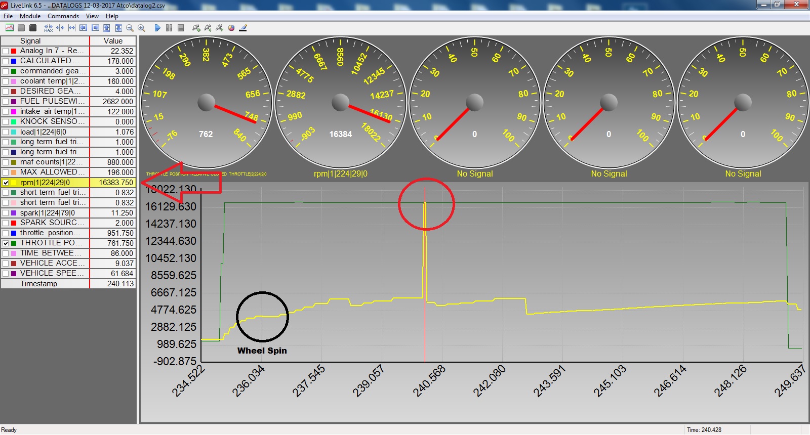

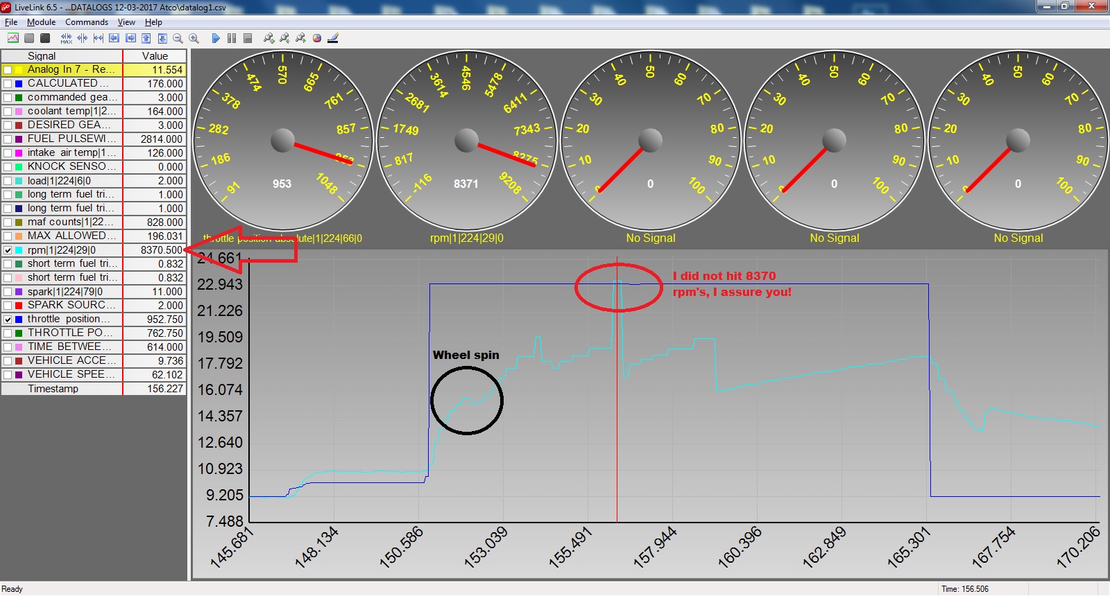

Went to Atco Dragway today, only got three runs in.
At least two cars bounced off the walls, one did a 360.
Then there were at least two cars that dirtied up the track with fluids.
Spent so much time in line waiting for track clean up I called it quits at 2:00pm.
Almost forgot it was Sunday and I have to work tomorrow, the morning shift too which means get up at 3:30am.
Anyway I pulled some timing out while I was screwing around with some transmission settings.
First two runs I had wheel spin which caused the shifts to happen later and some of the strange data in the log.
See the first two pictures below. Look at the bogus RPM readings.
The third run I changed a transmission fill time setting for the 2-3 shift.
Unfortunately there was no wheel spin off the line so I don't know if I really fixed it or not.
I was going to run the same tune again but never got to.
Might have one or two more weekends to go testing if the tracks open and the weather holds up.

Not hitting the factory limits of the PCM but that is a good question.

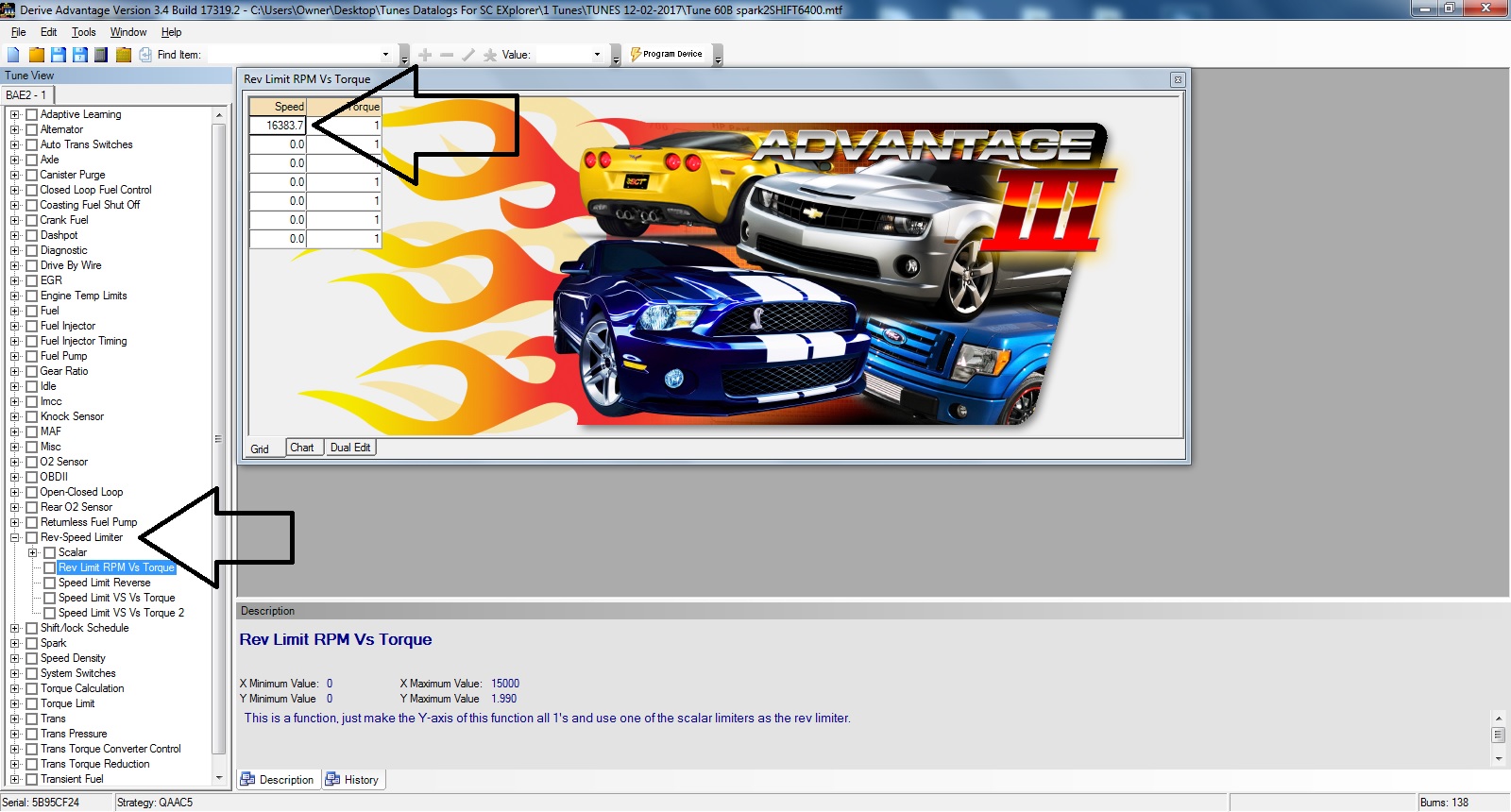

There is definitely something in the tune doing it. Check out this screenshot picture, look at the rpm at the top of the table and compare it to the middle data logger picture above.
This is what clued me in to it being something the PCM is doing on purpose.
The problem is I have that limiter shut off by having all 1's in the right column.

Also while I am thinking about it the front wheels were the ones breaking loose at Atco, I knew right away because the front of the truck went to the right a little on the launch. I had to steer a little to the left.
The track was cold and slippery that day and I may have misadjusted my traction bars by a half turn on one side too.
So in that middle picture I think the PCM is pissed because the shift did not occur yet and it was set to 50 MPH in the shift schedule.
The MPH is reading 61-62 mph in both screenshots that have that "fake" rpm reading in them.
That is 10 mph past where it should have completed the shift by(50mph).
I am assuming that the shift schedule numbers are when the shift has to happen by, if anyone has any other idea's on that let me know.
When I look at desired gear and commanded gear they are nowhere near what is in my shift schedule but I thought I used to see the transmission shift to the next gear by the time it hit what was in the shift schedule way back when before it got this fast.
No brown wire mod either, it causes high speed shearing of the clutch in the transfercase if you do high speed burnouts(with rear wheels only).
Here is the run for that middle data log screen shot.
Check out the pull to the right off the line.
It felt rough between the 2-3 shift.
