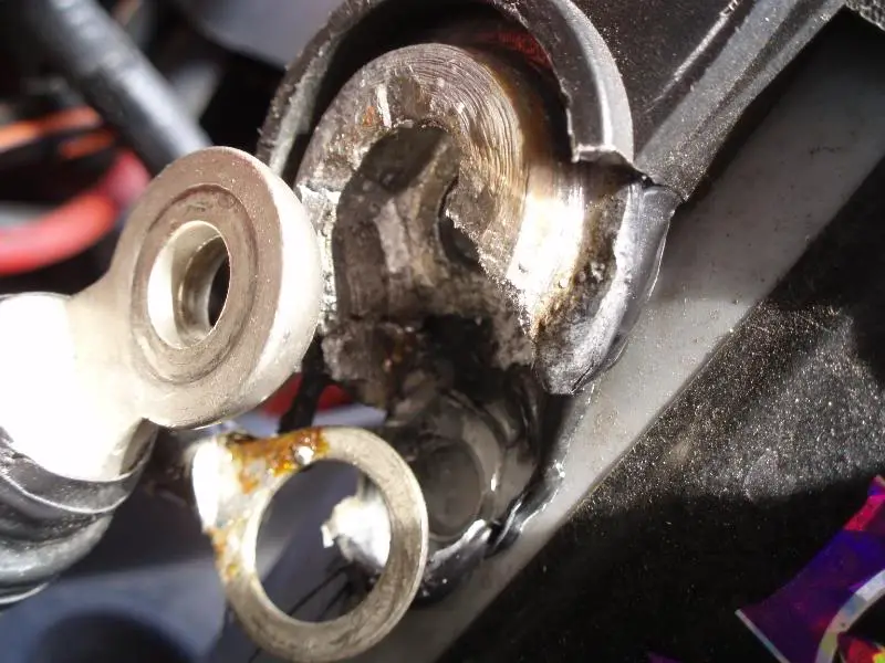

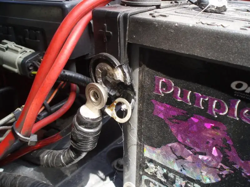

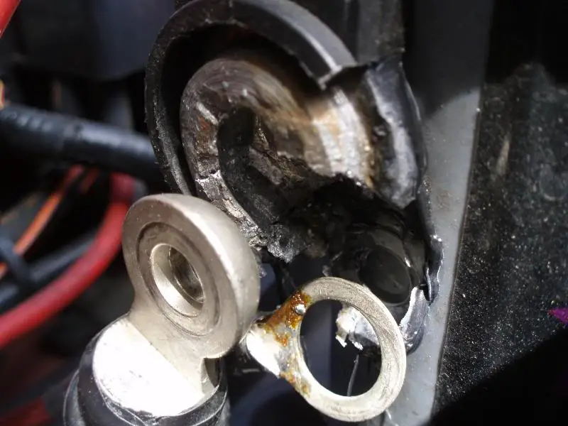

well my side mount where i have the 0 gauge for my amp and the wire to power the compressor for the air horns melted off. The metal actually melted. I've never seen such thing.
I was cleaning my truck and had the radio on for about 3hrs w/ the subs all the way down, barely hearing them. Then when i'm about to leave i put the subs up and they are not making any bass. I check my fuse, i didn't pop ( i have the breaker style fuse ) i check my amp, its on. Check my second battery and its fine.
So i start tracing all the wires and ended up at the battery with this site.....
what could it be?

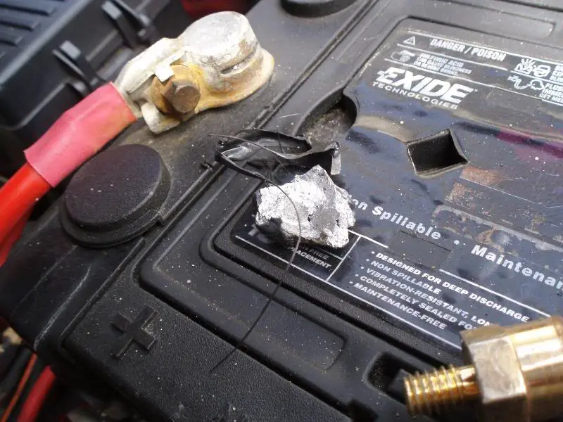

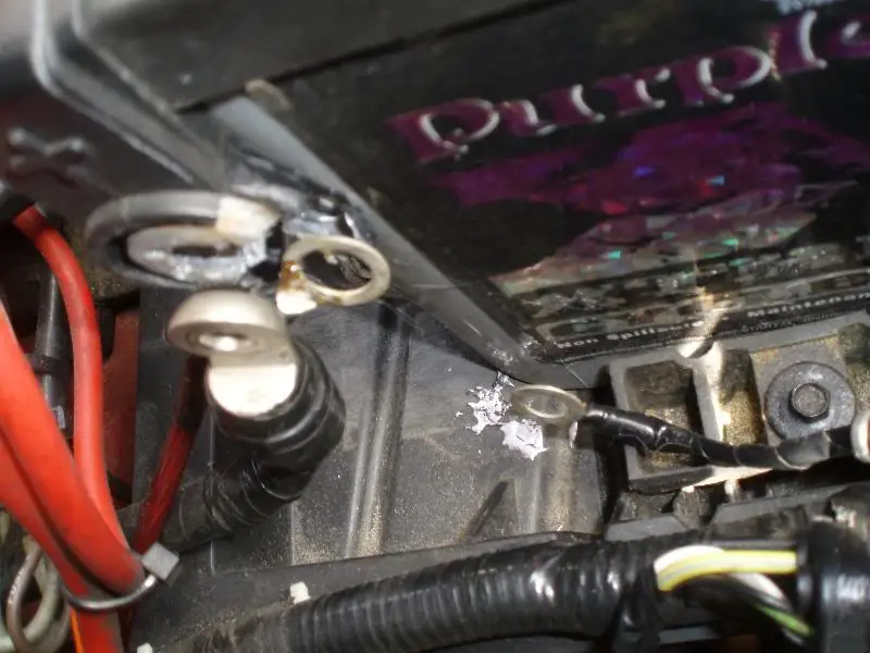

anyway after looking closely at the wiring and the battery i think i came to conclusion of why this happened
The battery i am using is slightly smaller than stock, so the battery holds the battery in place from it moving from side to side BUT doesn't prevent it from sliding forward and backward.
What i'm thinking is that over time the lead terminal got weak, eventually crack. When it cracked the terminal made little contact to the actual battery terminal creating heat which in turn made some of the plastic to metal.
The solder on the pic i realized is from the wire that goes to the air horn compressor (i solder all my connections)

I've had a guy come into work that had the same thing happen on his jeep when winching with an optima battery. The problem is that that side post really isnt a true side post, its a thin strip of lead that runs down from the top post(unlike other batteries where the side post is made into the side of the case) which when it gets hot melts easily. A solution is to connect the accessories to the top post and dont use the fake side post for high current draw accs. aka winch, amps, etc..
^^ is right if u look at the pics you can see that it is just a strip from the top post to the side. Happen to my friend and all he did was wire it to the top and has yet to have the problem. He has sups and a winch.
