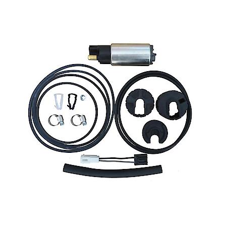

Well I just got this today.
Hopefully This will go in REALLY Soon so I can hear how well she runs. Will post as it is installed.

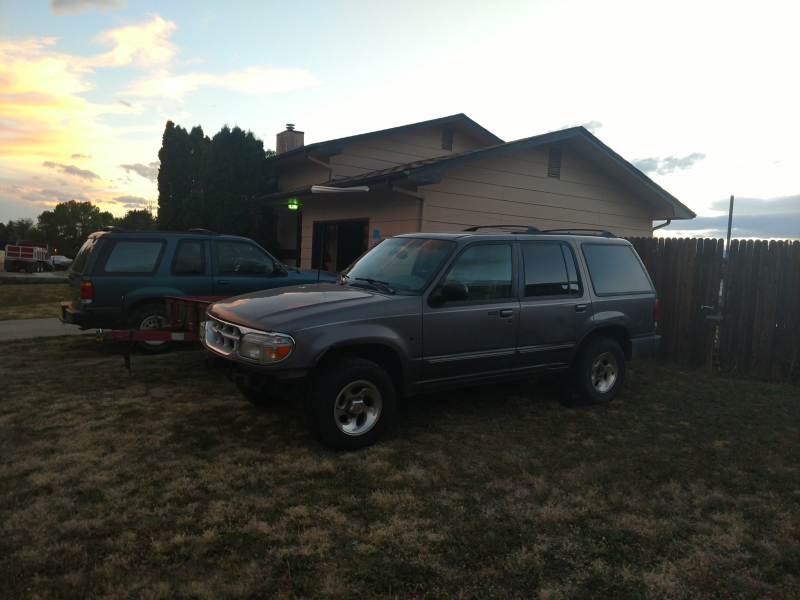

Well look who I got running on her own power.
Replaced the fuel pump and put tank back into EX. Before totally in I turned the key and heard no pump. Was supper bummed. So I just turned her over first try nothing 2nd try she fired right up. So super excited. Now to get insurance, registration and better tires then on her and go running around. Next major project for her will be replacing transfer case. Happy she is able to now move on her own.

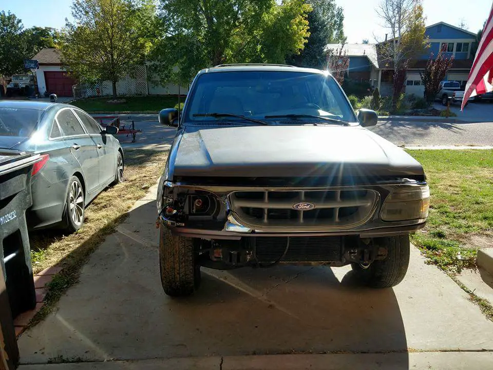

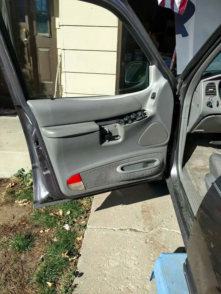

Well I replaced front bumper and grill. Put drivers door panel on took passenger side step off and put my daughters rims and tires on for now. Till winter is done. Here are some before and after pictures.
