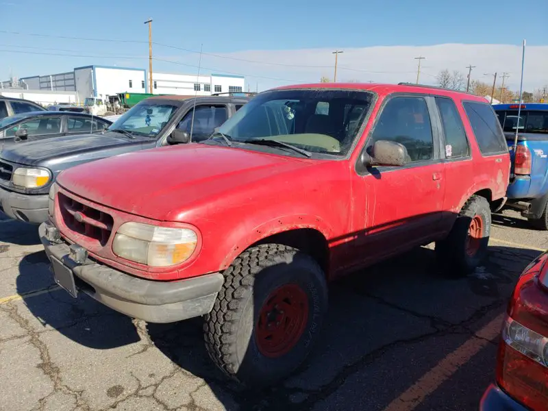

OK you all I have a question and it is got me stumped. I just put on 32" tires and the Speedo is still showing correct speed. I have used Waze Maps and Ulysse Speedometer and when I am cruising at 80 MPH on my speedometer it is showing the same speed on these two. My Sport was suppose to have the 4.10 gears but I have 3.73's now installed. (only went down to 3.73's cause I got this with no axles.) So is this a quirk or is this normal. All other times I have added bigger tires to a Vehicle the Speedometer is off.
Thanks in advance.

Thanks Gman BUT My Speedometer is reading Correctly. I was just wondering if that is possible. The only thing that I know of is that the Axles are a 3.73 when the truck originally had 4.10 axles

You don't have speedo gears. All 98's and up use the abs sensor in the rear differential. This allows for different gear compensation automatically, but the abs module still has to be programmed for tire size.
If I had to bet, the previous owner probably had it reprogrammed and it just so happened to match your setup!
You got lucky, spent years compensating 7% manually in my head when I threw 33's on red.

My bad, forgot it is a 98. Lol
What tire size was the previous owner using before the axles was removed?
The computer is set for gears, and tire size, going by how many revolutions in a mile. The change of gears, and tire size (if any), might have just worked out where they offset and reads the same rotations, or close to the same.

There a chance the truck used to have 33s with the 4:10s and was programmed for that?

I’m the previous owner and it was not programmed. Mystery continues...

So it does. WOW Not sure what to think. I guess I will just let it be and See what happens when I get the 4.10s and 33's.
