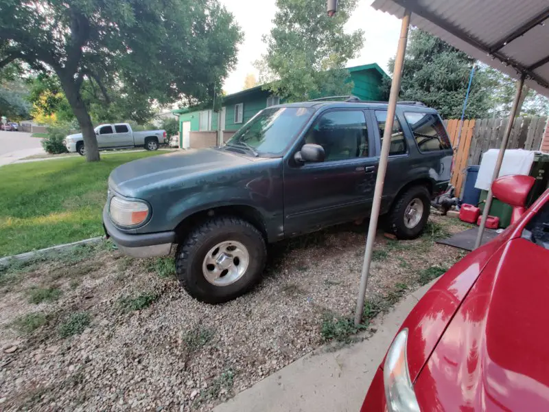

Well I finally got the Tear Drop Rims back on my EX. I am super happy with them this way. I have always liked Chrome or polished rims.

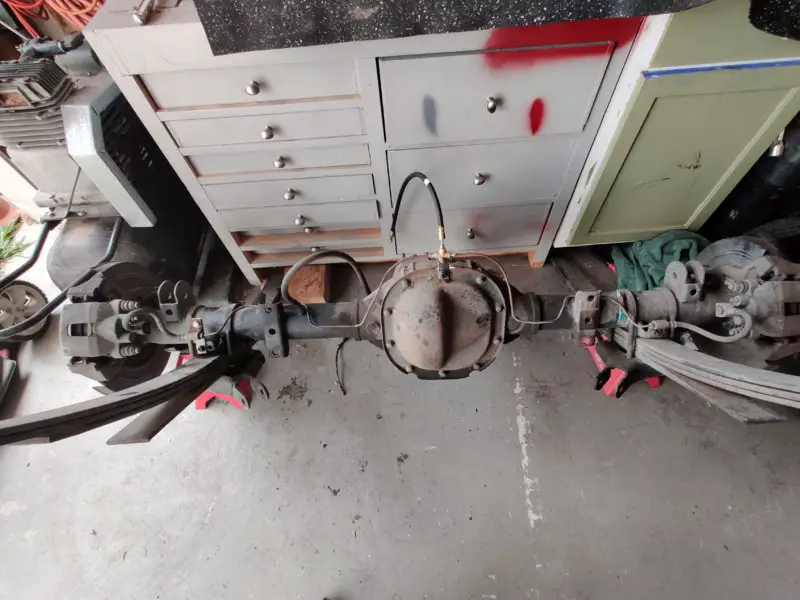

Well started getting axle ready for going into my explorer. Moving brake line from driver side drop to the center of axle as shown in the picture. I used a passenger side brake thingie for the driver side. Kept hard line to the center put in a T for a soft line going up. Gonna use a hard line from the frame going to the center to hook into the soft line. The soft line might be a little long Will see what happens when I get it installed into my ex. By the way this is a LS axle. Gonna rebuild the LS pack then get it installed in to my explorer.
