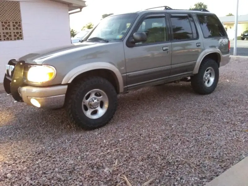

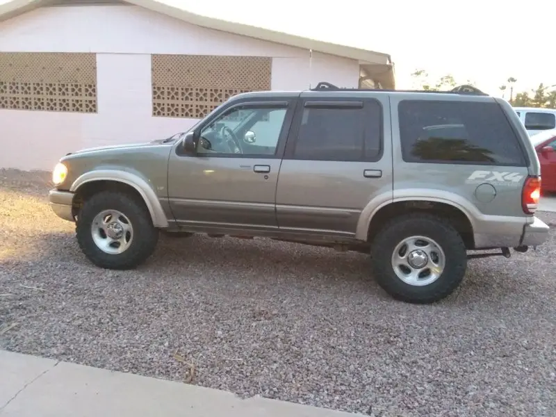

Well these past few trips have shown me... These running boards have got to go...so...
She looks kinda bare but I like it. Looks better than I thought it would.
Do have a query... is there a cheap and easy way to fill the holes left by the plastic clips? rubber plugs?... waterproof tape? LoL I don't care, just don't want water in there.
It does look a lot higher now.
Are you working on some rock slider - nerf bars now?
Yea I was amazed at the difference in appearance.
