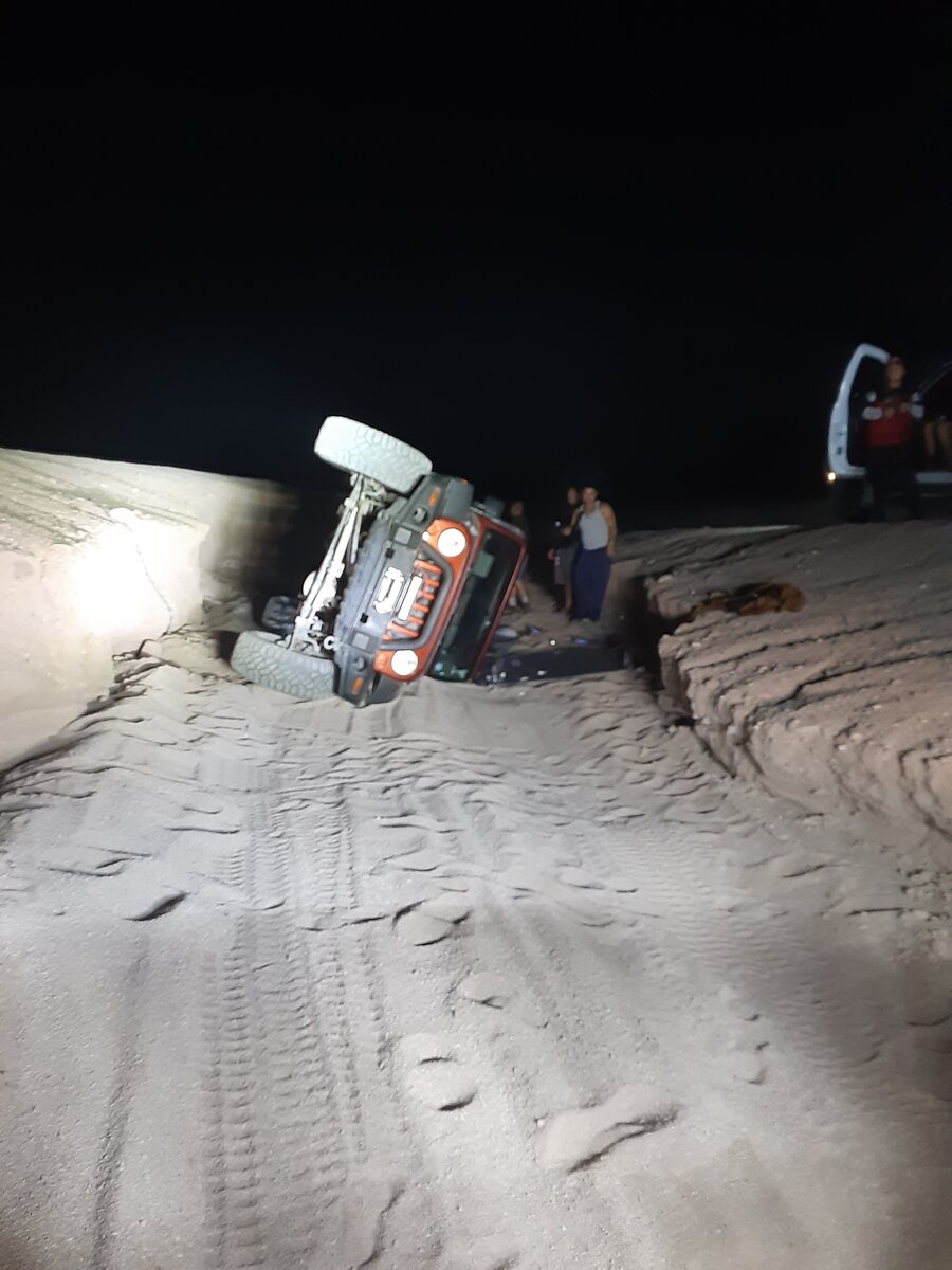

The new Winch got a test last weekend. I'd been out doing a night run of Sycamore Creek and when I returned to the camp area at the trailhead I found this...
I stopped and ensured everyone was OK. Then I went up to the bank on the right and pulled the jeep so the right side wheels were on the bank, it was then pulled by another winch on the opposite side till it was stable on its wheels. There was more involved than that but you get the idea.

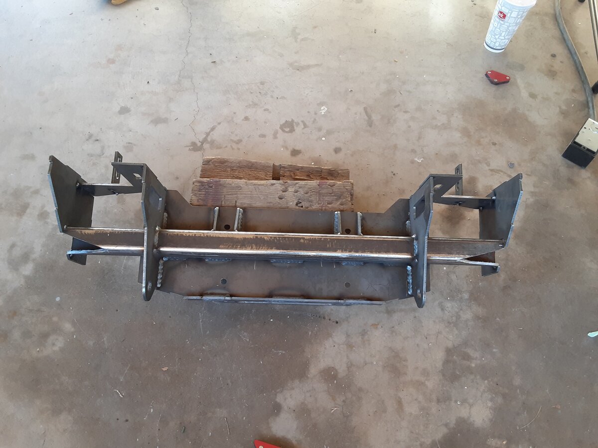

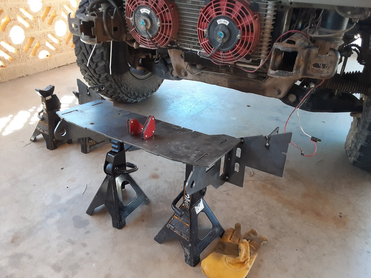

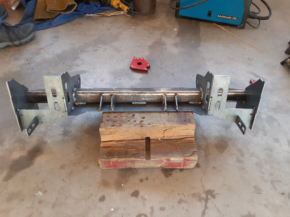

Did you end up notching the provided plate that would have mounted to your inner frame horn about 1.5" to get up and over the end of the frame? I just bought a Gen 2 kit and it looks like I need to notch that inner mounting plate to the top of the upper slotted hole (bottom hole in your pic).
No, any notches you see were done by me as part of raising the factory bumper for the 2.125" body lift. If I recall correctly, I needed clearance for the bolts holding the pieces I used to raise the bumper. I had Matt weld braces behind the bracket to make sure the notches didn't weaken them when I put the new bumper on.
