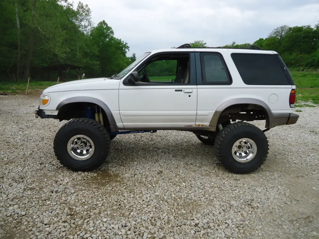

This Explorer is almost done. This was a bunch of my favorite parts and setups all combined into 1 Frankenstein truck. I really like 1st gen Sport frames cause easier to SAS IMO, no issue with steering box fabbing/engine cross member. I love the 4door 2nd Gen V8 powerplant, but I would rather drive a 5spd. For now, this truck is almost done, but rear needs lowered to match the front.
Specs:
-1997 Explorer Sport Body- Sunroof, keyless entry
-92 Explorer Sport Frame

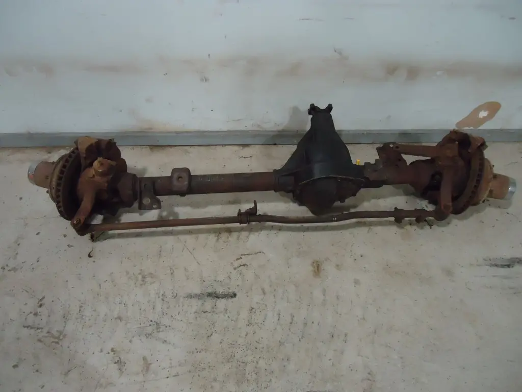

-77 F150 D44 Narrowed and has Chevy Knuckles with Flat top Hi Steer, 4.88
-8.8 Disk Brake rear, 4.88, Detroit Locker, Diff cover
-98 Explorer 5.0
-Torque Monster headers -orginally Ranger Swap headers
-5spd from 97 F150 4.2 V6 4x4 truck
-4406 Manual T-case

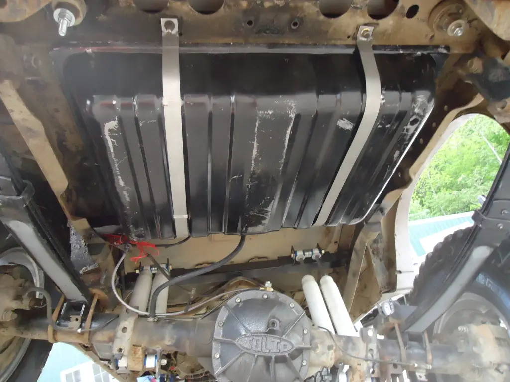

-91 E150 Rear mounted gas tank-pends install this weekend.

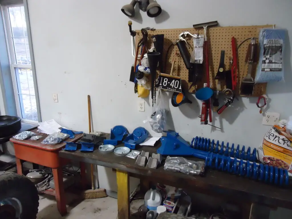

-James Duff longarms
-James Duff Track bar mount
-James Duff coil bucket towers
-James Duff 5.5 coils
-Rear explorer 4in lift springs axle under, might be to much. *Depends on rear tire, full tank, sub box weight and amount they settle*
-Xcal 3 Tuner- Custom Henson performance tune- deleting tranny inputs
-1in Body lift
Has been long winter building this vehicle.
Todo list: Some wiring
Shifter boots
Wire up ARB compressor for onboard air
add to front bumper
Rear spare tire carrier bumper
Rock sliders
Transfercase skids
Wish list:
Atlas 4
Install Dana 60 and Sterling 10.25
Hydro assist
beadlocks with 37-40 bias tires
No additional lift, just trimming.
Rear lowered, looks alot better IMO

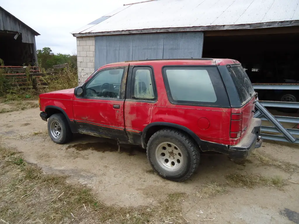

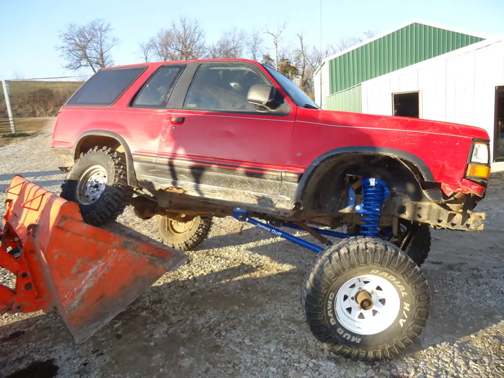

92 Sport started stock
Wheeled it for along time like this, but had other plans for parts.
Brought home the sport all stock- orginal owner

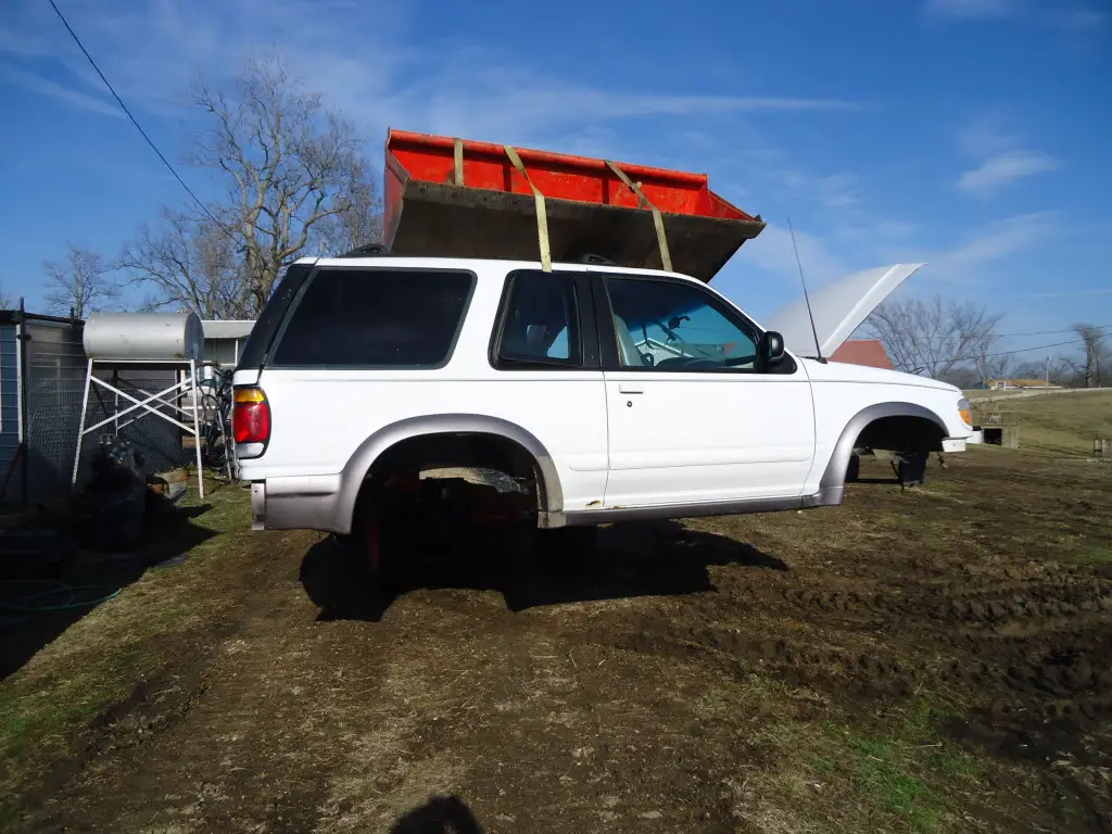

Pile of parts for SAS
Checking out the front end

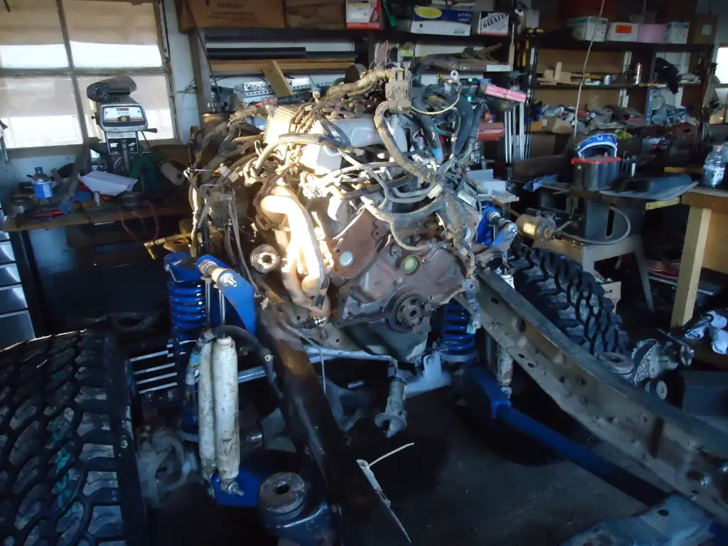

Working on the engine swap

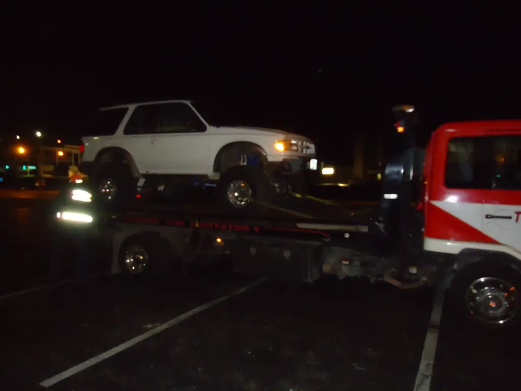

Yea Looks good, but the 1st long haul attempt last night didnt go so well, but not huge ordeal, because my 4406 took a dump, 2nd one now that has went bad on me. Uggh... ATlas 4 I think so, just dont have time yet to get 1 for the SMORR meet.

Also, I plan to show some details on my tank swap to hopefully make it easier for the next person. I took ideas from another member can't rem the name but still had to work on it.
