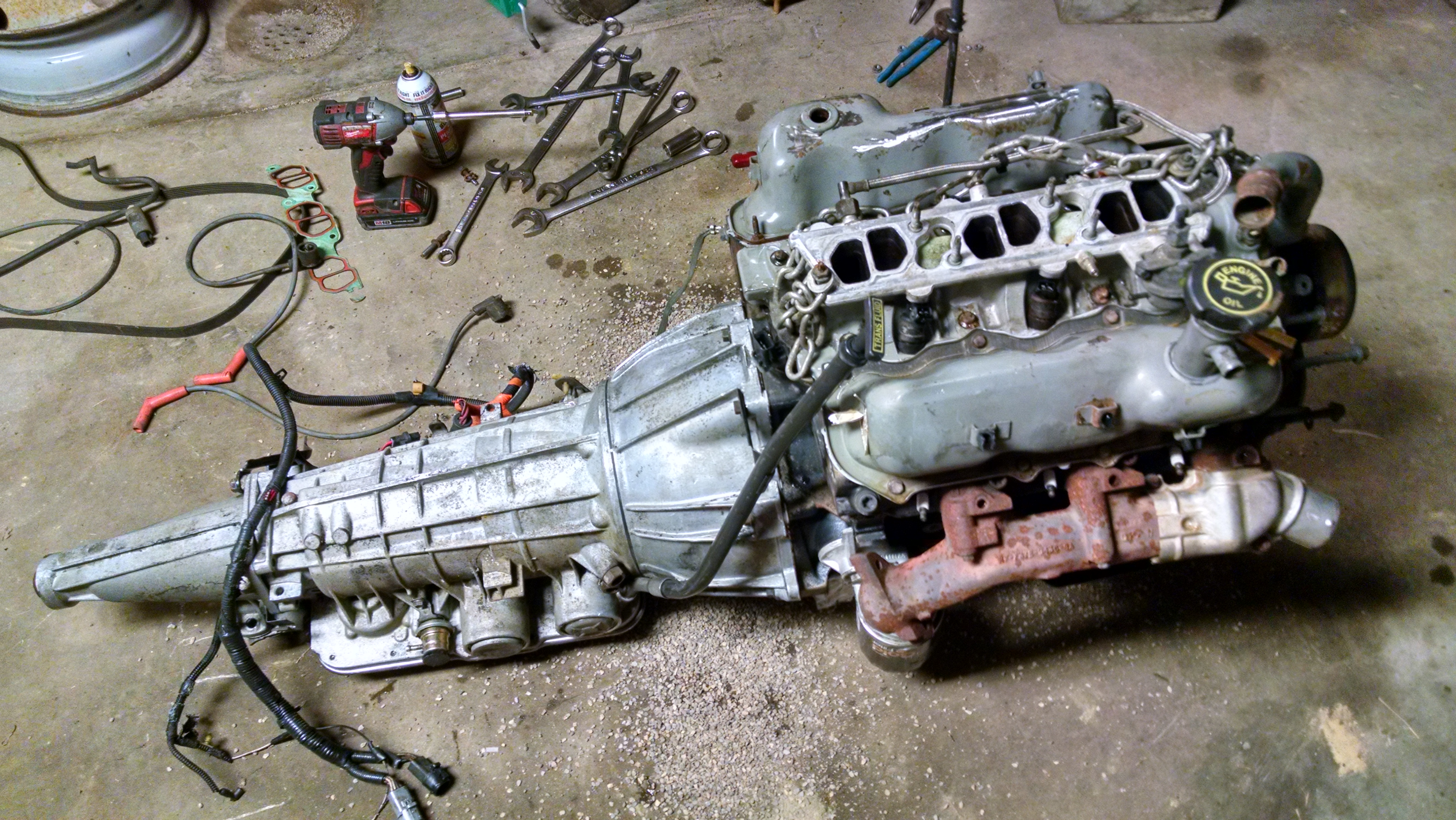

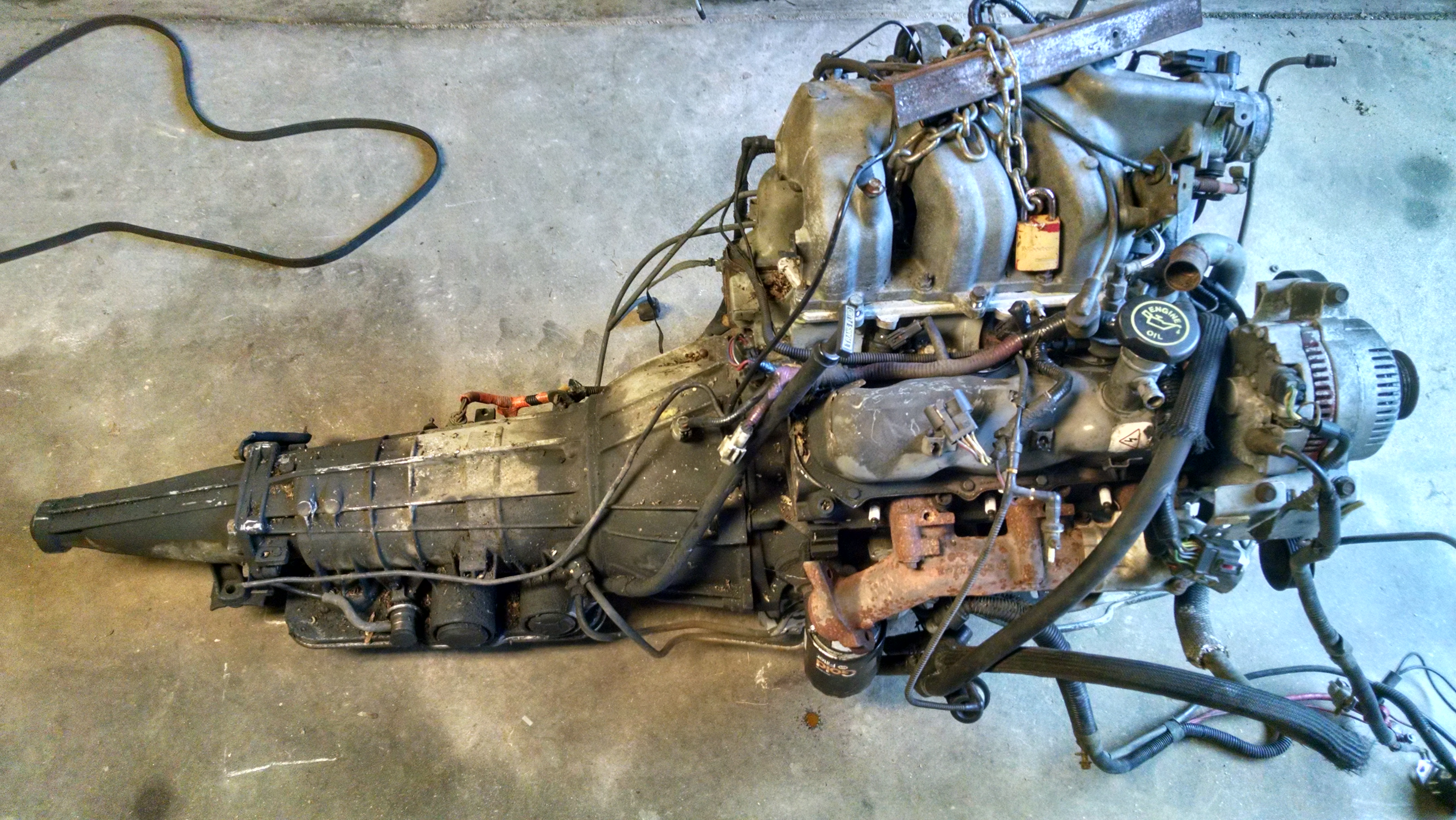

A little update, no pics but I will grab some tomorrow. I pulled the engine and trans today. I never tried to pull them together so I did it today and I don't recommend it. I even had everything removed from the engine bay, everything... If not for my forklift, this would have been a real b***h!
On the plus side, this ex is so rust free, the bolts holding the down pipes to the manifolds came out easily with hand tools. Even the fuel tank skid plate still retains its shiny black factory finish. I still can't get over how clean this thing is. It makes a project like this so much easier.

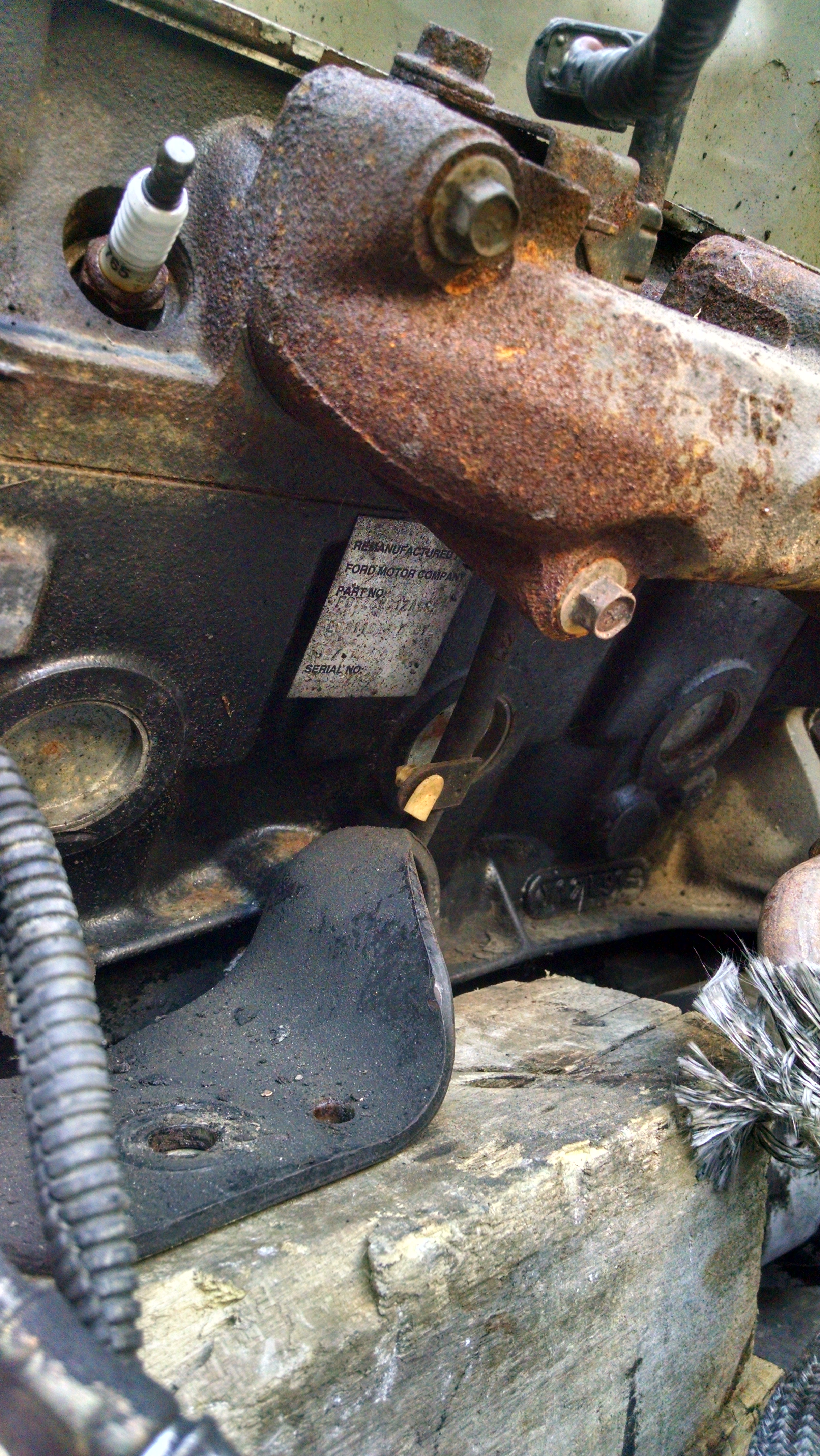

Didn't do a whole lot tonight, but I did get lucky. I cleaned up the engine and found a tag on the block.. My $300, rust free find, has a new engine as of Feb 04. It's a Ford reman engine. Something done at the dealer I'm sure. It has a Ford part number and a serial number on the tag. The heads are stamped with the same date.
This makes me feel better about the 224000 miles on the odometer. This engine may have less than 100k on it.
I'm still going to do compression check and check it out, but I don't think I'll be resealing it like I planned to. That will save some time and money.
Some before and after shots..

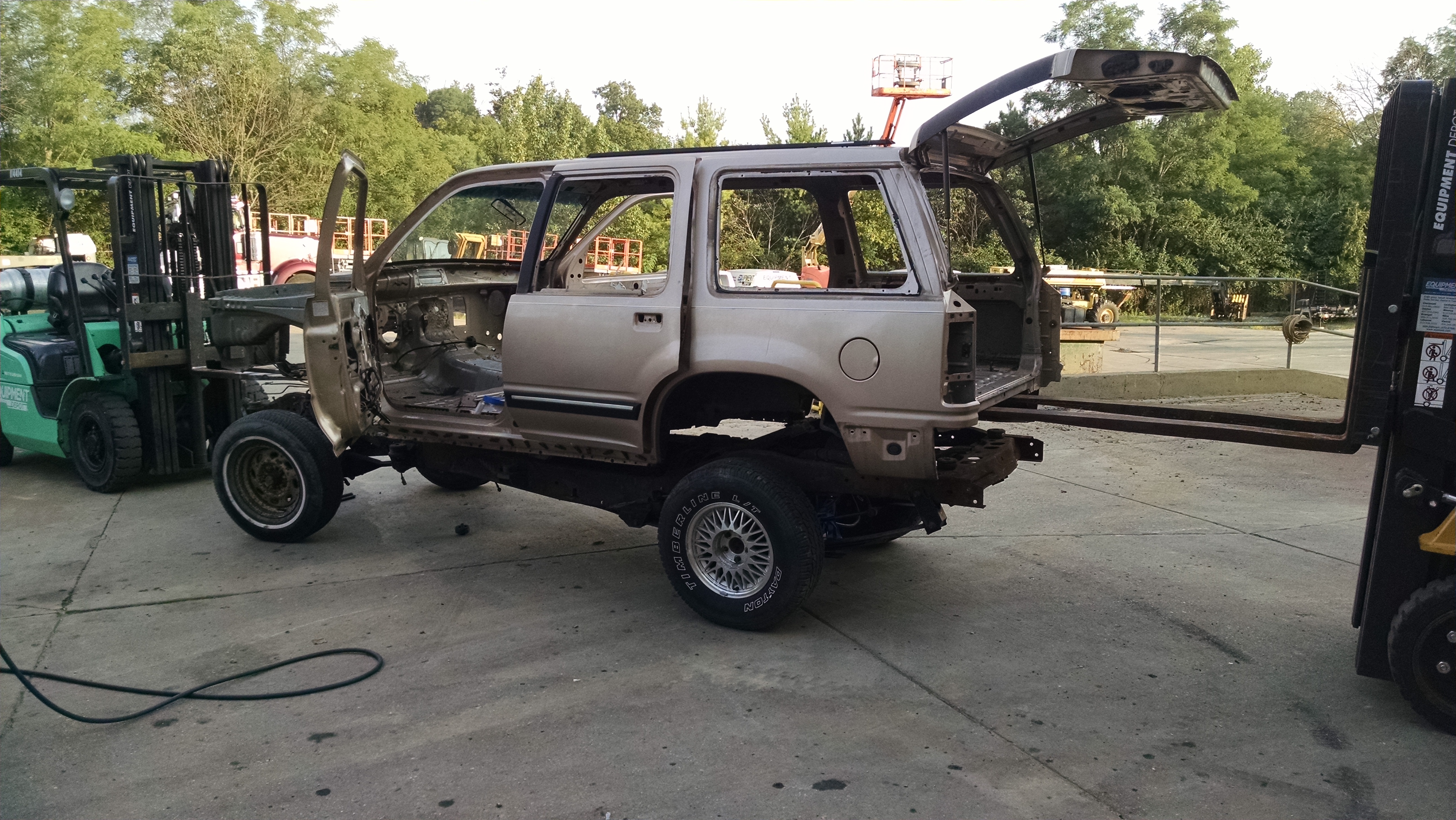

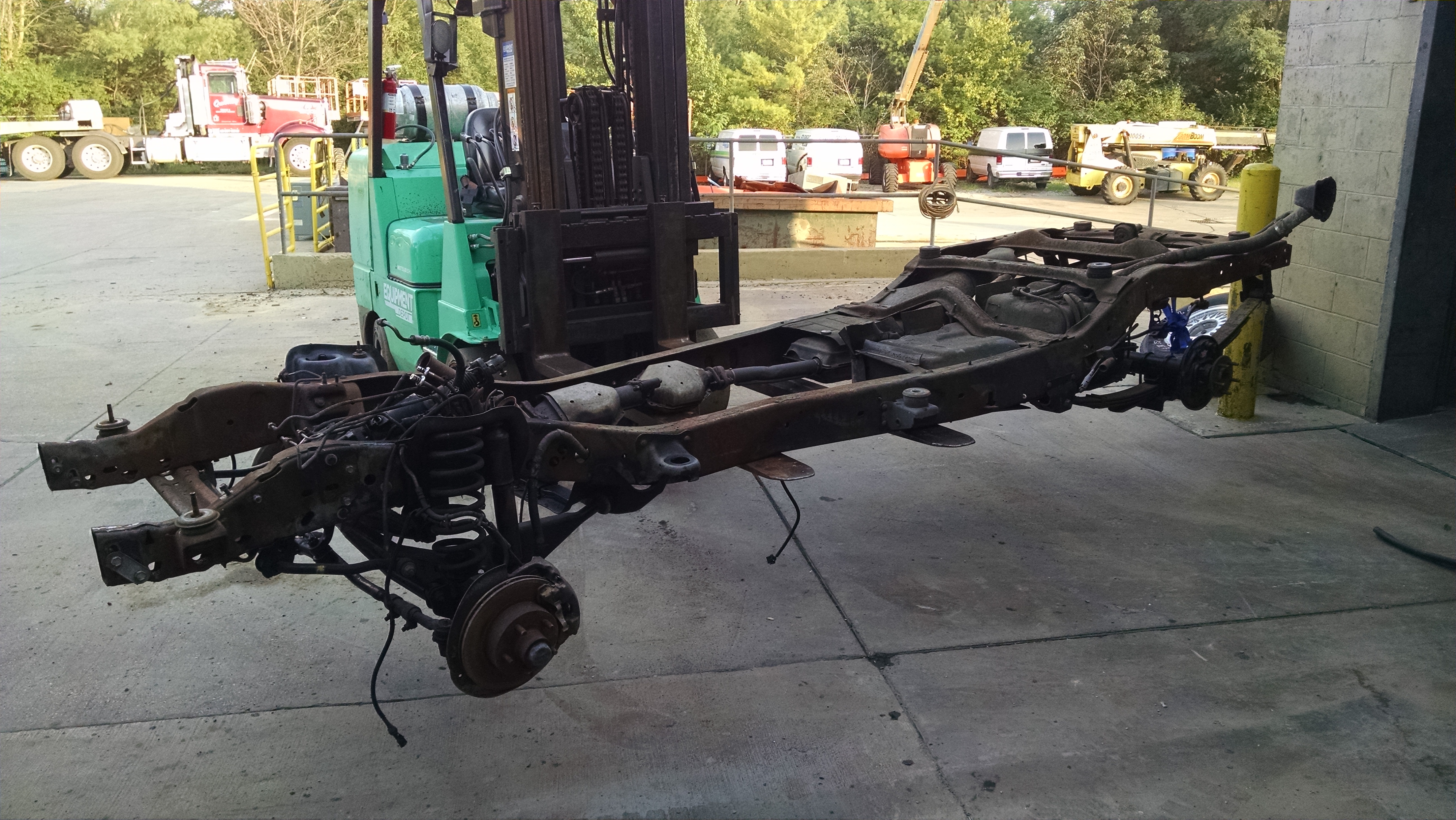

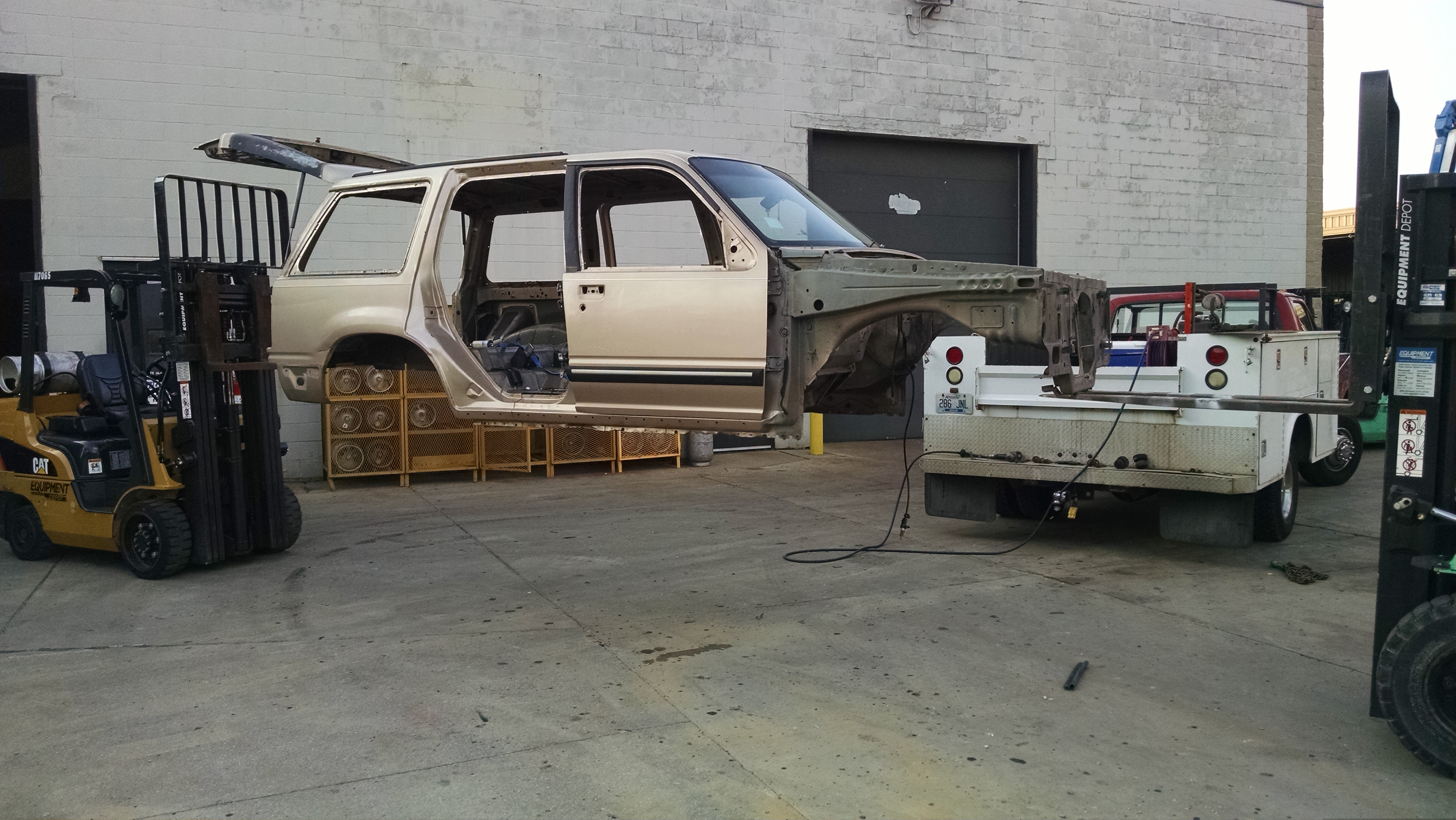

Today, was installing a rear axle in my brother's 94 XLT. After 268k it was ready to be retired.

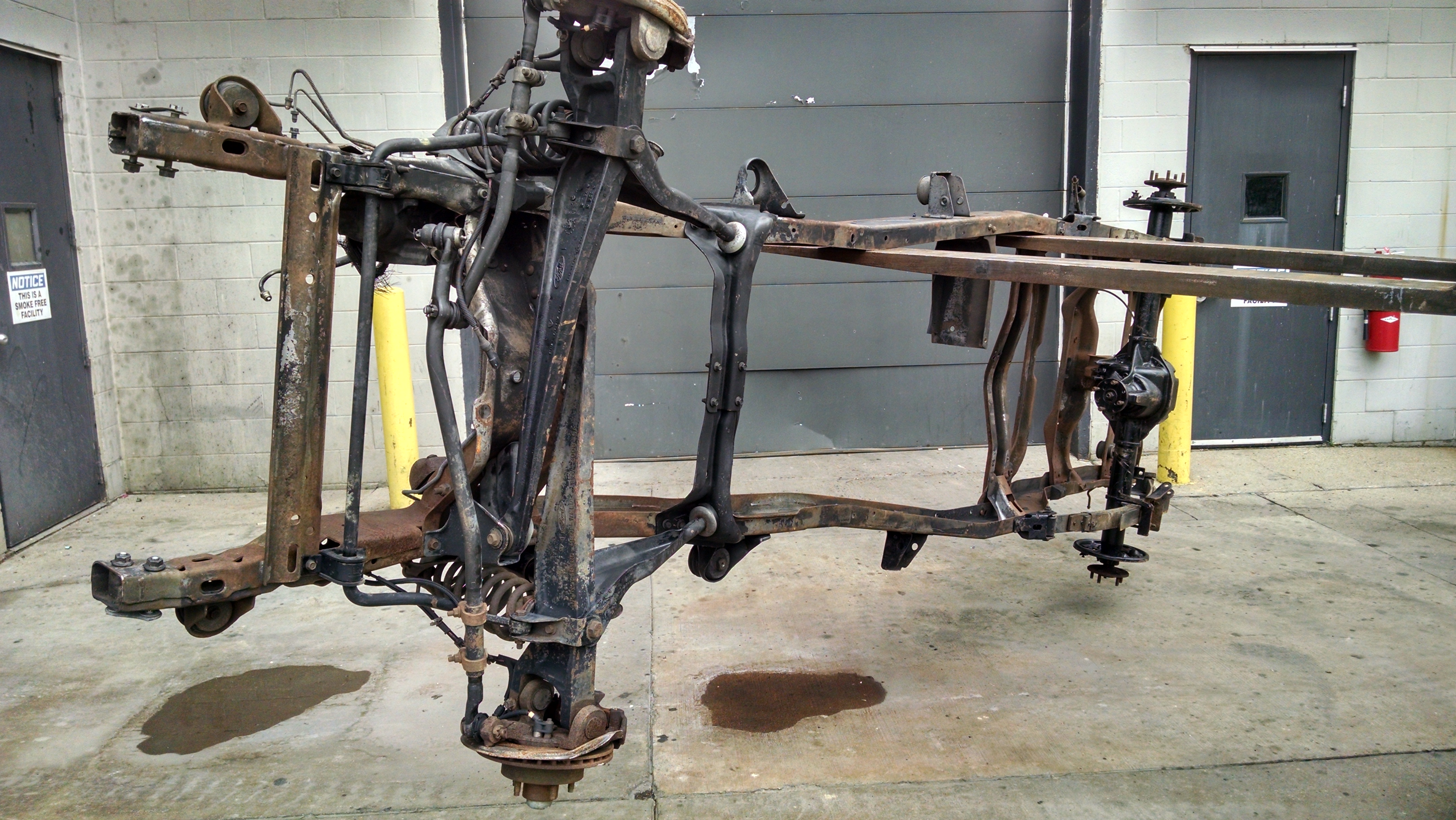

As far as JP, it's on the trailer ready to head to the shop to be separated from its frame for its final pressure wash. I have disassembled it down to the absolute bare shell with enough for it to roll. Once I get everything clean, the frame will get a coat of POR15, and the body set back on it for now.
Then it will be time to start the body work. I have some hail damage to fix, there is a crease in the wheel arch on the pass side that i will have to pull out, and the normal door dings. From the previous vehicle i have a hood, fenders and a rear door to replace the damaged rear pass door, that is creased to match the damage on the body.
I'm getting excited to see progress and will be posting pics here soon!

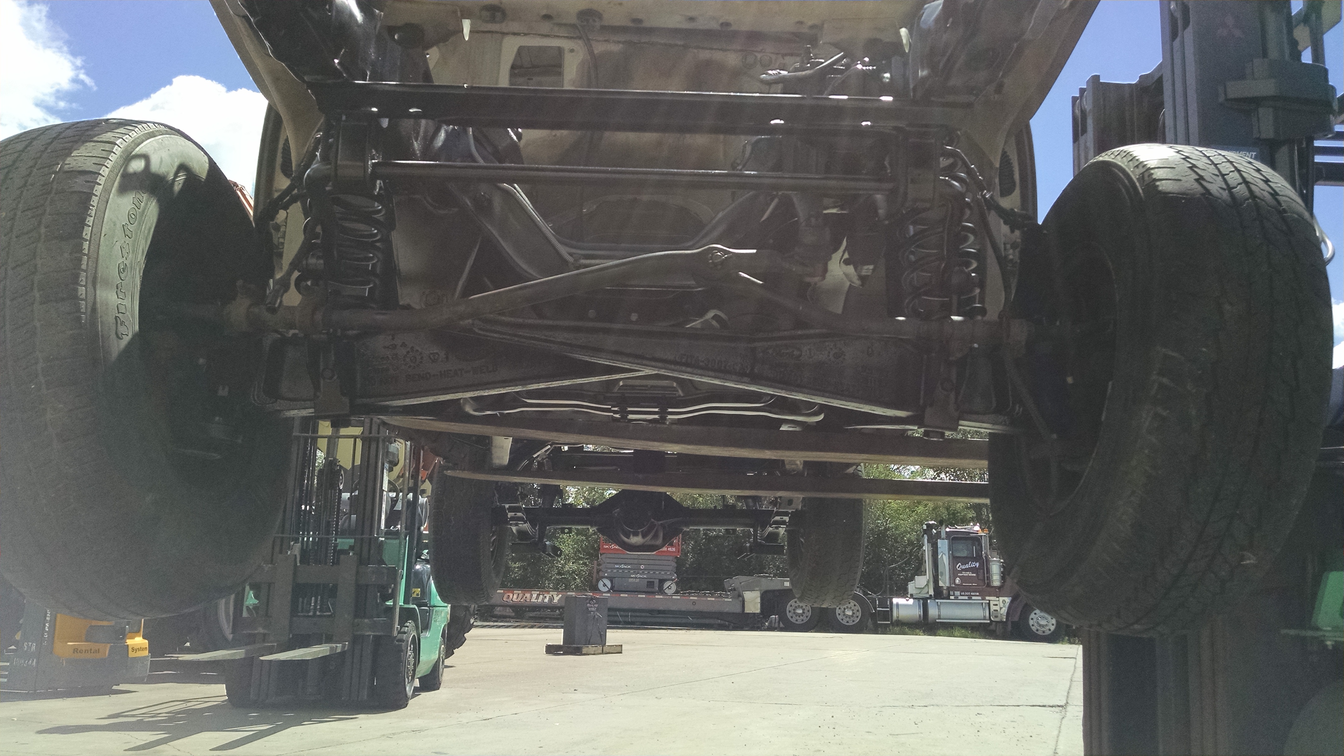

Tonight after work I finished up the steam cleaning of the whole truck in order to start painting. Tomorrow I will be picking up the materials and hopefully I'll get a coat on the frame so I can mount the body back to it.
Once I get it home I'll start on the body work. I'm aiming to have paint on the body by the 1st of November.
Having the wash bay at work is such a nice luxury. Having tons of equipment available ain't to bad either. It made this job so much easier and doable by myself.

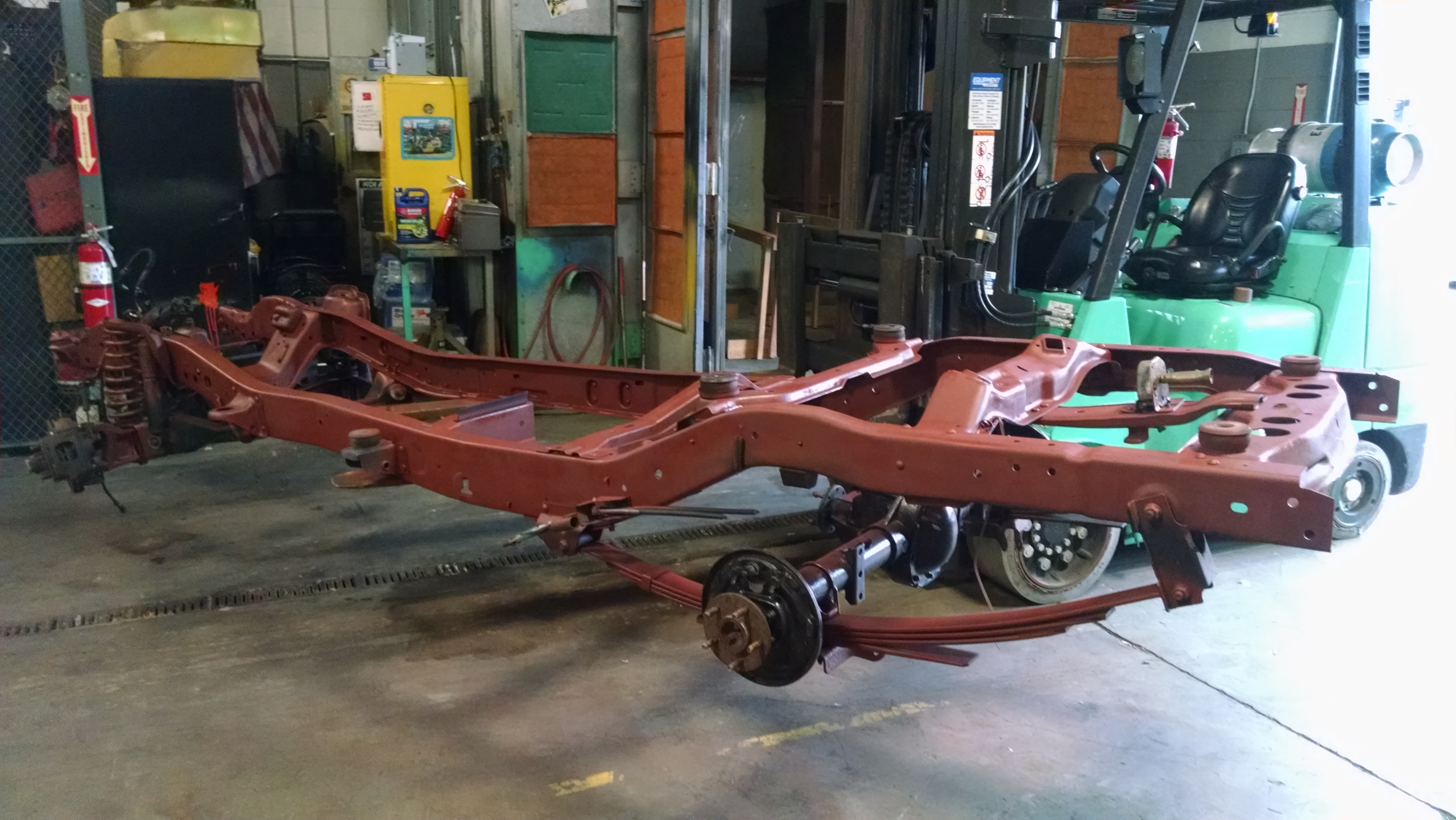

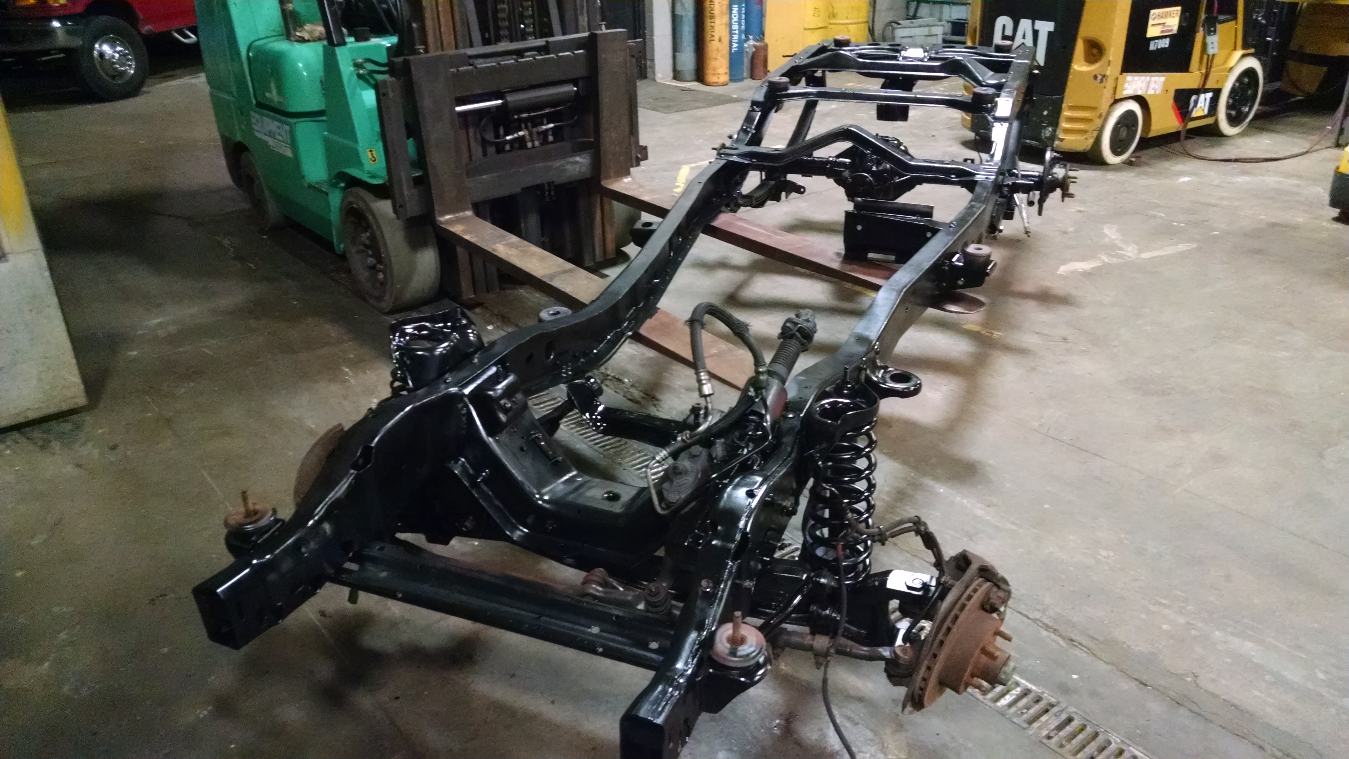

Getting there... Watching paint dry now. It's taking longer because it's raining today. Never a good thing when wanting paint to dry fast.
Finished up cleaning the frame this morning, got some rustoleum primer and put a few coats on where there is bare metal and surface rust. I wish I could powder coat this but I don't have the money for that.
How she sits now:
92exp4x4
February 5, 2003
1,637
268
Covington, Kentucky
92 XL 2-door and others
As it sits tonight.. I'll be able to mount the body tomorrow. I'll have to pull out the core support, it kinda got forked while unloading the trailer. I bent it back at the bottom about 4 inches.

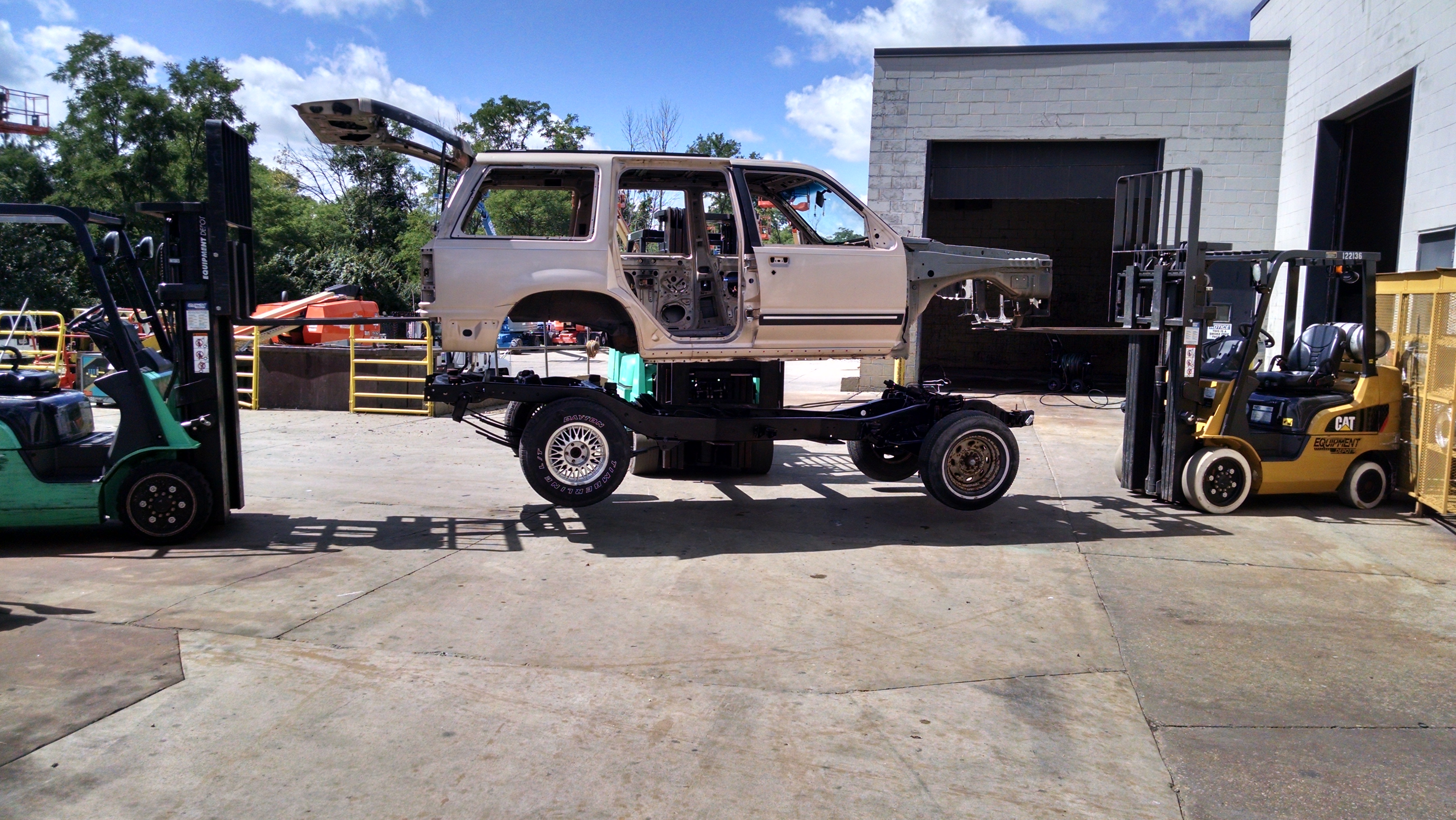

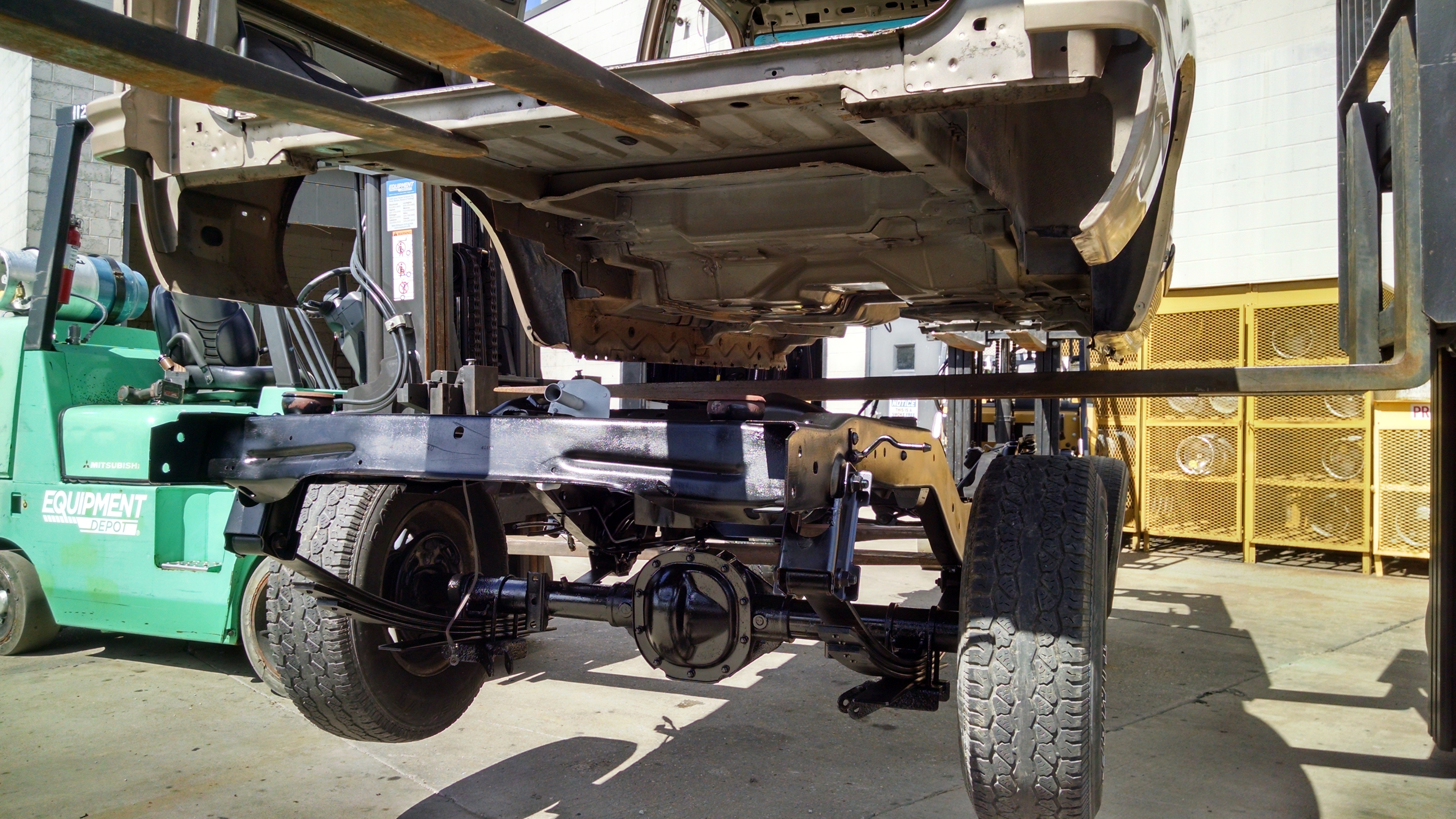

Covington, Kentucky
So.. today I mounted the body back to its frame. JP is up on the trailer and waiting for me to clean out the garage so i can start fixing dents. I may have paint on this before my goal. We'll see what happens.
I'm now at the exact point that I was with the previous vehicle, in the first attempt with this project. Feels good to get this far, this is kind of a personal accomplishment for me.
