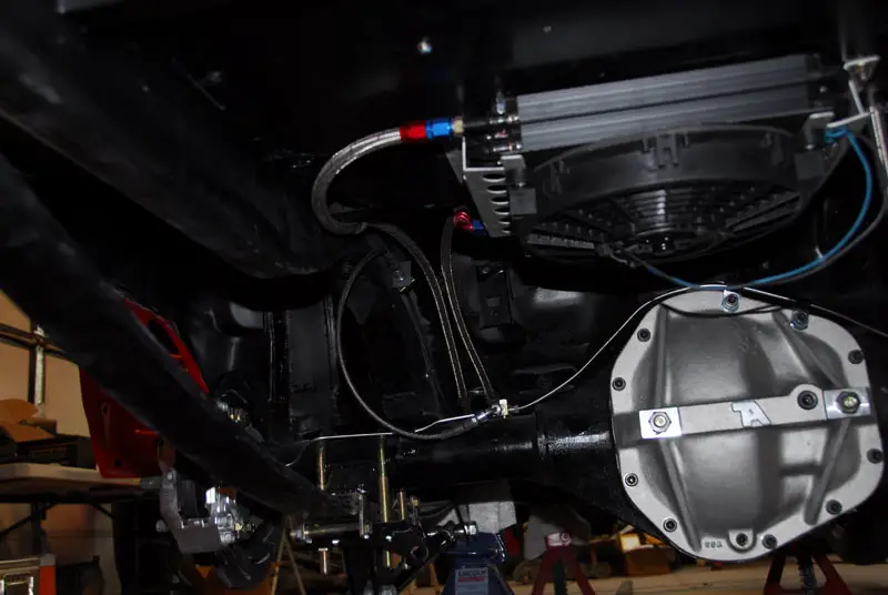

Fuel cell and pump are back in, fuel lines are routed, and tranny lines are routed to the cooler. I'm stuck waiting for parts to finish up the electrical system.

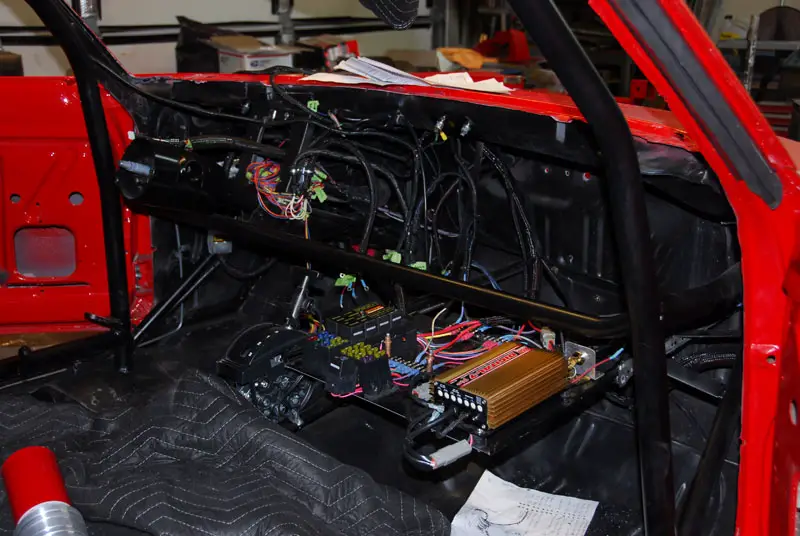

I need to get my engine back before I can finalize the harnesses. The machinist is supposedly going to get to it next week.
I'm running Autometer Elite series gauges. They will be able to send data to the AFR logger so I can match RPM, water temp and fuel pressure with the AFR graph. The gauges also have "pro-control". Pro-control switches external devices on and off when the gauge reaches a pre-set max and min, pressure, voltage, or temperature. I'm using it to automatically switch on the transmission cooler fan. For now I'll be doing the engine fan manually until I see what kind of temp the engine likes to run at.

Fuel lines ran, electrical and ignition in - time to fire it up!
Just need an engine to connect it all to:confused:

Yeah, not having the engine has held me back a bit. Since I haven't been able to finalize the wiring I can't install the dash, or windshield.

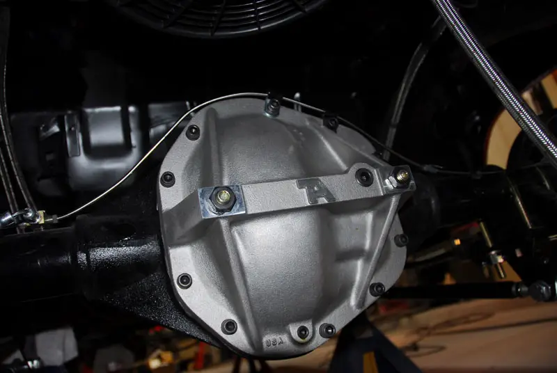

Bled the brakes today and all is well... Pheew! I was worried about all the double flares I made being leak free, but there were no problems at all: I also filled the rear diff with gear oil.
She's got her first fluids in her!! A noteworthy event, kind of like first feeding time for a baby;)
My Strange S60 came with Lucas 85-140w so I'm using that. I'm using Wilwood 600+ Dot 4 in the brake system.
