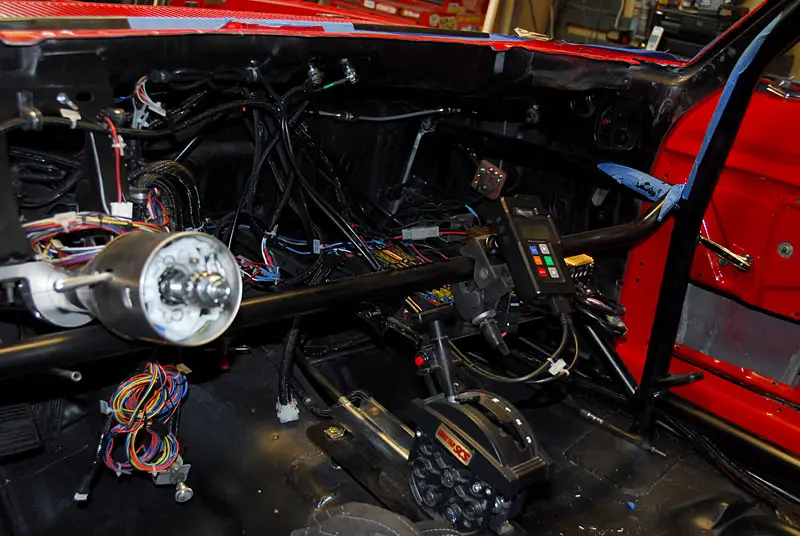

Your electrial work just sets me back. Its just flawless
He learned from his mistakes on the Explorer. I've seen him a couple of times chasing the missing ground or power on the ARB's and such.;)
Yeah, the Explorer had everything added to the electrical system one piece at a time which made for a mess in the long run. I helped things by adding an auxilary fuse box under the hood, but there are still a few relays and fuses which aren't in a central location.
I'm making a schematic for the Dart to help with troubleshooting down the road. There is no schematic for the Explorer which leads to a lot of pulled hair...
I know the feeling. People always ask why I still have carpet. I just tell them cause I don't have enough zip ties an/or wire loom :D Just had my first hair puller with why I had power to my ARB pump, but not my switch. Had to dig out a 10 year old ARB drawing to figure that one out:rolleyes:

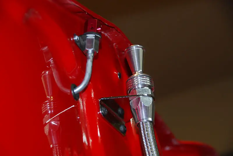

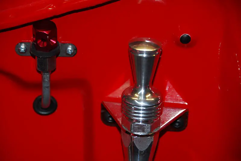

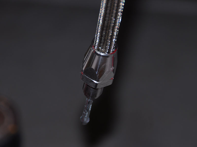

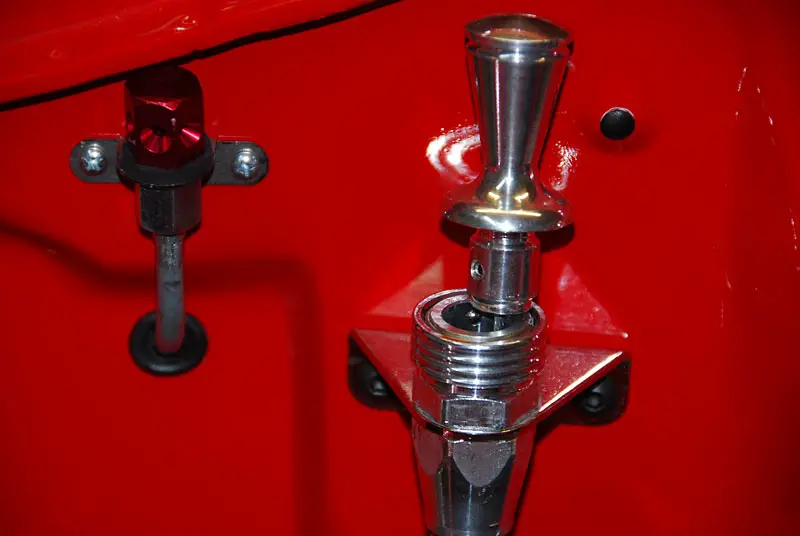

Lokar Locking Dipstick NHRA Approved

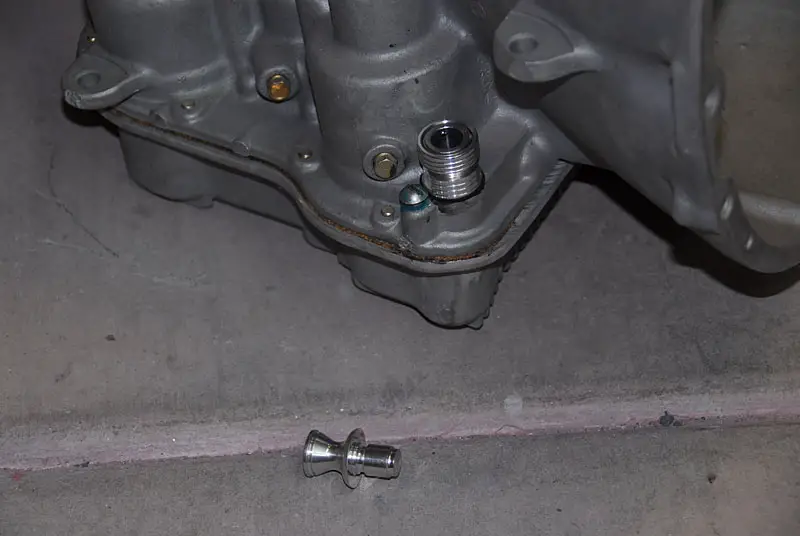

Lokar did a great job with this dipstick. Not only is it NHRA approved as a locking dipstick, it also comes with a sealing plug for the tranny. With the plug you can pull the dipstick using a quick release coupler, then plug it for transportation or storage.
So it doesn't blow out and puke tranny fluid. The Mopars aren't known for that, but the new rule demands that if you run faster than 11.00 you need a locking stick now.
It's a good rule actually. It helps to keep the track open due to less oil downs, and helps protect the driver and vehicle from a tranny fluid fire.
Do you have a hose you can fit into the top of that dipstick? Thats my biggest complaint with the local dipstick tube on our 700r4. Its hard to get fluid in.
