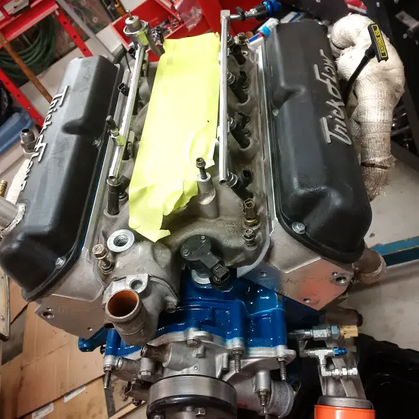

Here's some pic's of the china wall.
To prep the cork, I peeled all the double faced tape off, then used lacquer thinner to remove the rest of the glue. After that, I trimmed the cork to a perfect fit and glued them to the china wall with ultra black, making sure the ultra black was filling in the ends of the cork to head joints perfectly.
When installing the lower intake gaskets, I used a drop of ultra black on both sides of the cometic gasket in the corners also.
Oh, and when the heads wen't on....yup, a dab of ultra black at china wall on either side of the head gasket.
I'm really hoping that there is no leaks for a few years.

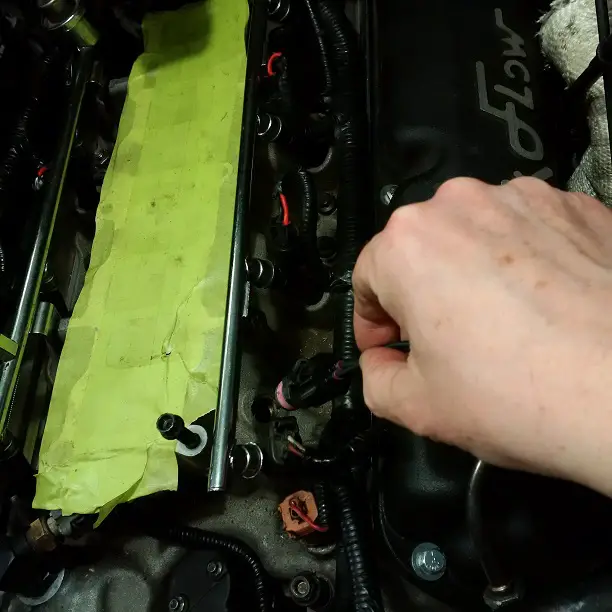

IAT Sensor location
While I'm at this, I decided to move my iat sensor in preparation for water/meth.
I wanted the iat sensor the read the lower inlet temps when spraying, and the higher temps when not spraying. This created a few things to think about as my current iat reading comes from my maf.
Everything I have read says spraying w/m before the maf is a bad thing and will destroy the maf. Um, ok. So I need to spray after the maf, and still be able to read the lower temp.
The trick flow lower intake has a port for what I'm guessing to be exactly for this purpose. Cylinder# 5 , just before the injector. assuming there are no heat soak issues (I'll be able to log and see whats going on) its a perfect location and the pcm will get a temp reading of exactly what temp of air is going in to the cylinder.
I need to find some automotive style weather pack connectors.
The IAT used to be in that #5 intake port, all EFI 302's until the Explorer. It's a great spot to add a 2nd IAT for the comparison.
The IAT used to be in that #5 intake port.
I just looked at what I typed.... # 5 is where it is. I corrected my post. I wonder how many work related errors I make while I'm posting on explorerforum at work?
