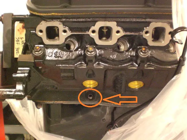

The coolant was dripping off the header at a pretty fast pace, so the leak shouldn't be too hard to spot once some form of safety precautions are taken. A coolant system pressurizing thingy would be a great thing to try, but I'd like to keep the $100.00 in my jeans if I can.
If there's no 'safe' way to look for the leak, I'll go the pressure tester route for sure.
I'm not ruling out the block heater, but after installing a new one (That fit pretty snug in to the bore) I'm not so sure that's the issue.
