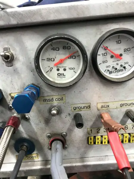

Crazy oil pressure at idle. Even hot. So far, this is a great success.

70 psi at idle!!!!
