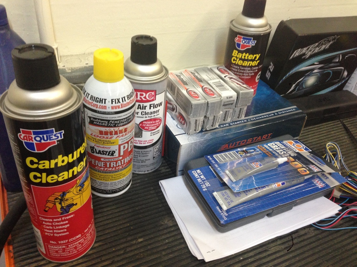

Greetings! I just bought a 2007 Sport Trac Build date 04/06 So Gen1 I guess, 102,000 miles and no idea really how the owner before treated it. After the sale I had the infamous misfire under load, original spark plugs, so I decided after reading all the horror stories on here, that it was worth a try. Might have helped dealers here wanted 600-800 minimum for the job. (No way!)
Below are the tools I gathered before attempting. We also had a garage with a compressor and basic tools. We followed the TSB/carb cleaner method of slight loosening and soaking, and working on the plugs in intervals while they soaked.

If you look closely to the first pic, you'll see a case underneath the dielectric grease and anti-seize, the case there is the Lislie broken spark plug removal took that I ordered, but actually didn't even have to use!

All in all though, it wasn't that bad. You just gotta take it slow and don't force them. I ran a single tank with chevron additive before the attempt, and we did it while the engine was slightly warm because of time constraints.

I used some penetrating spray oil, let soak and 1 pop on socket and all came out. installed new ones with anti-seize for next time! I tried the e3 plugs and actually felt a difference.
We thought about mixing the Carb cleaner with the PB but ended up not needing to. I originally bought only the PB but my mechanic friend advised me carb cleaner was the way to go. I feel a difference from the nasty plugs to the HT1's, I wonder what the e3's would feel like. I read that they're mostly for tuned engines.
