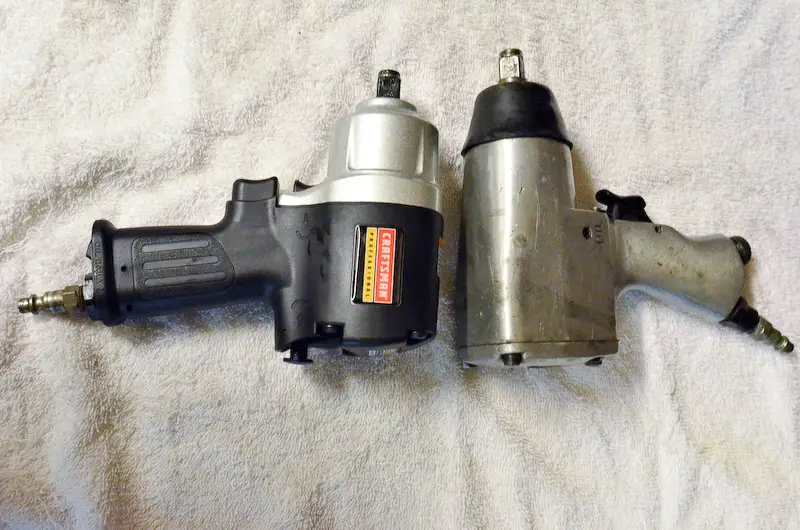

Ran the tank with the BG 44k down to near empty. 3/8" Impact still hasn't arrived, and I can't be sure it will. Plan B: Buy a mega powered 3/8" drive locally. Too bad there are none to be found. Went to Harbor Freight to see if they might have one in stock. No, they didn't, but they had a display model which they refused to sell me. *******s! :)
I have an ancient 1/2" drive that isn't too big, so I thought I'd try it with a 1/2 to 3/8 adapter. I mounted that to a short extension and 6 point 9/16" deep well socket. Ends up the exact same width and length as the special spark plug socket. But, turns out it's gutless. Went to Sears and found a tiny 1/2" impact with lots of power: Model# 19986 This will do! It also has adjustable power in forward AND reverse.

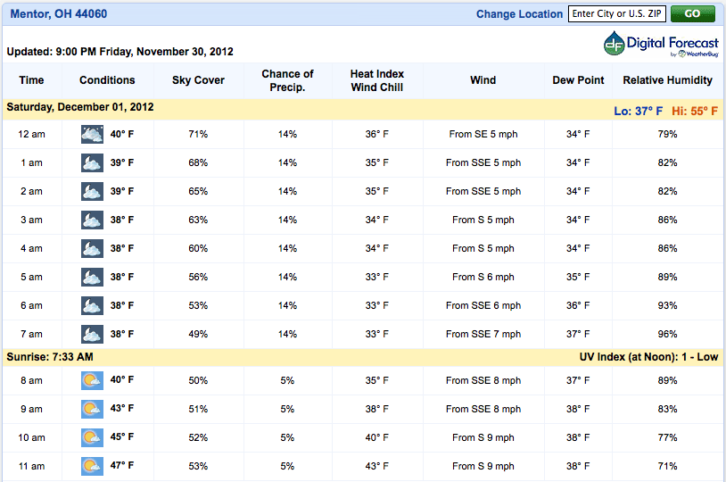

This is truly it. We won't have weather like this again for a LONG time:

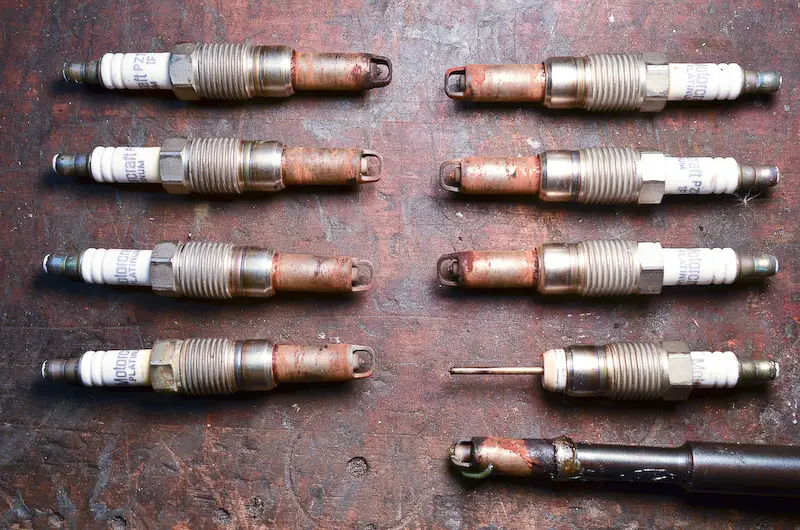

Unfortunately, you can learn from my mistake. I turned the power down on the wrench for the first plug... MISTAKE! Cranked the power and spun the other seven out no problem. Now I have to use the Lisle tool. $60.00 down the drain unless I can recoup a few bucks selling it on Ebay.

Shot some grease down in the hole of the porcelain to help prevent ceramic chips from going in the cylinder during removal.

After discovering the removal of spark plugs from the Ford Triton 3 Valve Engines often results in leaving part of the plug behind in the head, I found SR Master Tech's unorthodox method for successfully removing the plugs without incident. His video is titled, "Ford 5.4 Liter 3 Valve Spark Plug Removal"
God bless him for not only finding this method, but for taking the trouble to video the procedure and upload it.
This is my video of the procedure using a 1/2" Craftsman Model# 19986. This is the third video showing plugs one through four being removed. The first video shows plug number five failing on the removal. I foolishly backed off on the power for the impact wrench, thinking it may be too high, since it's 1/2" instead of 3/8". BIG MISTAKE! I cranked up the power and removed the last seven without a hitch. For reference, my compressor was set to 125 pounds and the wrench was dialed to the top notch.
Also, thanks a million to the engineers who created the "Lisle (LIS65600) Broken Spark Plug Remover for Ford Triton 3 Valve Engines". That tool is worth every penny (about $60.00 on Amazon) and then some!
