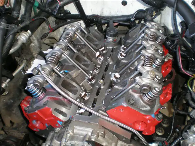

Look at the pretty pictures!!!...
The red vacuum line goes to the fuel damper on the fuel rail, not a fuel pressure regulator...Model year 1999 and newer did not have a fuel pressure regulator on the fuel rail...it is in the fuel tank...
Hopefully your red vacuum line still has the rubber fittings on it...One side goes to the fuel damper and the other side goes to the vacuum canister on the passenger side...See the picture for the line...Look in the upper left side of the picture...You will see the vacuum line routing and the branch that it is connected...
Now to the intake gasket question; You changed the lower and upper gaskets on the intake? Did you mean the lower intake gaskets or just the lower gasket between the fuel manifold and the upper intake?
I ask because you said you didn't do the passenger valve cover which has to come off to remove the lower intake...I suspect the lower intake stayed in place and the plenum[upper intake] and the fuel manifold were removed and the gaskets between them removed and replaced...
When you replaced the gaskets, did you torque the bolts evenly and clean the mating surfaces well? I would recommend also checking the fuel pressure at the test port for proper level...It should be anywhere from 55-72 psi..
And how long ago did you change the fuel filter? I would suspect a rought idle in gear due to a vacuum leak, a clogged fuel filter, and/or fuel leak due to the injectors not being sealed by the fuel manifold...
