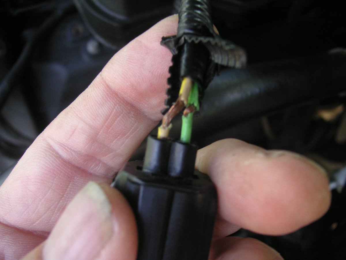

- Checked the ground and power to purge valve and EGR, no issues.
- Checked wiring to purge valve and EGR and did not find any broken wires or chaffing.
