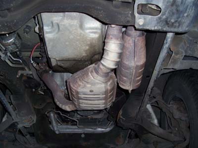

Arrived at 7:50 with no data-logs (since the LiveWire doesn't support pass-thru logging, yet) and when they opened I had a good chat with 3 of the techs. We decided the factory set up was a nightmare, we wanted to get rid of the bastardized factory 1/2 flange and 1/2 slip fit system and that the ideal pipe was in fact 2.25" in, 2.5" out for my goals/desires. The factory system appeared to be in good shape, but it lacked the tone and flow I needed for this project. The Wife's only stipulation: exit behind the tire, not the rear. OK!
Here it is on the lift:
Here it is removed:
The factory muffler was actually leaking at the top slip-fit connection, but no one knew until it was out. This is one reason I wanted a fully welded/flanged system! Next was the factory piping itself, it was a pressed/formed system, not crimp bent, but not a traditional mandrel bend either. Other than the 2" OD size, it wouldn't be bad looking/performing once the muffler and resonator were replaced/removed, respectively. The bends were relatively smooth, sans a slight creasing at the apex of the inside bend.
Once we agreed on an overall design, the subject of mufflers came up. I originally wanted the Series 70 FlowMaster, but, they told me the FlowMaster had the highest backpressure of all the mufflers they sold due to the baffles. Since they got so many requests for them, they installed them. Hmmmmm.......
I want quiet and low backpressure, so they recommended the largest MagnaFlow they stocked, a 22", 5"x11" oval case (P/N: 14580), reversible 2.25" dual/2.5" single. Lifetime warranty and no additional cost (list $220!!!!) over the FlowMaster quote. The 2.5" tailpipe follows the factory path, but the final turn once it passes through the leaf spring/frame area is eliminated to point it ~45* down just behind the tire. The 2.5" pipe looks HUGE compared to the 2" stretched ID that the factory used.

The install was without incident (except for the "company break" from 10am to 10:30, :confused: ).
The finished product?
See for yourself:
Cost: $395 (add $150 for stainless, but it's not needed here). Before you say ANYTHING, figure in the fact that this is a one-off, mandrel bent system from the only place in the state with the proper equipment/skills, it was designed on site, features the use of all factory hangers, heat shields, has a lifetime muffler/lifetime materials/workmanship warrantee and is fully welded (no clamps). Kinda makes a $295 "you-install-it" cat-back look like a rip-off! The best I could do locally was a generic "turbo" muffler and 3" crimp bent out the back for $250.
Time: 3hrs (would have been 2.5 if it wasn't for that darn break! :D )
Sound: OMFGBBQR0X0R11!!!! In English: 100% dead-on, as requested. Nice throaty rumble at idle that is barely noticeable, until you blip the throttle. Barely audible at cruise with the radio off and windows up. NO droning at freeway speeds and it has a slightly subdued "roar" at WOT. The wife likes it, so all is good...
Performance: Not sure on the "butt-dyno", probably more placebo-effect than anything, but the fuel trims NEVER lie. .84 STFT's suggest there was a real improvement that requires some learning and possibly a tune [I ran without a tune for better before/after results].
