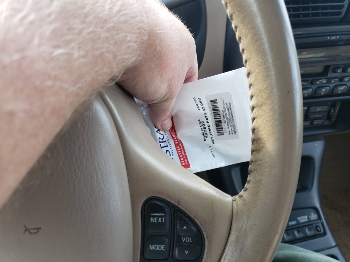

ReKey Ignition and doors to match
I was given one key - going to use FORscan to edit once "S" (40bit keys) arrive.

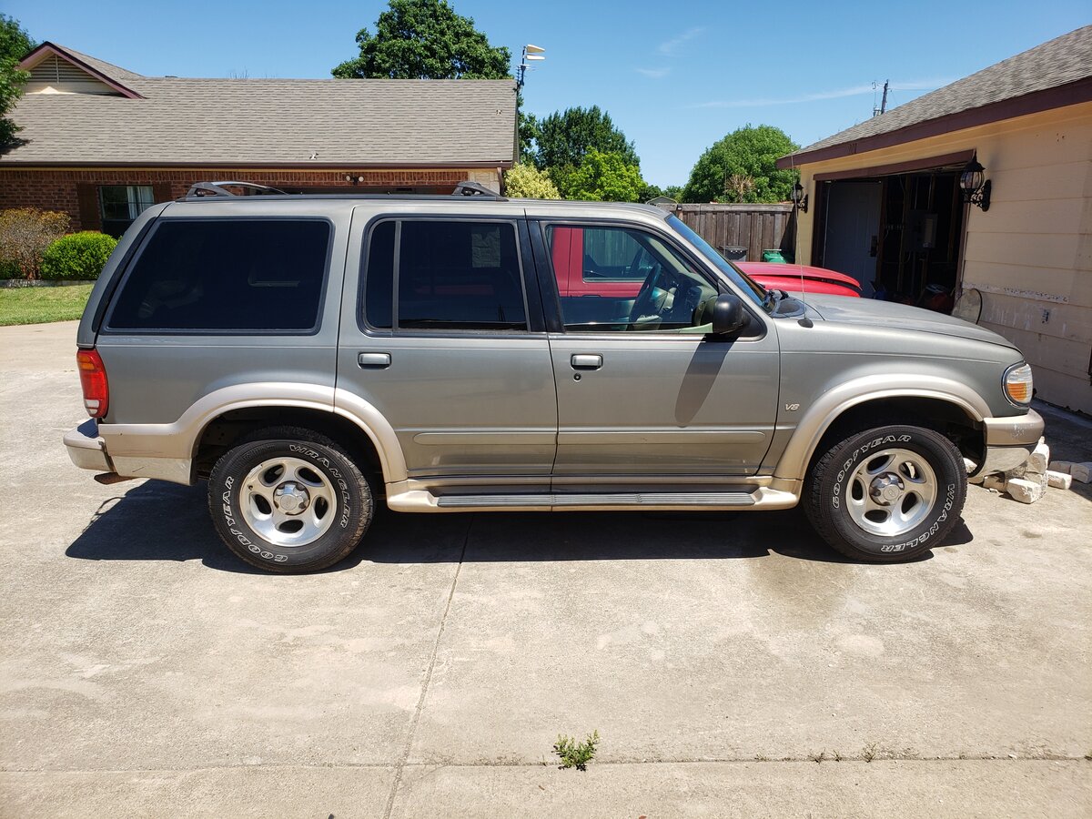

Donor:
2000 Explorer Eddie Bauer - Copart $675 Salvage Title, drove from Macon, GA to DFW after pulling the bumper/liner off the right front tire.

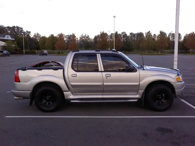

Patient:
2005 Ford Explorer Sport Trac Adrenalin

That looks like a sweet deal for 675.
