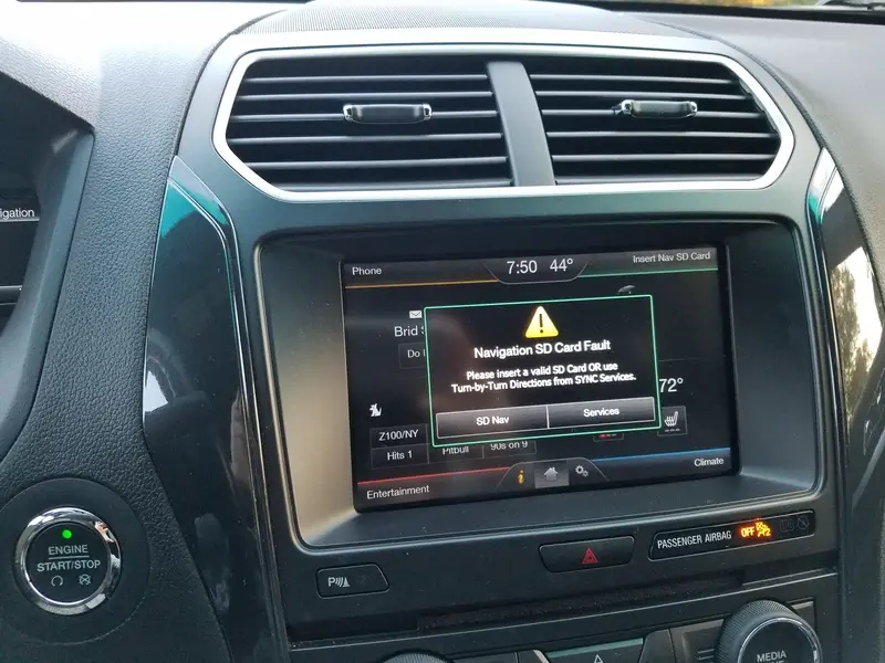

I can describe how the video would be....
noise from road
warning chime
This picture shows up
At this moment you would here some words on the background expressing frustration:
"Again, this POS" Ford doesn't have a solution" Worst vehicle ever" " Don't buy a Ford"
simultaneously a finger moves and click the screen to get out
A few more words of frustration and video would get jumpy and end so we can use the cell phone and go into Google Maps.
end of video
It has been in dealer 2 times for this,battery disconnect and Master reset. Dealer cannot replicate, we get this every day. Reinserting the card worked a couple of times, restarting the vehicle worked a couple of times....
