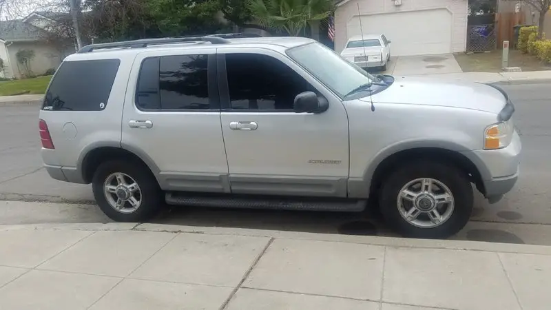

Hello just bought my first car and glad it's Ford, had 261,000 miles on it , got it for $1,200 tagged running but it didn't pass smog so I had to fix the EGR , then last year on December I took it to the shop for a tune up , motor craft Sparks , new wires , oil, coolant , fuel filter , air filter ,
Early January the car would turn on but shut off after 3 seconds or didn't want to start turns out it was the mass air flow sensor. The SUV in parked and not moving it would shut. Down this was rare but I hope that mass air flow sensor was the issue so far drives good and doesn't shut off. Any recommendations on term's or replacing parts to get it to near good condition long term driving (hopefully) would like a timeline for multiple replacements or even upgrades. Please note I'm a DJ and I put all my DJ equipment in the explorer,

Agree MrQ nailed it. Looks like a clean vehicle. No rust?
