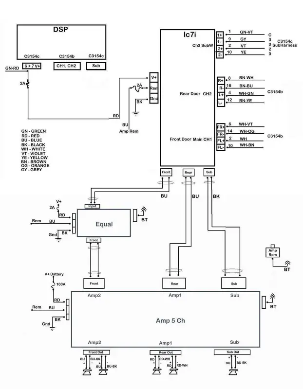

Ok, here is what I did in my 2018 Limited with the Sony:
The front center and two rear 3.5 in speakers and the door tweeters remain driven by the stock Sony amp.
I used a 5 channel amp for the 4 Door speakers and the subwoofer.
The door tweeters can either be driven off the lower door speakers via crossover or keep them hooked up to the stock Sony amp. Tweeters don't need much power.
Most important is a big box of Dynamat Extreme or the doors and subwoofer will rattle like crazy.
Rockford Fosgate T1675 6.75in Components – Front Doors (Metra 82-5603 adapters)
Rockford Fosgate T1650 6.5in – Rear Doors (American Int NSP710 adapter)
Kenwood KFC835C 3.5in – Front Center, Rear Pillars
Pioneer TS-SW2002D2 8in shallow Subwoofer
AudioControl LC7i Converter
Kicker KXA800.5 Amplifier
Axxera BEW25BT Smart Equalizer
Fritz
Just curious, But why are you only using the EQ on the frt channel, and not both the front and rears? Limitations of the EQ?
Yes, the EQ only has two channels. Rear door speakers are only for fill and soundstage movement anyway, main audio comes from the front doors. Adjust the rears with the radio and amp eq, then the fronts with the fancy eq.
The radio EQ still works so I can tweak the tweeter loudness after matching it with the new amp gain.
The two rear rear speakers never put out much audio before the upgrades and are a bit louder now.
The new front center speaker is very loud. I even had to install some foam over the speaker to quiet it down or it would overpower and pull the audio to the front middle.
The sub has polyfill on the inside and two layers of Dynamat on the outside. It is "acceptable" for a 8in tiny sub. A 10 or 12in would match the interior car volume much better. Too cheap to rebuilt a new enclosure.
The Sony amp has two sub outputs, one for each voicecoil in the sub. I simply ran the wire harness disconnected from the old sub into the lc7I. Four wires, four inputs. New amp has one output for the sub. New sub is wired for 1 ohm in parallel.

The lc7i fits underneath the Sony Amp / DSP.
The Kicker amp is under the Pax seat and the EQ velcroed on top.
The original center speaker had a bandpass capacitor installed and a magnet the size of a quarter. The Kenwood 3.5 is full range and has a pound of magnet hanging on it. It didn't "overpower" the front door speakers but it would pull the sound stage forward and reduce the stereo separation. There is no way to reduce the volume of the center speaker only.
