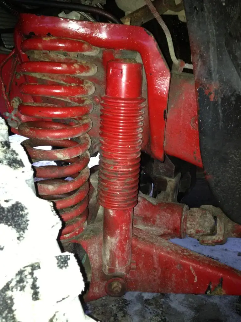

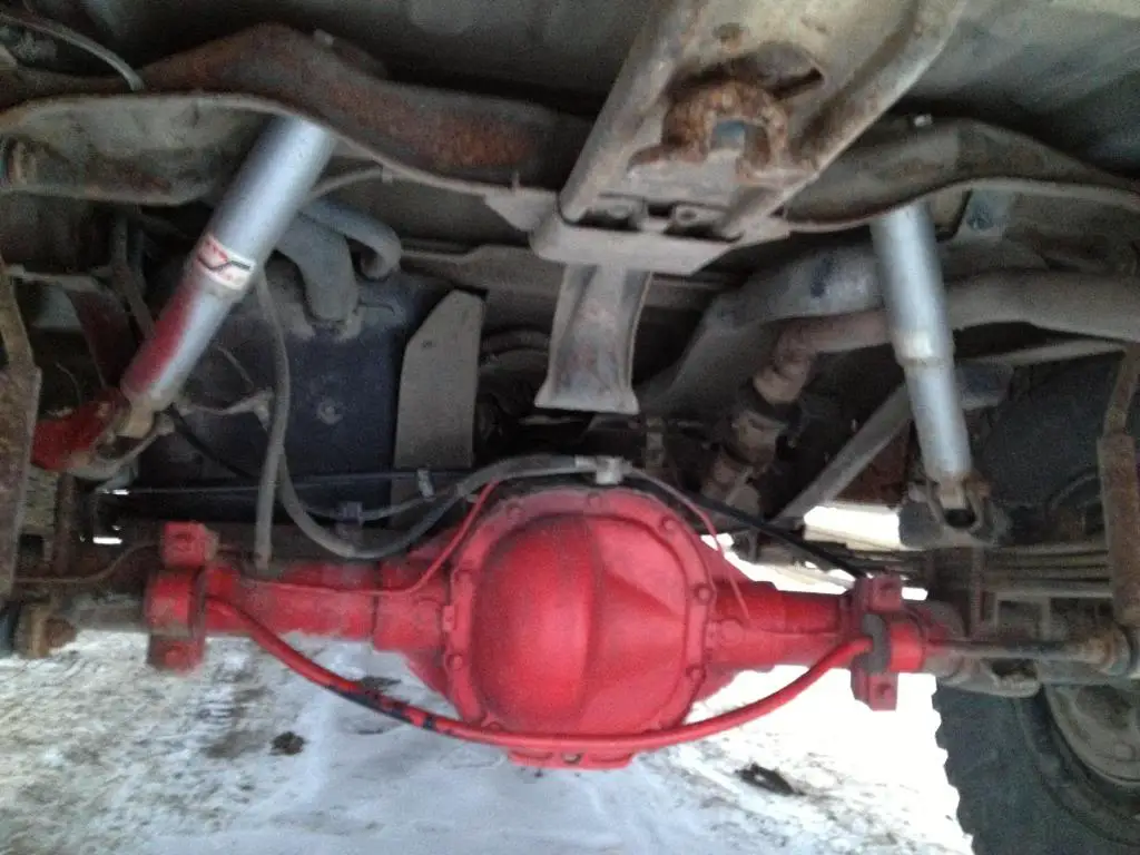

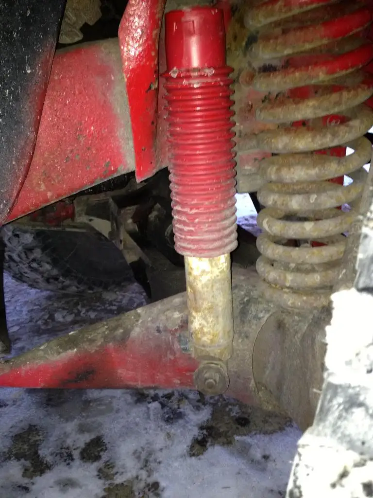

im looking for shocks for my truck, the rear shocks have kyb gr-2 and the front are painted over so i cant tell what shocks they are. in the rear its a soa and has a plate where the shock does up and the shocks in the front are longer than the back i ws told my truck has a 6 inch lift and auto part stores cant find any shocks can anyone point me in a good direction, also i fund somw skyjacker shock that are 44.38 per shock they say they fit but need options thanks

mine are mounted on a plate on the top of the leaf spring
Do you have any pictures?
here are some pictures of my shocks
I believe the rear is stock length.
And that red paint must be annoying.
i like the red on my truck but who ever painted it did a crappy job, im assuming they did it to help sell it because it nt the whole frame thats painted
i need help with the front though will any explorer 3-6 inch lift shocks fit the front? or will i run into issues down the road with them?
