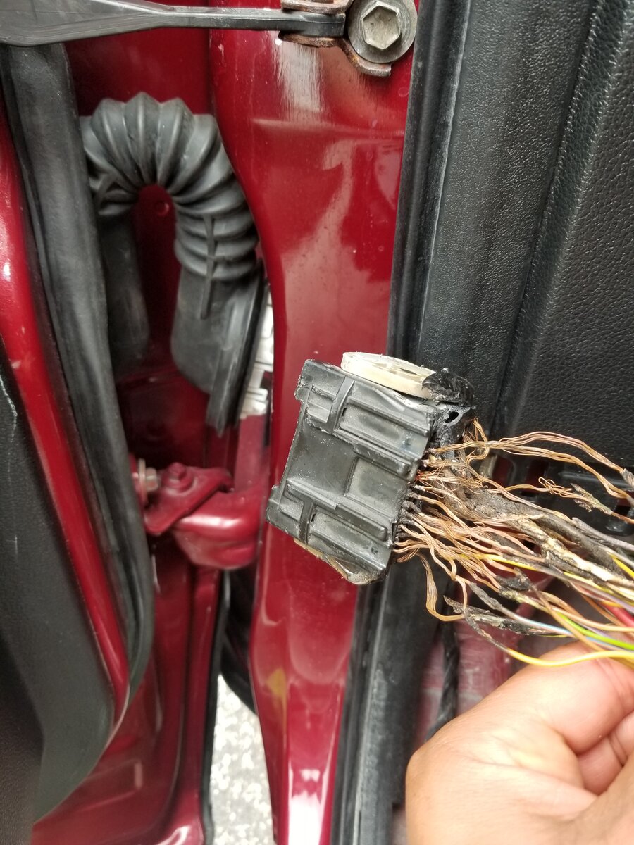

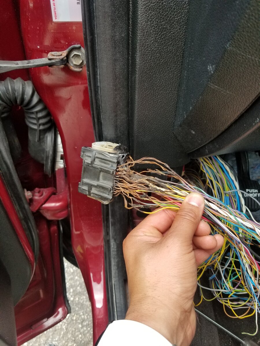

I have a 2017 ford explorer xlt and doing some body work on the driver side door the guy hit the wire harness that connect to the driver door jumper connector and melted the connector that came from the dashboard instrument panel wire. I found another plug from a donor ford explorer but the wires are not same color code, so since the wires from the connector coming from the inside of the car melted i dont know wich colors go with so I need the pinout color code for the connector that came from the inside to the driver door.

So far I found that its belong to the dashboard wire harness and the part number its HB5T 14401 AHG, so I need the driver door pinout of that harness in order to find out wich color goes into the pin socket
You might be able to pop the door side of the plug off and see?
Yes but that's not the issue I need the pinout of the harness coming out the inside of the explorer

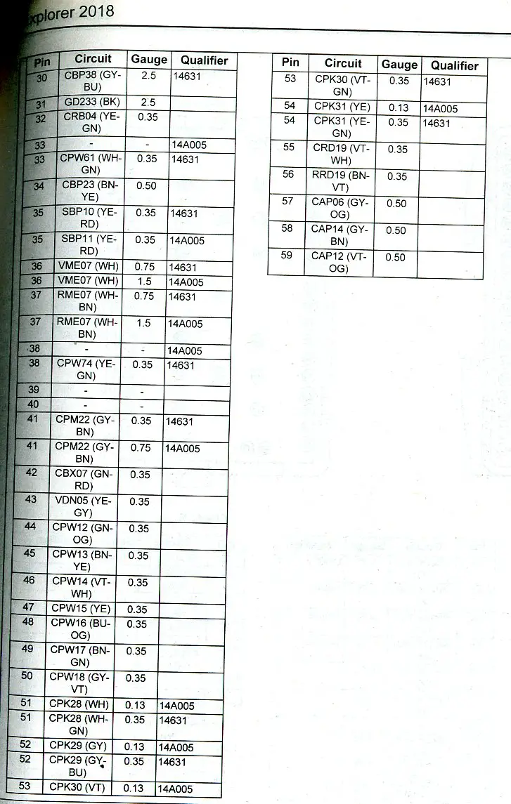

This is for an 18 but it might be the same.
Do you mean you need the pins AND what each wire does? I have the wiring guide for the 2018's...
