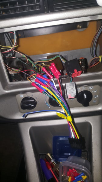

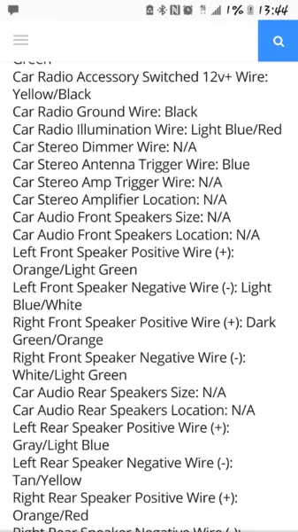

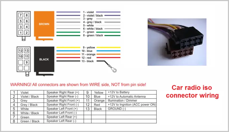

I bought my daughter a new stereo for Christmas, I started to install it yesterday and I cannot figure out which wire is the power wire. The wiring diagrams I found online say it's light green but that color isn't an option. Also, there's a total of (3) wiring harnesses that plugged in to the stock unit. Do the other (2) just not get used with the new unit? Thanks in advance for any help you guys could provide.
