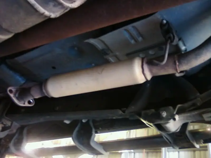

here are some pics to prove that it happened.
Here is the nasty glasspack. I think I want a flowmaster in there, but that thing has to go!
and this is the finished product. They had a new guy workin on it so the welds look like crap in a handbasket, but they'll hold. :rolleyes: I've seen some fantastic work roll out of that shop, but this is just ok.

and the performance is pretty good. seat of the pants feels about the same, but my throttle response is awesome! quick tight revs and (except for that glasspak) a smooth deep sound. the glasspack kinda sounds like when you put your lips loosely together and make a "ppttptpttpp" sound. I hate it.

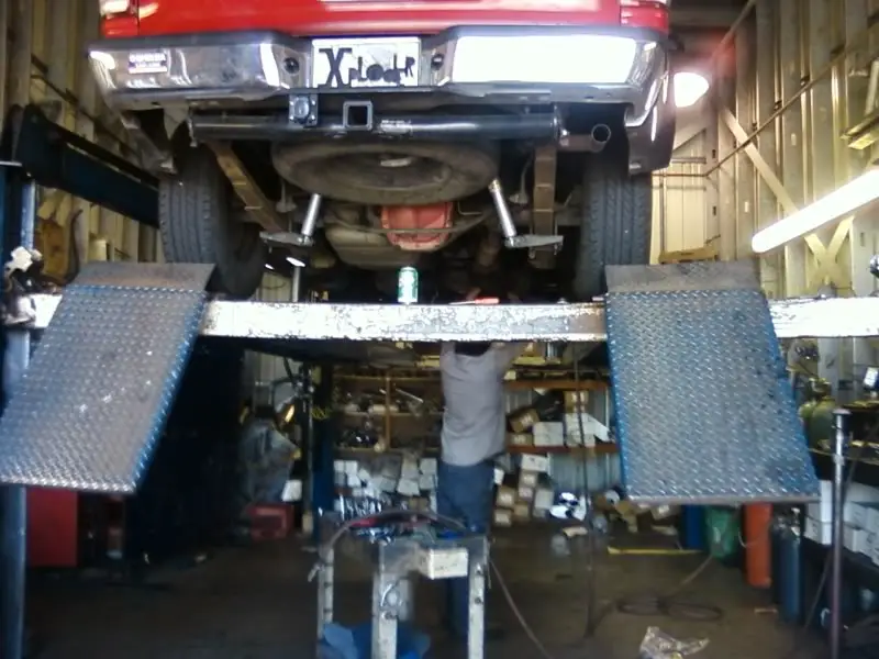

just for kicks and giggles, this is me workin on that Blazer.
I don't like working of chevys. it's even hard to get jackstands under them!!!
