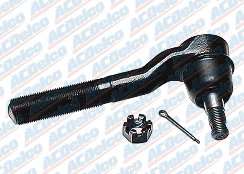

well actually removing the tierod end from the draglink isnt that difficult. I believe the tie-rod end comes with a threaded rod that you use use to replace the existing peice? You just unscrew the old one and screw the new one in...
its seperating the tie-rod end from the knuckle, or from the centerlink, that's a PAIN in the ARSE!
attachment.php
that is what im talking about...

It will thread right out the adjusting sleeve no problem
getting the tierod out of the knuckle... whew different story. that Fork tool will come in handy. otherwise a pry bar and a BFH will do the trick.
Once you get the castle nut off, flip it upside-down and thread it back on the stud until its flush with the tip of the stud. Hammer the crap out of it. That should budge it.
They dont sell those castle nuts at Lowes or homedepot (eheh i looked) so becareful you DO have it upside-down before you smack the crap out of it.
