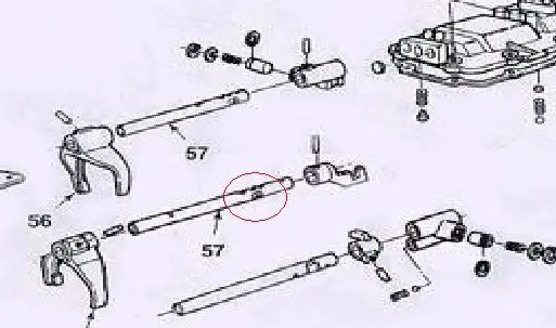

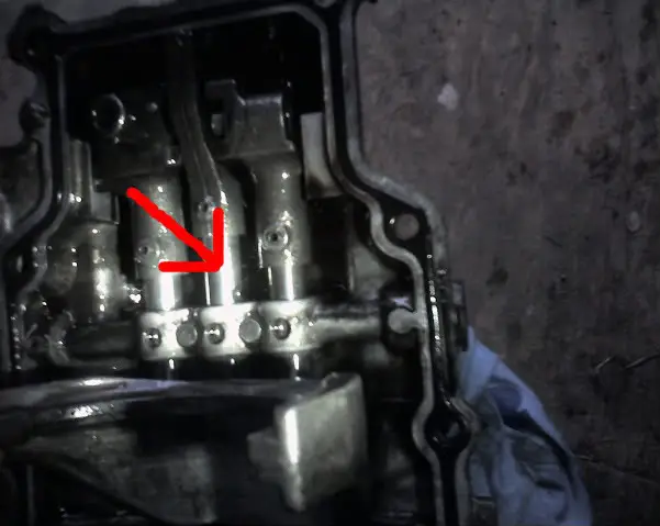

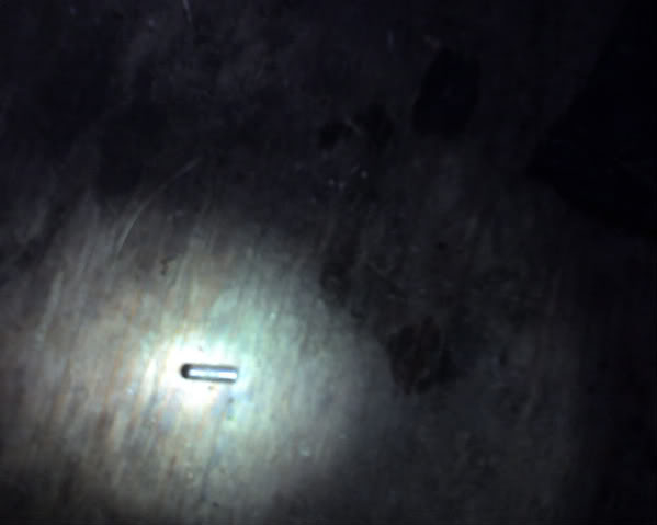

So... I followed write ups how to remove the transmission and finally get the top end removed. I found the culprit. A pin sticking half out of a shift fork rail binding the shift fork enough to not allow it to shift out to any other gear.
circled in red is where the pin came from
said pin
