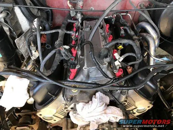

Every one of the old EV6 connectors broke when I removed them, the locking tabs. I ordered some EV1 type injectors connectors. I got some plugs that are one heat range cooler to install.............................much left to complete but not that far to go!!!!!
Progress:

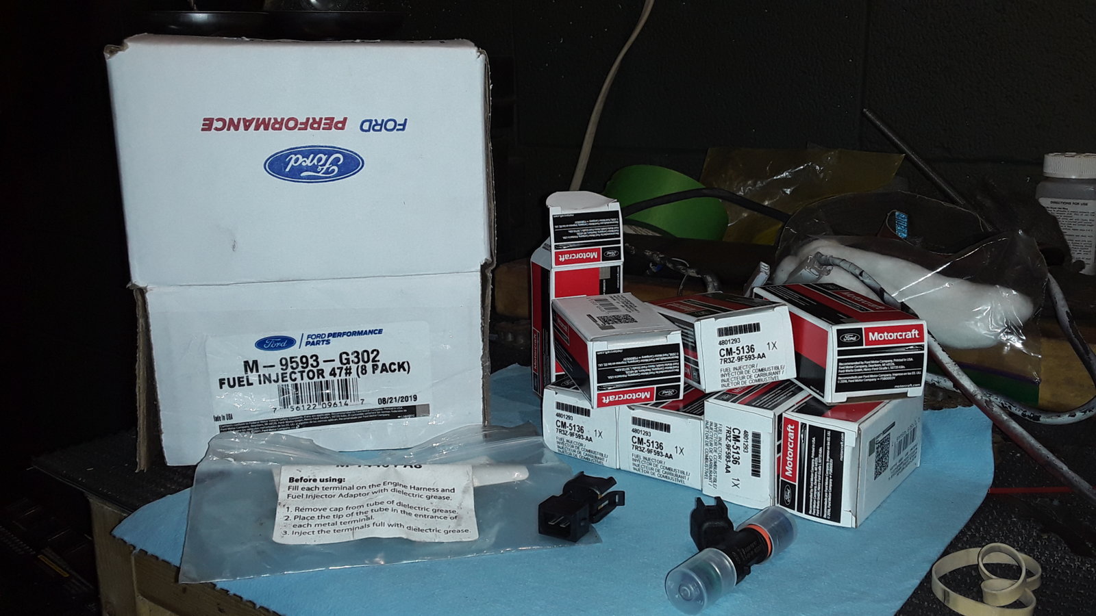

Where did you get the injectors and what size?
I am running a 90mm Lightning MAF and 42lb injectors. I got the injectors off ebay, rebuilt and flow matched.
TLF Performance Parts
Beware the Chinese Bosch knock-offs. I really don't know about them, but wouldn't trust them with my build, they're cheap.
I got 8 ford racing 47lb injectors just sitting here useless lol
Someone will want em
Poop, missed that, sorry. I was going to run 30's which would be enough, but I am likely to add more boost than 30 could provide for........
If you want em their yours 8 NEW injectors and the wire harness adapters
I'll take a loss and sell cheep I have no use for them lol
Just pm me

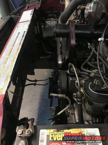

Had to fight past PATS and bad plug wires. Started break-in and once I got her up to 3,500RPM the blower belt went. The pulley has enough of a wobble that it ate the belt! I have ordered another pulley and need to get with a machine shop..................................It was running great!
I suppose that's one heat cycle and I can tighten header bolts. I cut down the coil pack bracket to fit under the blower snout bolted down to the stock places.
I got the radiator pulled so I can get to the crank pulley.

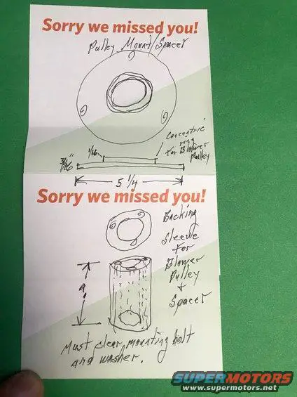

My thoughts are to have the face of the crank pulley turned down enough to make it flat/90 degrees to the crank, cut a spacer to fit it with concentric to fit the blower pulley. Then I will mount the Supercharger pulley and spacer as I had previously.
The crank pulley face will be turned down enough to make it flat/90 degrees to the crank and a good flat mounting surface. They will cut a spacer to fit it with concentric to fit the blower pulley and then cut a sleeve to support the spacer/supercharger pulley. This is what we came-up with at the machine shop to mount the supercharger pulley to the crank pulley/balancer:
This is my effort, brought it back so you can see the mounting bolts:
The plan sounds good
