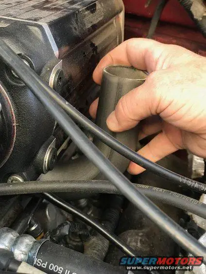

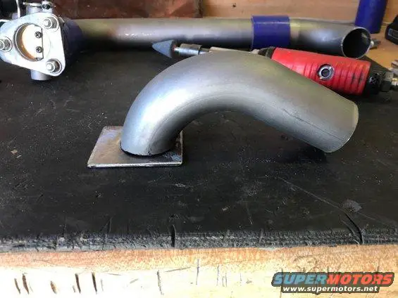

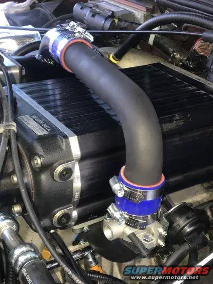

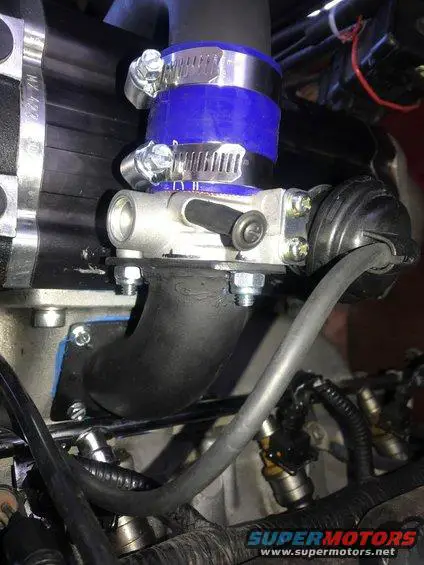

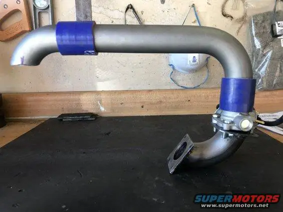

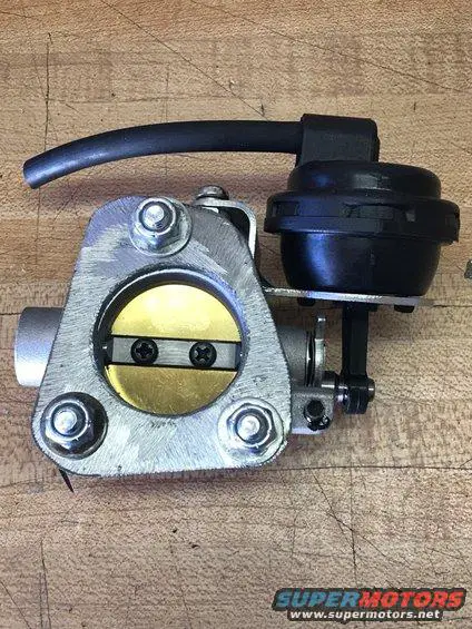

I finally got around to fabbing a bypass for this old Kenne Bell. I ordered some bent 1 5/8" tubing to fab headers from and had at it. I am going to drill the manifold and intake pipe this weekend and install the bypass. I'll get a few pics and post again.
This build is minty
4X2 hours (with my son) to complete the bypass:
I thought I would share Speedway Motors for great pricing exhaust stuff. I ordered this tubing from them for the supercharger bypass valve and wish I had thought of them for the tail pipe. Combo Exhaust Pipe Mandrel Bend/Header Tubing, Mild Steel, 1-5/8"
