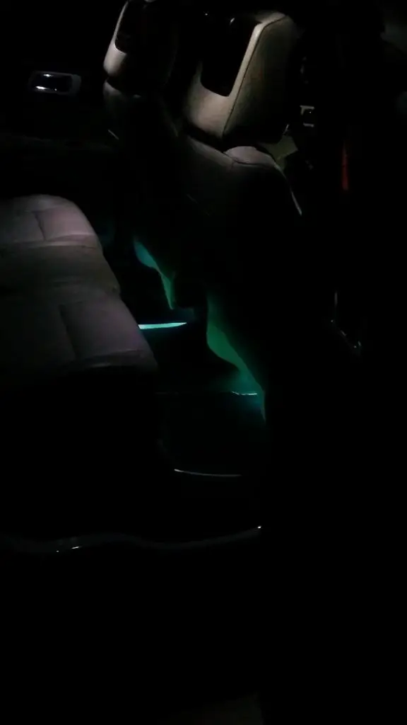

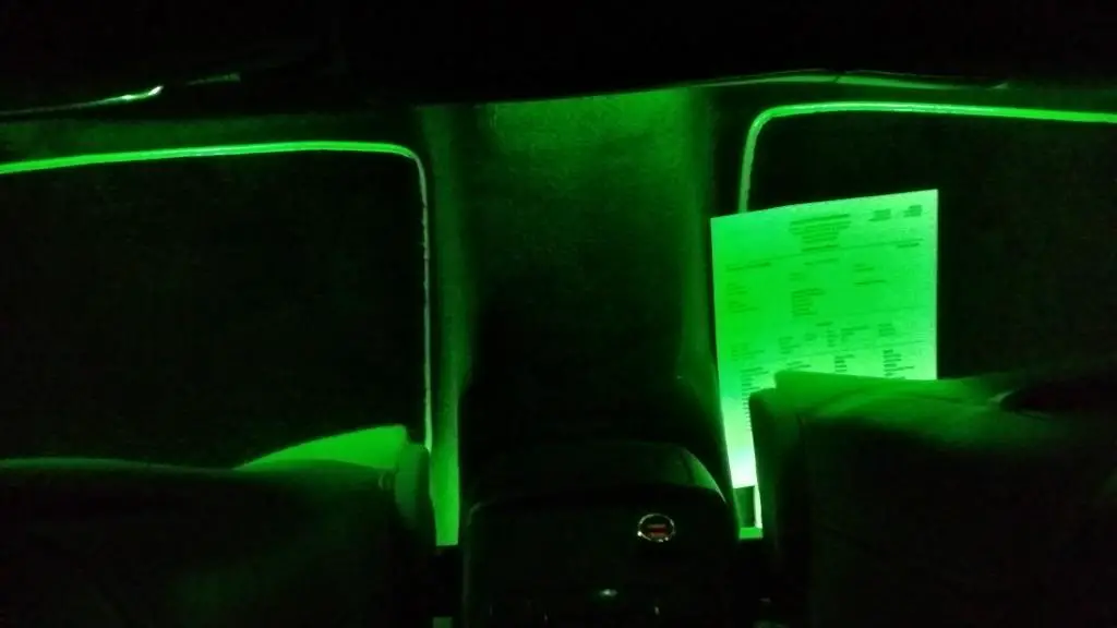

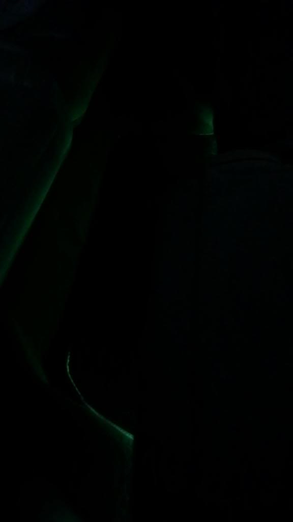

I ordered these around x-mas and installed in about an hour. The box has two entry points for the wires that goes to the lights, so in my case I decided to pull one set under the driver scuff plate to the rear, and for the other I went behind the middle button console to come out under the glove box, and then the same thing there, under the scuff plate to the rear. So each footwell (4 in total, I decided not to do the last two seats as I almost never use them) has lights.
They come with a control box that specifically has a setting to power up with the last used color preset already set, which is what you'd want if you want custom controlled colored lights (these are controlled with a remote, for factory Sync-controlled colors you'd have to get the original Ford kit).
The light output from those is pretty good. I can take a pic later if you'd like. Definitely enough to give it an ambient feel and to see what you may have dropped on the floor :)
I used the dome-light wire as my power wire for the control box, that way they're on when the dome lights are on (doors are open, etc) but off when I drive. The wire for that is in the driver side A-pillar harness (don't recall color right now, but it's easy to find out with a power tester).
The remote works without a problem despite the control box being hidden behind a bunch of panels.
Edit: The review that the doublesided tape is useless is correct. I attached all of mine with zip-ties, and on the driver side I drilled two small holes in a cover to make that work as there was no better way to attach them there that I could find.
