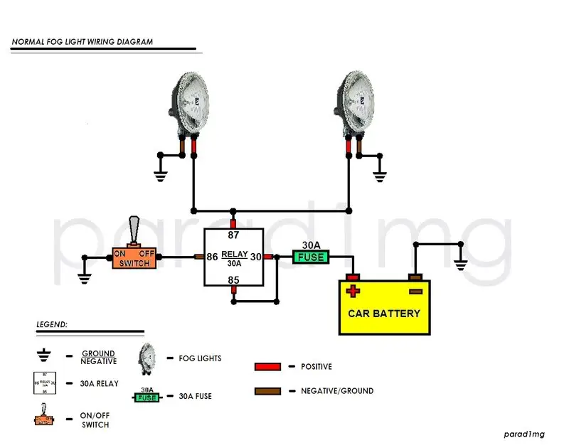

1a. I bought two Hella 500's with 55w bulbs, I'm assuming I can use the stock fog light wires? Connect positive to positive, ground to ground?
1b. How do you get the air box (houses the air filter) out of a 1996 V6? I understand the two little rings that it pops out of at the bottom, but theres a plastic scew of some sort, no clue how to explain it, attaching it to the inside fender, it's tough as crap to pull out, am I doing it right just by yanking it? I'm about to take a pair of pliers to it and ripping it out.
2. I've read all the posts about wiring your fog lights to be able to switch on and off with just the parking lights on. To anyone who has already done this... My understanding is (on my '96) I cut through the Dark Blue / Light Green wire, connect a 12 guage wire to it, annnd where do I find the brown wire coming out of the parking lamp assembly that I need to splice into? Might just be me... But it's no where to be found for me.
