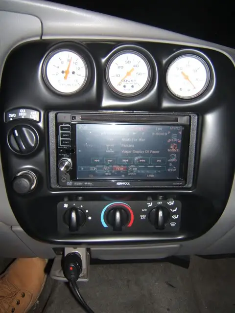

I painted mine with Krylon gloss black, then low-gloss clear. It looks very close to the original, without the rubber texture. I've heard Plasti-dip spray is close to stock and will give you the same rubber texture, but I havent tried it yet.

Amazing...So you know I have to ask where you got that radio bezel...
That looks factory...amazing:eek:

Thanks, I made it. I cut up a stock radio bezel and a cheap Ebay gauge pod and 'glassed them together.
Check my 4bt swap thread below (starting on page 2, post 31), I have a few pics of me building it.

Still up in the air on matching my paint. Never heard of low gloss clear. Does that tone down the glossy Krylon? Or am I just using the wrong paint.

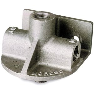

Here's the one I bought from JEGS. http://www.jegs.com/i/Moroso/710/23710/10002/-1
It has the sensor port on top already. If I remember correctly the sensor comes with the adapter for the port.
Found this on Amazon. I shop there alot. Came to about $10 cheaper then Jegs but not sure about the adapter.I should be able to get any fittings locally here so no big deal.
Are you running a full size filter on your truck ?

Any fittings can be had at home depot or lowes. And yes, full size filter. Same one as the oil filter. Whatever lists for v6 sohc, can't remember the number right now. (Fram ph8? NAPA 1515 maybe?) That is the right one. You can get the adapter at the depot as well.
The V-8 has a smaller then average oil filter due to space issues. Thats why I was asking. Guess I shouldnt sweat the small stuff.

There's no such thing as beyond your abilities, Its just something you havent done yet.
Yes, low gloss clear is...well, clear that isnt as glossy. Clear coat is just to protect the base coat. It can be glossy, satin, flat, etc. There's no rule that says clear has to be glossy.
Let me check and see exactly what they called it, It might be satin or low-gloss. I check when i get home.

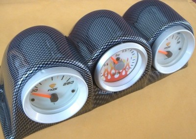

just installed my pod and guages today hope this helps anyone searching

werr can i get a radio bezel like yours with the gauge pod were the vents were. i have been wanting to do this for a long time,,please help...thank's kelly:rangergreen:
You cant get one... You have to make it like I did.
