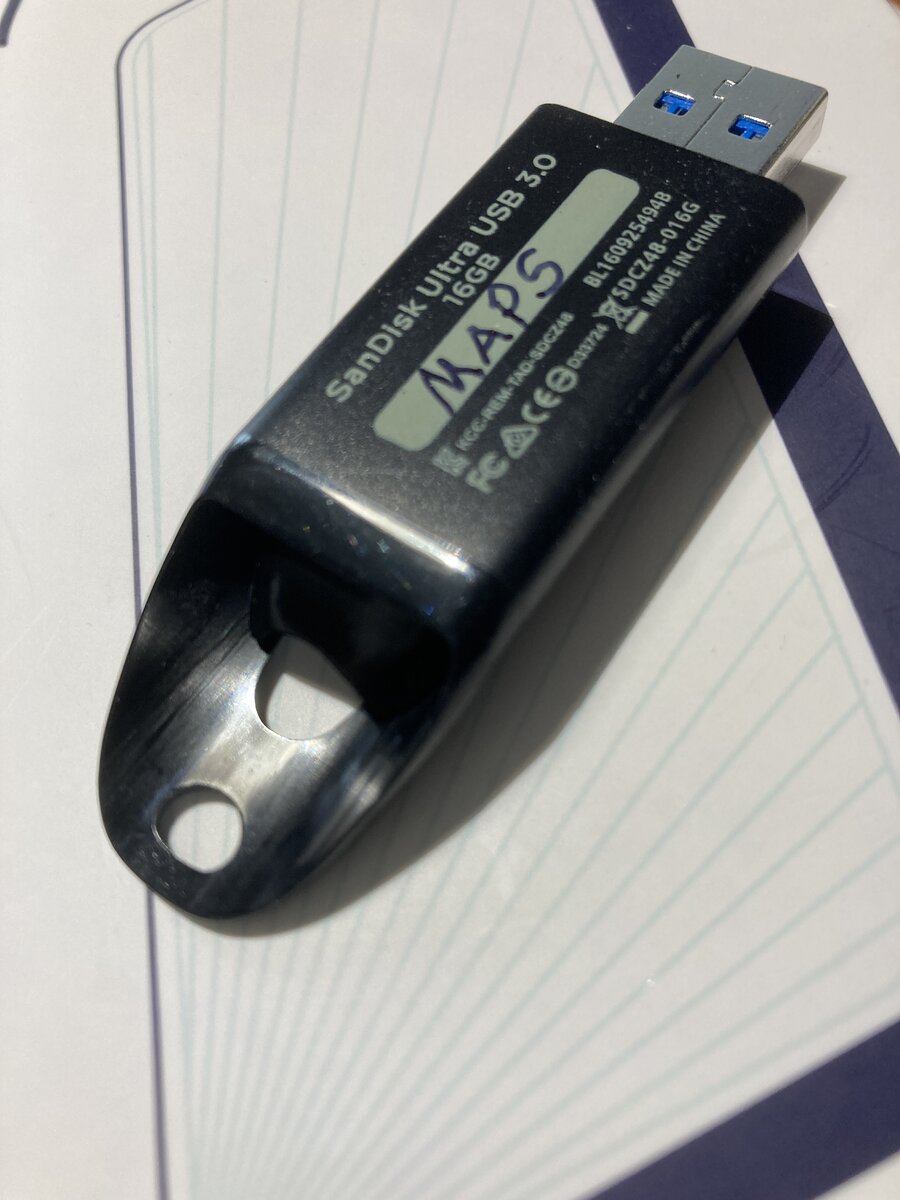

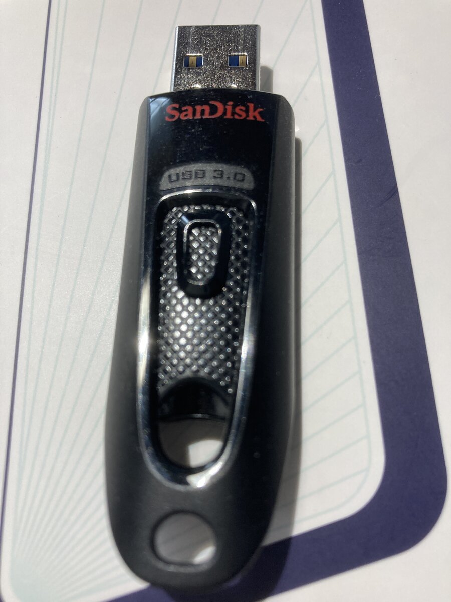

I did my map update on September 15th using a 16GB USB 3.0 SanDisk Ultra drive. I downloaded and extracted the files using my PC hard drive, then copied everything to the 16GB drive.
View attachment 435366 View attachment 435368
