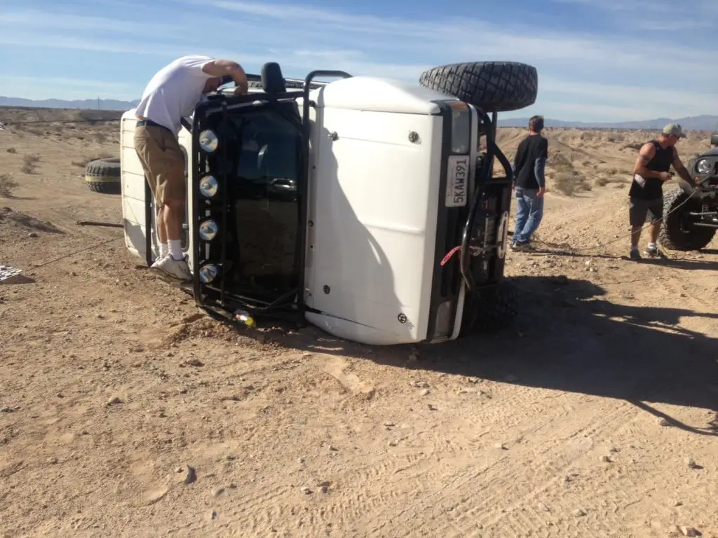

We rolled (Up a hill)
We had a little incident this last weekend at Truck Haven. I talked my wife into taking the wheel while the the kids and I video taped. She made a mistake while going up a hill and didn't realize the trail turned at the top. She went strait (which was going back down the other side). I yelled "LEFT"...she turned left alright with full throttle. We traversed the side of the hill, hitting rutted trails that were there until we finally rolled on the passenger side. No one was hurt, and I never realized my wife had the monster truck right foot. I was proud of her to give it gas and try and save it.
We tipped it back on its wheels and it fired right up. We continued on our day 4x4 trip. This time with the wife in the passenger seat.

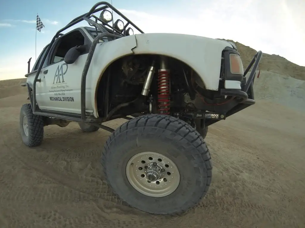

Progress photos
Here are a few progress photos. My goal for the last few weeks has been to obtain more up travel. This means cutting off bump stops, notching frame, new track bar and mount, pitman arm, etc.
I was able to gain about 3" of additional up travel. My plan after the V8 is to lower the vehicle's CG.
