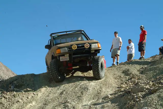

On another note, here is RangerX's rig in it's element before it got shipped to Kaui for that good life. :)

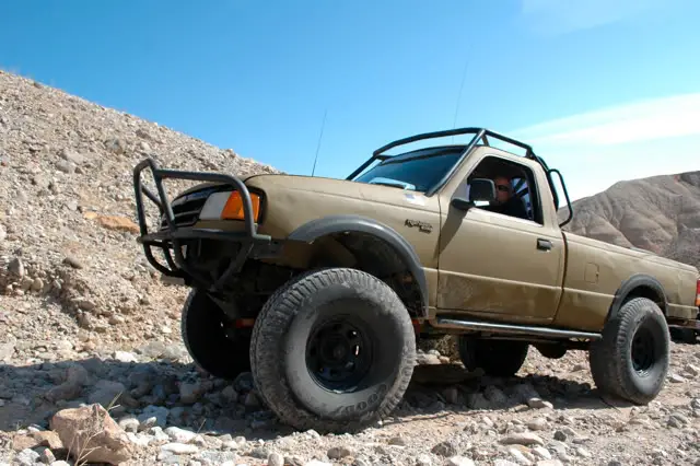

This one is with 37s on it.
