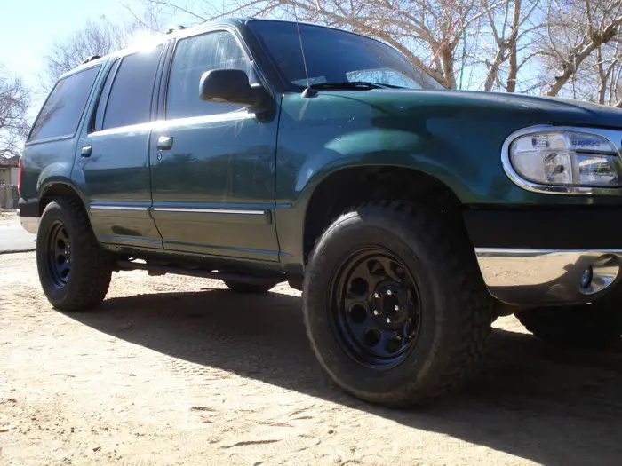

alright, i took lots of pics, but thats ok right? cause i know you all love pics:p:
it was a crapy day and i just sprayed off the truck, its soaking wet in these pics
TT And Shackles, 15x8" Pro Comp Rims, 32x11.50 BF Goodrich Mud Terrain T/a's
:D
dude that looks fresh, good job
so how much room do you have in the front when turning? is it real close or does it have some space?
well when i first put them on, i could only turn like 2 inches, but most of it was against the fender not the bumper, u know what i mean? i had to cut about a 2"x 4" hole. but it was just in the plastic fender insert, i didnt have to cut any medal! then on the front bumper i just cut about 1 inch off the side of the bumper. then i put one tire on a curb to make sure i wouldnt rub when i flexed, and it was fine, im about 1" 1/2 to 2" away from everything. took about 30 min. to do both sides.
