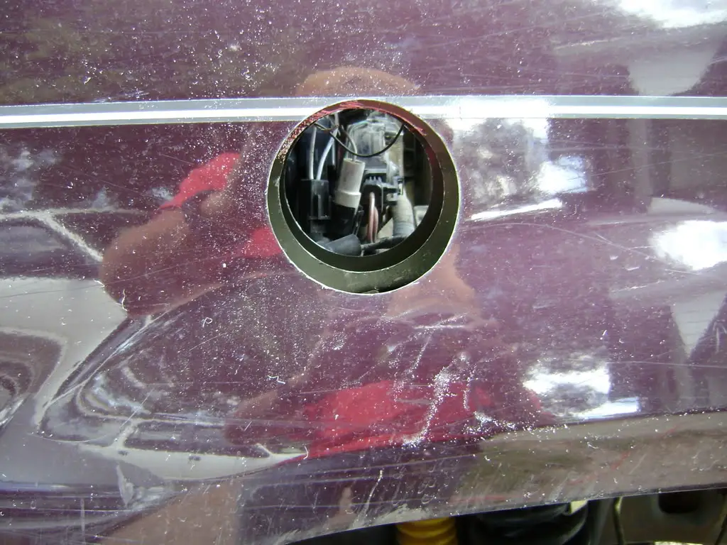

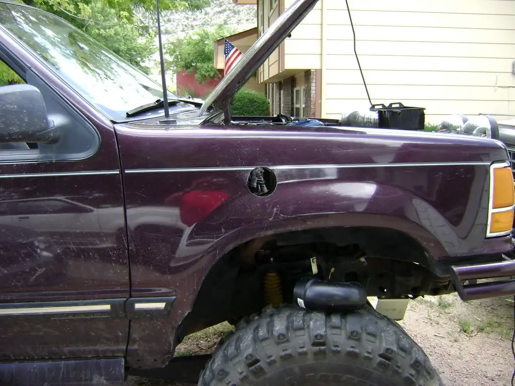

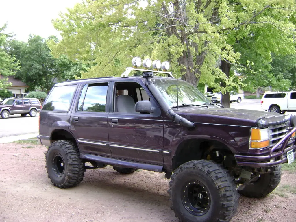

In my opinion the hardest part of installing a snorkel is cutting the 3 1/2" hole in a nice clean fender......
finished product.......
