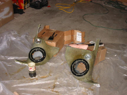

i have noticed a big difference in bass with my kicks....i also changed my speakers but with the midbass up at my face it offers better imaging...if you want to see my setup its under my name and it says system finaly done...and i'm very happy with my results

rjahr01 why dont u explain for me how your kicks improved yer imaging. ? i think u may just be throwing that term around loosely. U also have to remember that u upgraded to better components as well as moving the front stage into kickpanel enclosures.
Whats to say yer midbass improvement isnt a result of the speaker itself. Same goes for the front stage imaging.
U cant immediatly assume its the kickpanels that made this world of differance, as hard as it may be to accept that yer fiberglass pods cost more than the speakers themselves.
the obvious answer is to run a 6.5 in your door.... like me (i'm so special) and these for the speakers
also, i removed my rear fill since they were detracting as you said before. my 6.5s in the door definitely the source of midbass(very little comes or should come from the kickpanel) and i will say that this is the best set-up on paper. mid and tweeter on the floor imaged up and woofer in the door IS the way to do it in an x if you can. my doors are filled iwth mdf and sound deadening and i run 185 watts rms to each side of my components (it makes even my crappy audiobahn components sound unbelievable)

yes i did upgrade my speakers and that made the bass protrude more then it ever did in the front of my car yet at the same time the bass was coming at me and not just there...its hard to explain but with the kicks i can feel the bass up at my face where as when i had my old speakers mounted in my doors and speakers equal to mine now that i've heard in the doors the bass is just there but its not really so much of an impact as it is now...i think that might explain it...it does'nt really have anything to do with time difference...i still need time correction..
