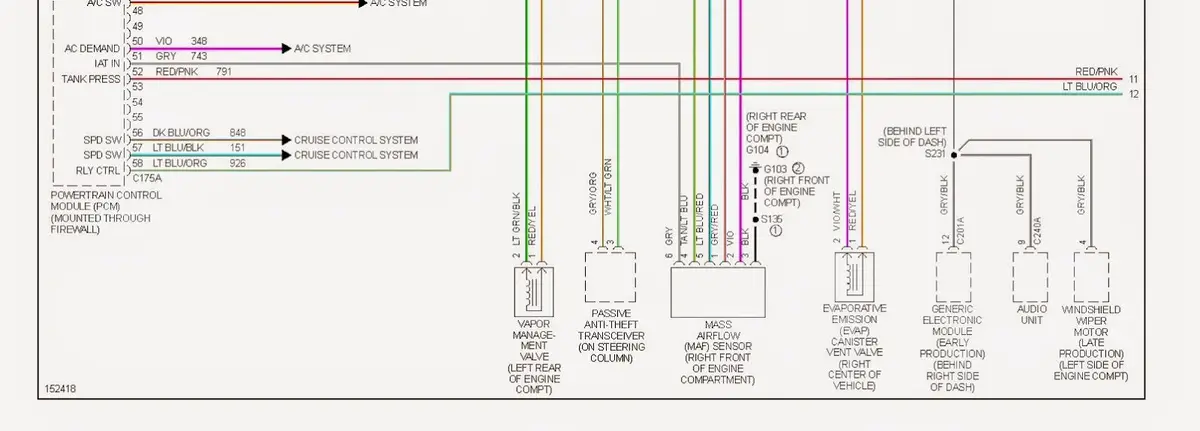

The wiring diagrams that I have show a 6 wire MAF with integrated IAT, so I'm not sure what you're cleaning.
FYI, this is the wiring diagram I have for an '02 w/ 4.0 SOHC showing the MAF/IAT lines
I believe you can measure the resistance across the Grey and Tan/Light Blue wires to check the IAT portion itself. I don't have a table of values for an '02 but an older one from a 1993 with a separate IAT is below. Maybe they're the same...I'm not sure. Find your ambient temperature on the table, measure the resistance across the sensor and it should match (relatively closely) what's on the table
