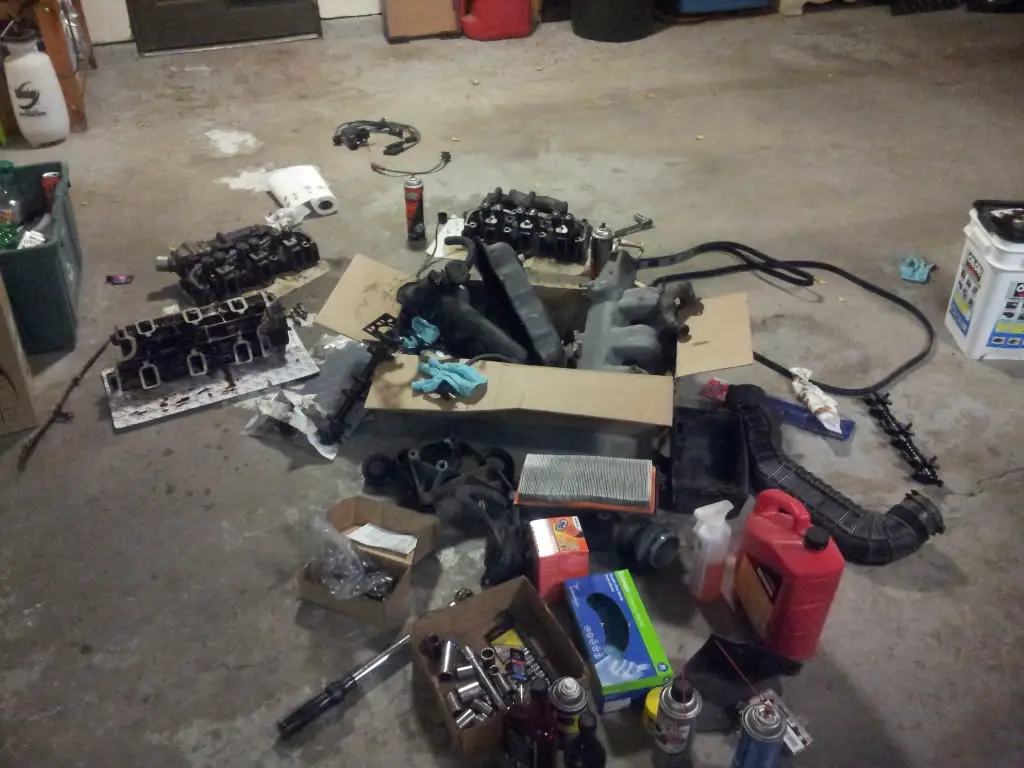

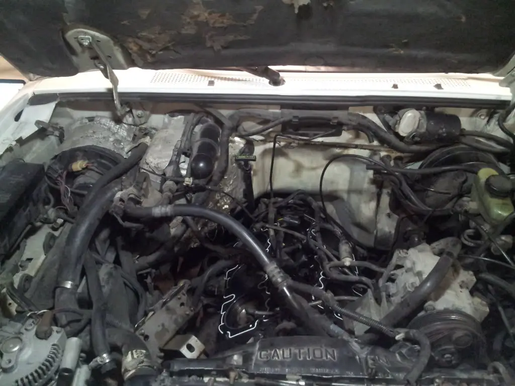

So the next weekend I went back to my parents to do the head gaskets and it wouldn't even start! I was getting a little worried, but my buddy and I pushed it into the garage and got tearing it down. I was just hoping that it would work once I got it fixed and that it wouldn't start because it had too much water in the cylinders.
Here's what it looked like when we started:
Heads out:
I read somewhere that it's better to just remove the exhaust from the header rather than the header from the head, so I went that route and ended up breaking 2 of the bolts trying to get them off, it was a huge pain to get them out of the header after that too! Took lots of prying, heat, and PB Blaster.
Parts pile:
After replacing ALL of that stuff, it started right up first try in maybe a second of cranking! :thumbsup: I'm pretty happy with the purchase now and have been driving it for a week now and will do the fuel sending unit tomorrow.

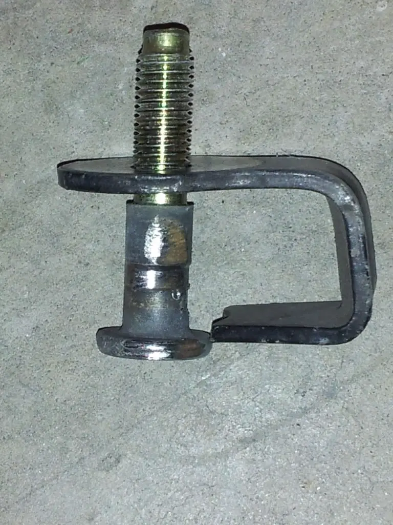

Here's the OLD striker, I've never seen one so bad it had grooves on both sides:

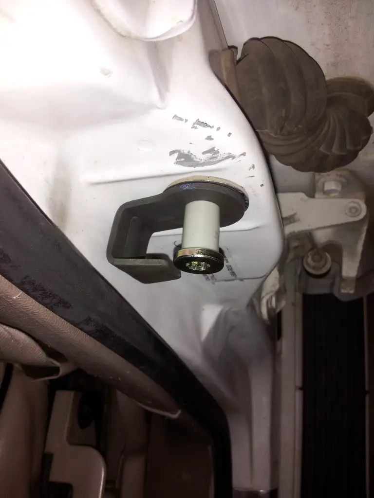

Ahh that's better:

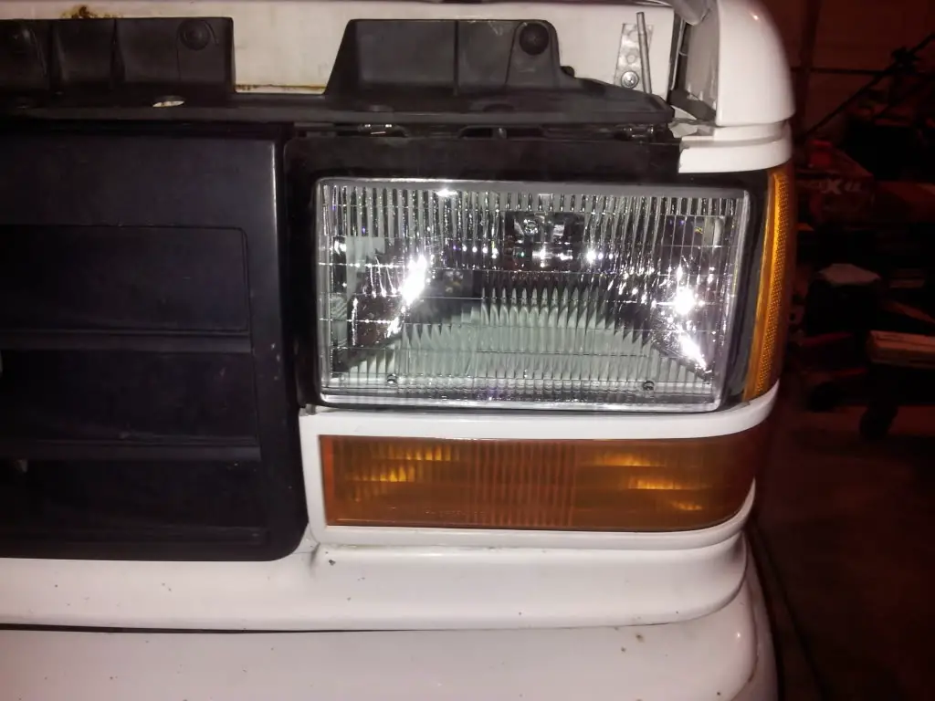

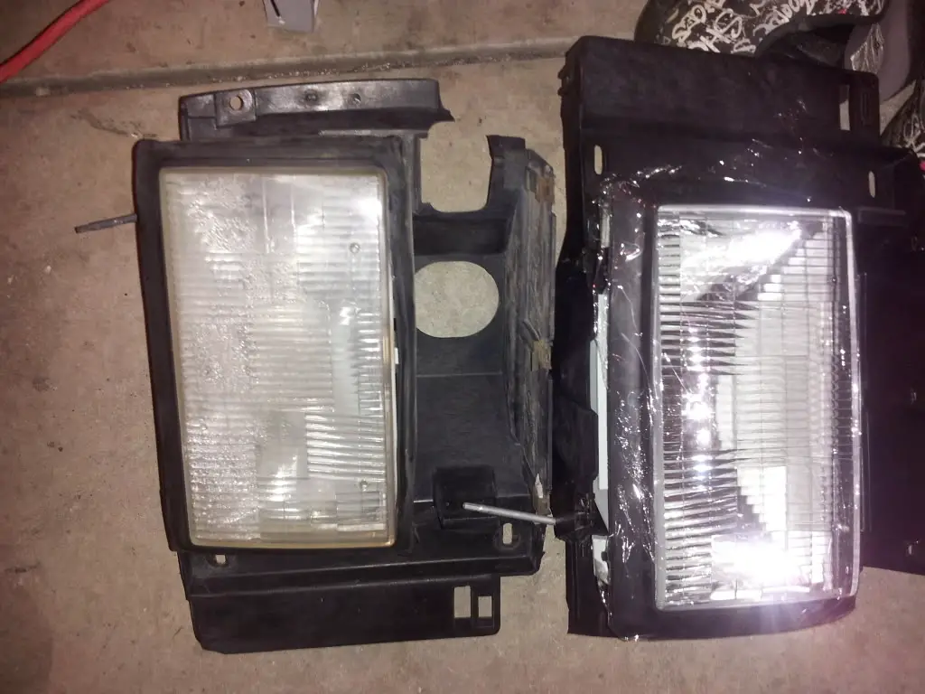

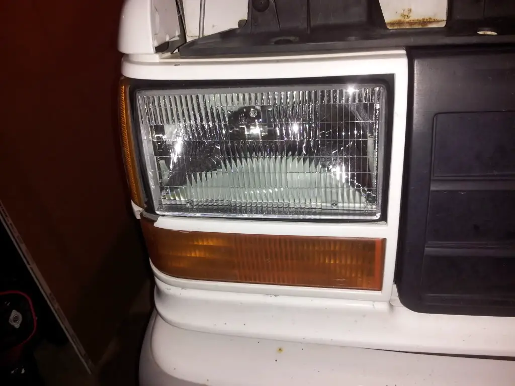

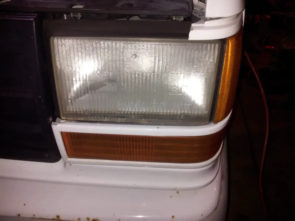

Next up was the headlights, here they are before:

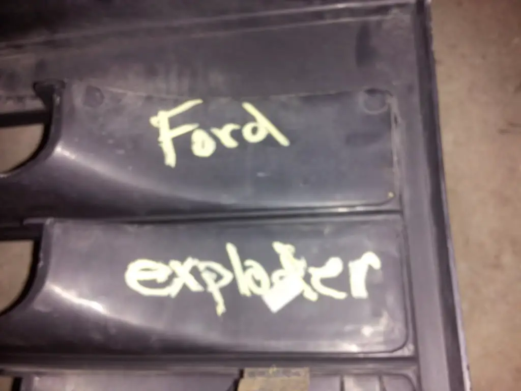

Noticed this when I took the grille off, thought it was kinda funny... This isn't the stock grille it's black and isn't the right one for a Limited but oh well, $700 can't complain:

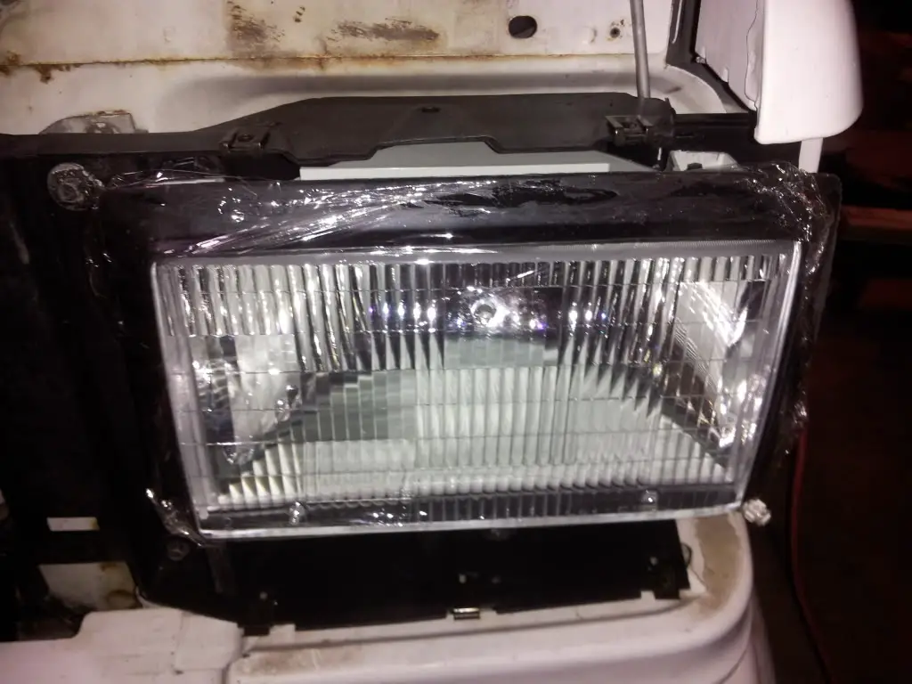

Comparison old vs new:
During, looks better already!
Done:
I need to get some new surrounds for the headlights, I haven't found white ones. So I'm probably going to order some black ones and either paint them and the grille white or just leave them black like the grille.

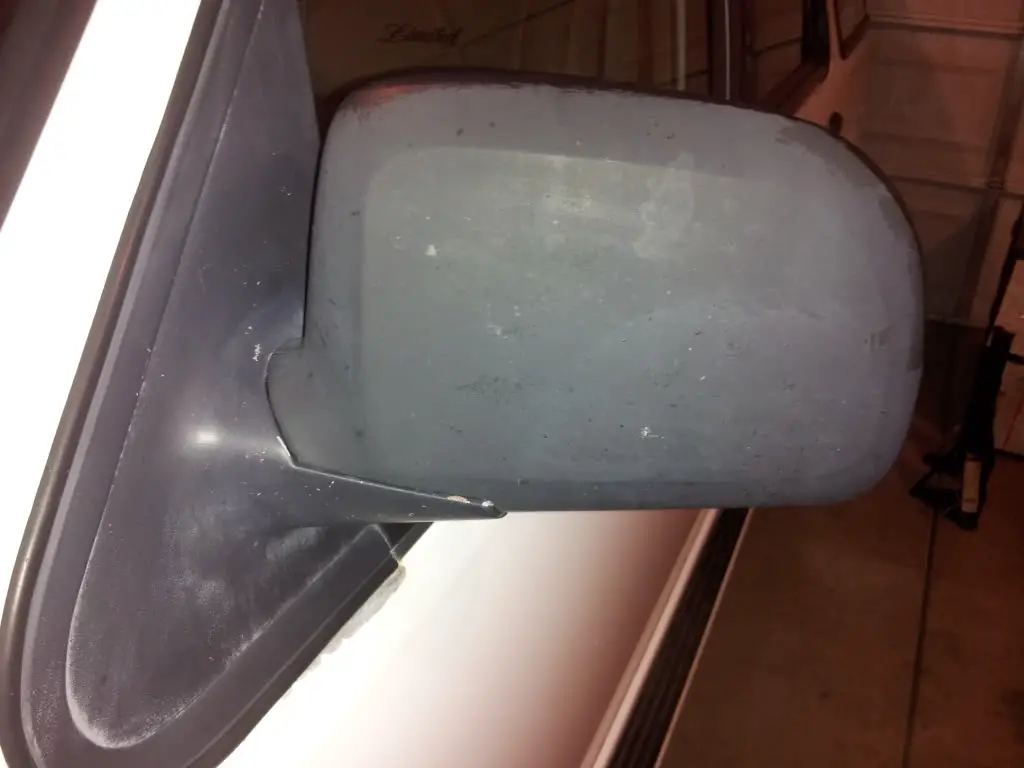

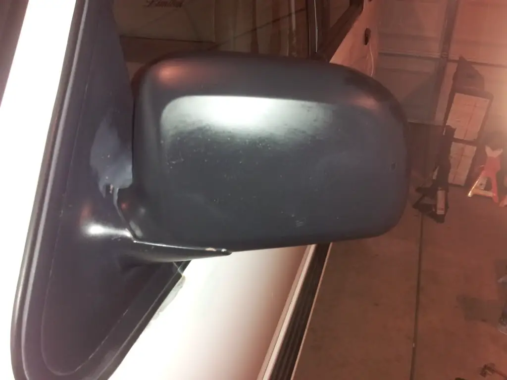

I didn't want to start the fuel sending unit so late so I tried some of my detailing stuff on the mirrors and some of the other plastic to make it look better, I did the door handles also.
Before:
After:
I didn't get pics of the handles sorry :(

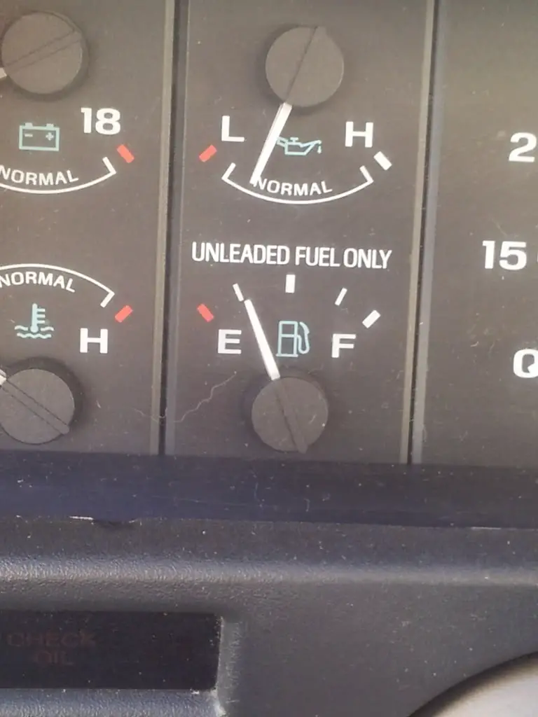

Just got the new fuel sending unit in and put in a new filter in while I was at it. I also replaced the passenger side door hinge, so it shuts like new again.
Fuel gauge works!

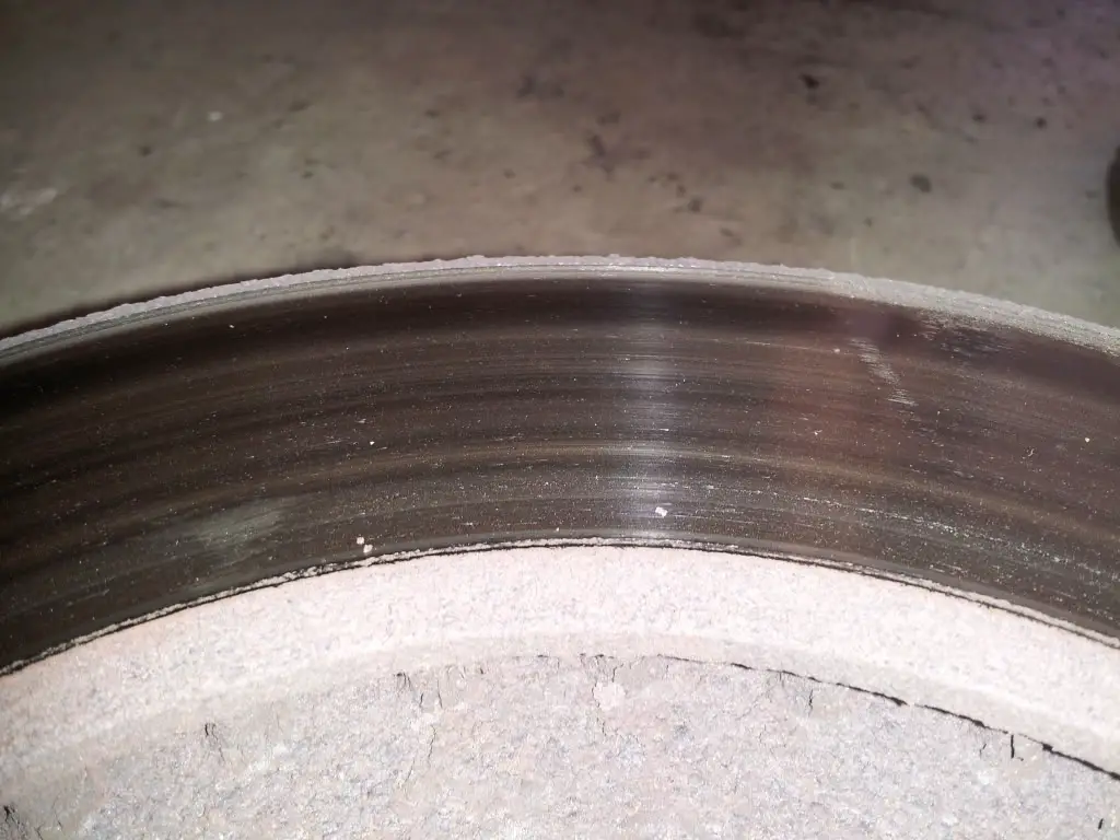

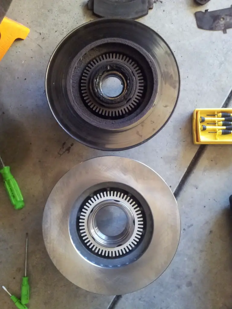

Here they are upon first inspection, you have to take apart the hub to get the rotor off.
It was really time for new rotors! These had a huge lip, and were starting to make some not so good sounds haha.
Here's a pic of the lip, if you can see it. It was a decent size lip on the outer edge, probably beyond being able to grind them down:
Here's the old next to the new:
And new one with the new ceramic pads all ready to go:

How did you get the door striker out. Is that a right or left handed thread? Did the "plastic" tube that covers the striker come with the new one? That's what I need. Both are missing from my Ranger.
Excellent pictures!!!!!!!!!!
Sorry I didn't notice this! :(
The door striker is regular threading, it's a 50 Torx bit. If you get a whole new striker ($6) they come with everything, the plastic, the bolt and the piece around it.
