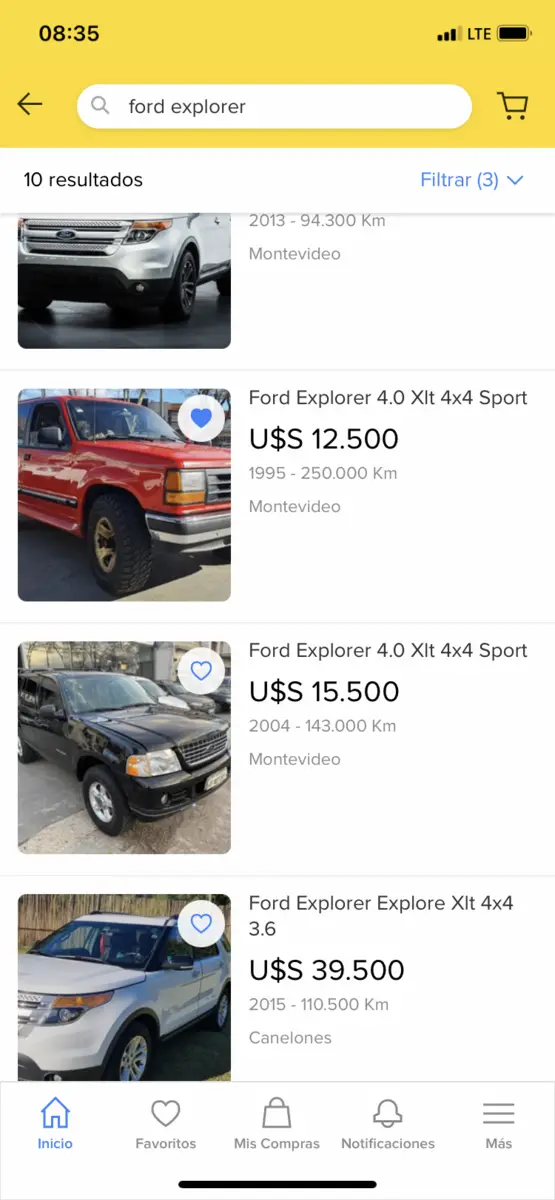

Further clarity request, is it 12,000 Uraguay pesos? or USD? Apparently same monetary symbol ($) is used.
US dollars

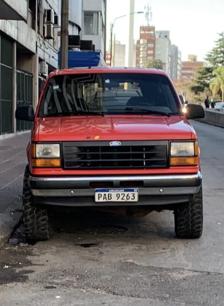

Wow, just wow. Is it that Explorers are rare/high demand in Uruguay (or in your city) or are trucks/cars very expensive generally?
Hi, they’re expensive. All of them, as motorcycles.
I’ve just closed the deal with the guy for U$S 9500.
Is an expensive country $&@?#% !!!!!!

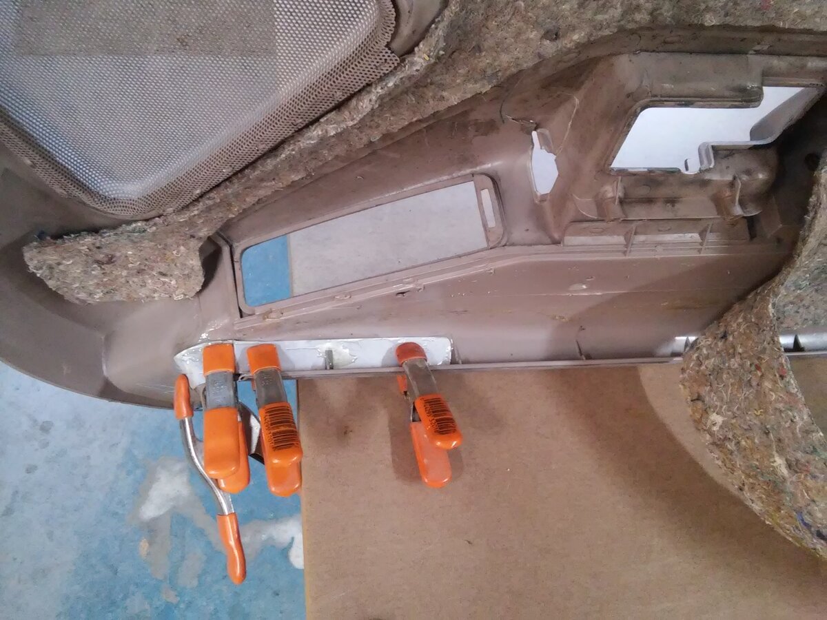

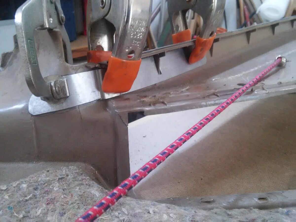

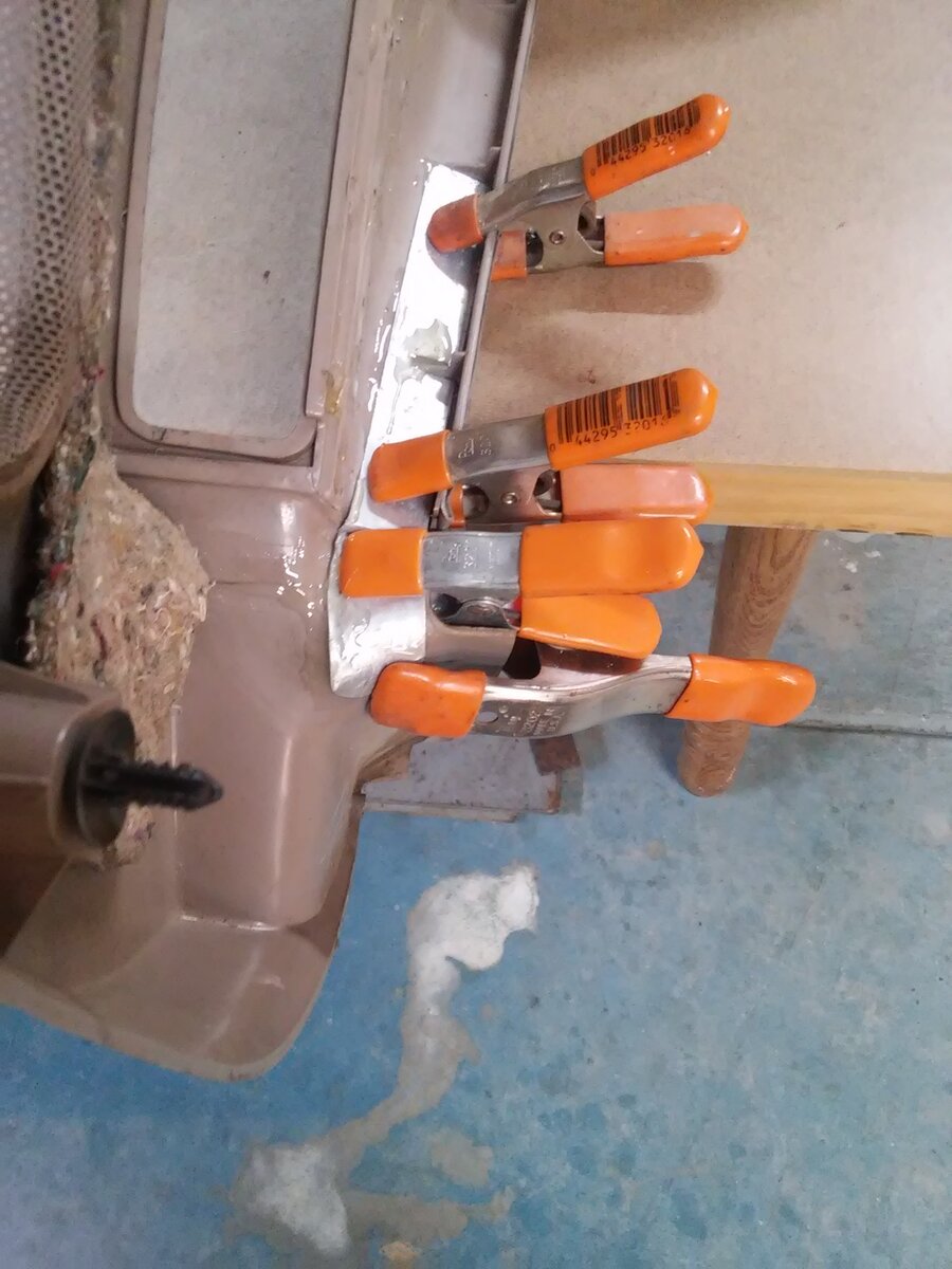

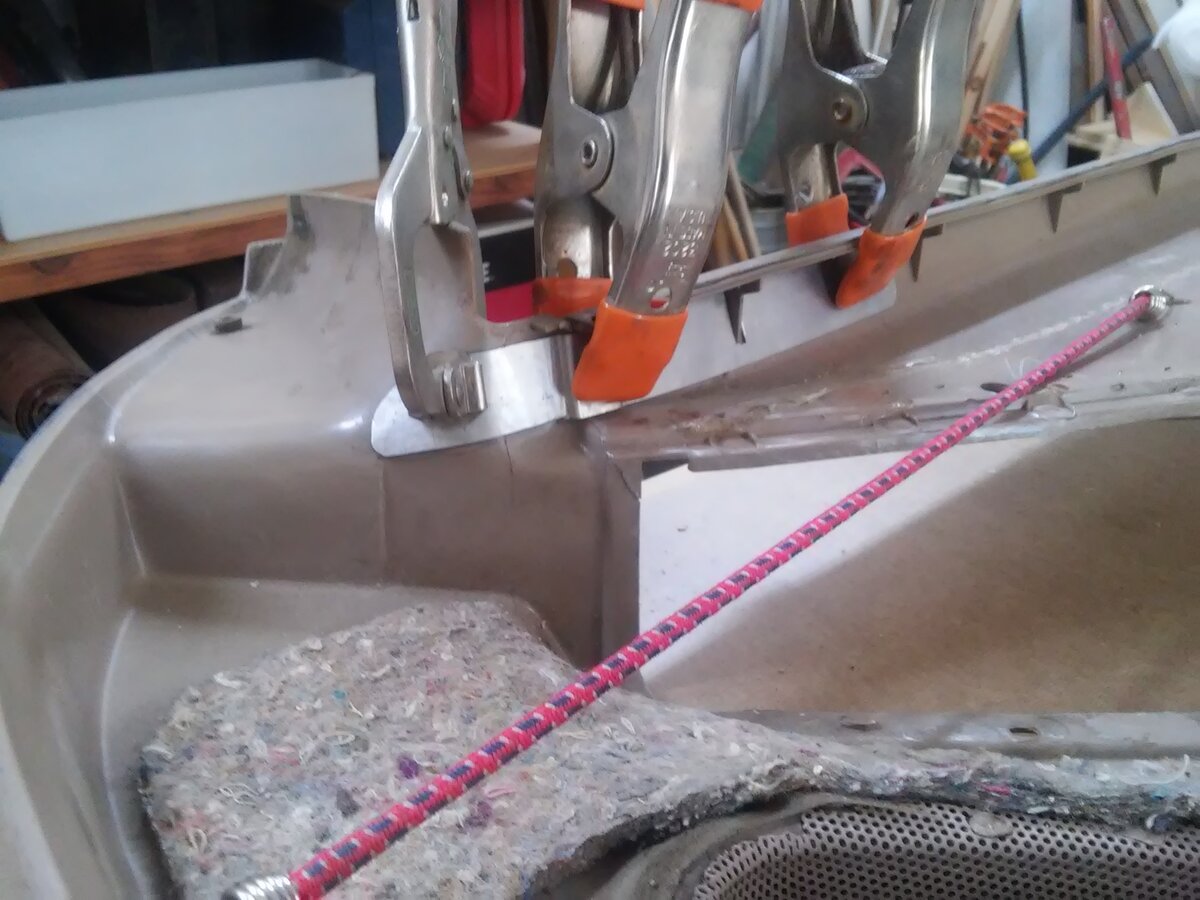

As for door panels you can use second generation. I did this in my 92. The wiring can be a pain, some of the diagrams I have didn't match my wires color codes. I went with trial & error til the door worked. 2nd gen panels here are easy to find here & are a good option. They fit with only wiring modifications for the switches.
On one of my 94's, I bought some new handles to fix the original panels.They weren't expensive, like $ 39 online. I want to say 1A auto, don't remember where I bought them. The quality is good but it takes patience to change just the handles. My panels were cracked and I made aluminum strips to epoxy over the cracks. Sanding down to clean material is important if you epoxy. I used slow setting. These panels were fixed probably 6 months ago and I still haven't installed them, I'm sure they'll work better than the originals when I put them in.
Getting your heater core re-connected will be an easy one for you, the part is not hard to find. Change fluids in your transmission, transfer case & axles. You'll see the vent connection & know what to do, very simple. As was said, learn how to seal the transmission to stop leaking. My Ranger has the 5 speed manual transmission, I went with Valvoline synthetic and it helped smooth it out but synthetic, for some reason leaks out easier. It's worth it.

Thanks X for your detailed explanation, very good tip on the aluminium strip. next wednesday, i'll have the truck and i'll be able to look on detail the doors pnels, and to build a "strategy" to recover them. Thanks!!!
