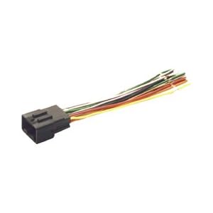

It's a good idea to get a new wire harness for this. They are like 5 bucks on amazon, and well worth the money.
Wire up the amp. The harness you got should have labels to tell you what color wire is each speaker/power. Match them up with the wires from the amp.
