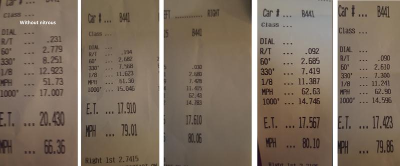

Up here at 5800 feet above sea level, cars run a lot slower. With only a KKM intake and Dynomax muffer my fastest run ever was 19.30 at 70 mph.
Here at the time slips
Quite a big drop in ET and good MPH gain. This kit was definatly worth it whether it's racing or just messing around on the streets.

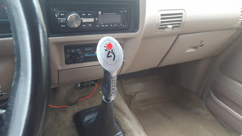

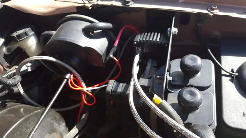

The setup:
10lb Bottle
Fuel and Nitrous lines
Solenoids
Engage Switch Off/On
Fire button

Woo those times are much slower up there..really nice gains from just a 50 shot tho..do you have a wideband a/f gauge? I ask because i wonder if your running overly rich when the nitrous is on because of the lack of oxygen. .might need to go down 1 number or 2 on the fuel jet..""might""
When are you spraying? Do you have a pressure gauge on the bottle also??
Your R/T are getting better ,what gears and tires do you have?

I'm spraying once i hit 3000 rpm. Don't have a a/f gauge or a pressure gauge on the bottle. Stock gears and Goodyear Wranglers Radials tires. Tires probably hurt my ET and MPH but gotta have them for the occasional snow storms
